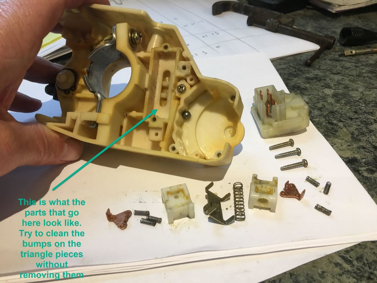

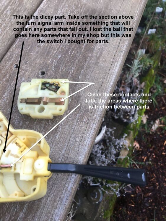

This side of the switch is where you are apt to lose parts. I would open it over a towel and maybe inside a shoebox to catch any parts that might
pop out when you open it - like the steel ball that I lost. Again, clean the exposed contacts, rough them up with sandpaper until they are shiny and lube any areas that are exposed to friction.
While you are at it, it's a good time to clean the horn ring on the steering wheel and add a thin film of dielectric grease as well as roughing up the contact for the horn on the combo switch.

Don't bother taking the wiper side (shown in first picture of part 2) apart.
