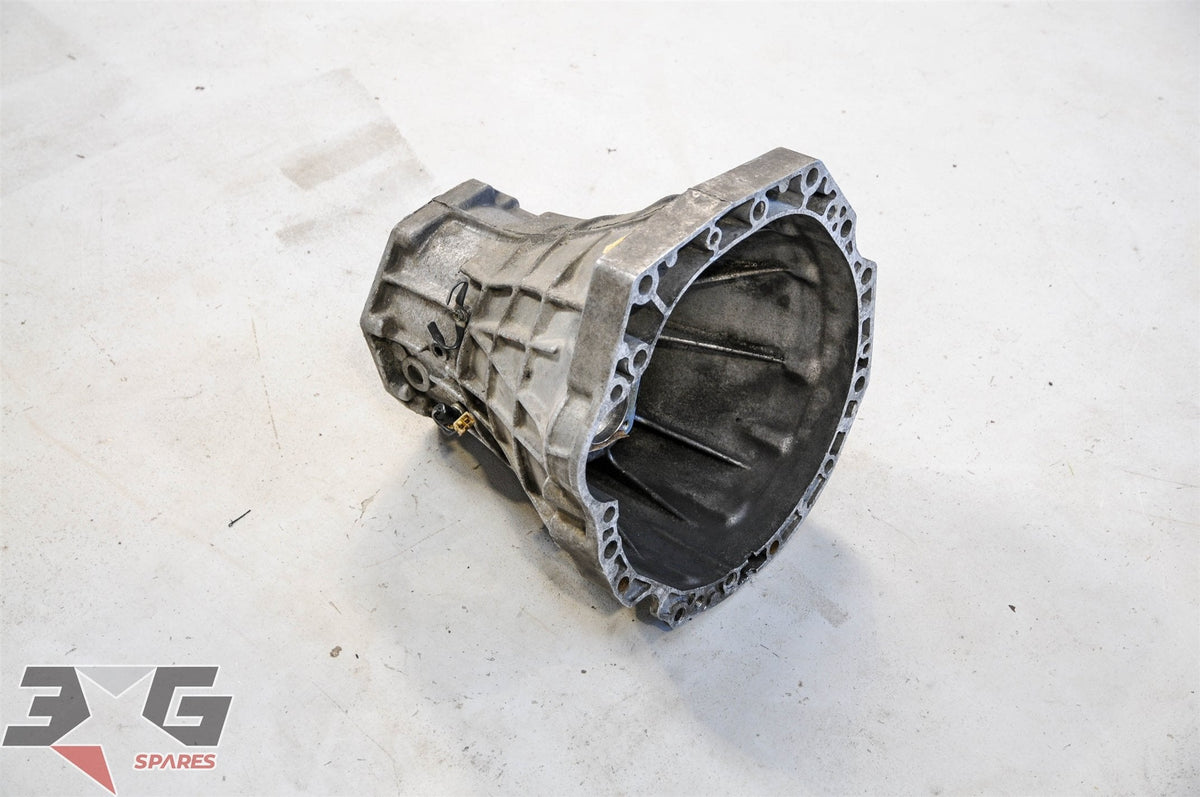

datsunfreak Posted March 30 Report Share Posted March 30 19 hours ago, skyblue said: So I’ve been slowly collecting parts. ECU, MAF, CAS, tranny etc. FWIW, if you can find an SR bellhousing (actually front half of case), you can reuse 90% of your KA transmission. That's what I did when I swapped my S13, and it worked just fine. Swapping it over was pretty simple, too. 1 Quote Link to comment
skyblue Posted March 30 Author Report Share Posted March 30 2 hours ago, datsunfreak said: FWIW, if you can find an SR bellhousing (actually front half of case), you can reuse 90% of your KA transmission. That's what I did when I swapped my S13, and it worked just fine. Swapping it over was pretty simple, too. Oh yea I did read that. I was able to find a SR tranny local to me so that was nice. Hopefully it’s in good shape. The KA tranny that was in the car was pretty toast and would grind going into 2nd if you didn’t baby it. 1 Quote Link to comment
