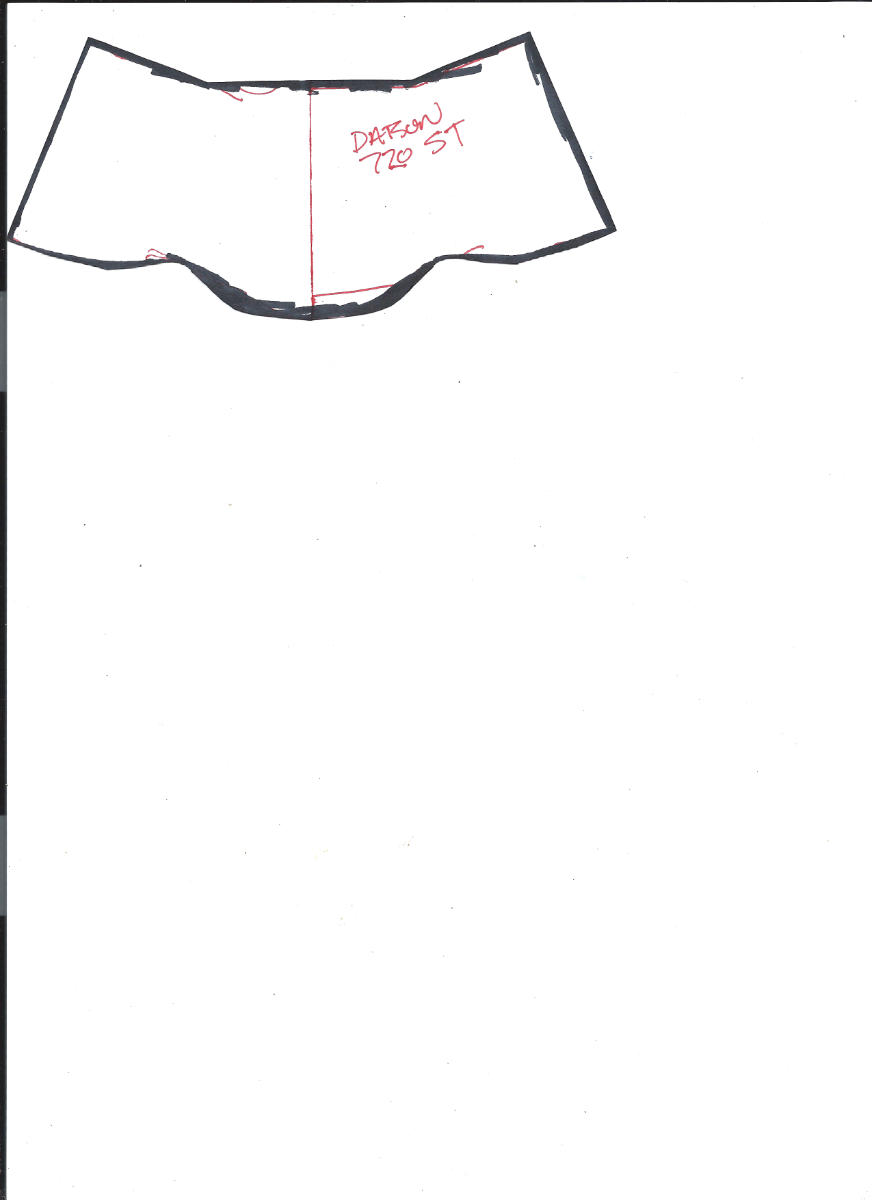

]2eDeYe Posted March 25 Report Posted March 25 Not sure how this will work out, but here are pdf patterns for my leather ST wheel cover. 720 ST Steering Wheel Cover dxf.pdf Quote

Draker Posted March 25 Author Report Posted March 25 1 hour ago, ]2eDeYe said: Not sure how this will work out, but here are pdf patterns for my leather ST wheel cover. 720 ST Steering Wheel Cover dxf.pdf thank you! 1 Quote

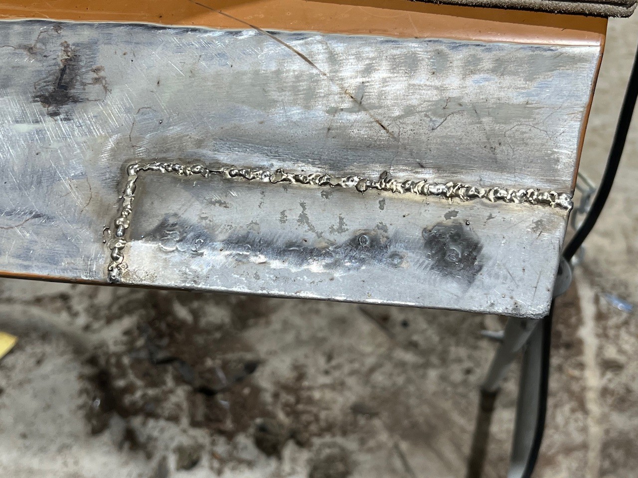

Draker Posted April 4 Author Report Posted April 4 chopped this out of spare door but it was rusted in the corner also. So I made a piece and grafted it in. 3 Quote
Rustbin Posted April 4 Report Posted April 4 10 hours ago, Draker said: chopped this out of spare door but it was rusted in the corner also. So I made a piece and grafted it in. Yes, that's the way to do it! When welding the door skin patch the corner is going to tuck inward, If you can cut it off an angle it will be easier to try to keep it flat, if you've been watching Fitzie you already know this. Love the progress. 2 Quote
Draker Posted April 7 Author Report Posted April 7 On 4/4/2026 at 9:24 AM, Rustbin said: Yes, that's the way to do it! When welding the door skin patch the corner is going to tuck inward, If you can cut it off an angle it will be easier to try to keep it flat, if you've been watching Fitzie you already know this. Love the progress. unfortunately my thread is a little behind actual progress so I already chopped the metal off square. But I’ll definitely remember this for next time, makes sense! 1 Quote
Draker Posted April 7 Author Report Posted April 7 (edited) Stitch welded the patch on. flap disk and it’s smooth. Got a little warpage, but they’re low spots. I’ll deal with this later. But the rust is gone from this corner. this is the other side. As mentioned cut square before I saw rustbins comment. Doh! I sealed in zero rust, and then (not yet pictured) seam sealed it. More zero rust. Edited April 7 by Draker 4 Quote
Rustbin Posted April 8 Report Posted April 8 21 hours ago, Draker said: this is the other side. As mentioned cut square before I saw rustbins comment. The way you've cut it is just as good, the ridge above reduces warping along the top and the convex shape should help along the side. It was the inside corner that you removed that would have sunk. Quote
Draker Posted April 13 Author Report Posted April 13 Got most of the metal work done. Got the patches welded in. Lower mirror holes welded up. Need to patch the upper mirror holes, then I’m back on pulling and smoothing dents. 5 Quote
Draker Posted May 11 Author Report Posted May 11 (edited) Did a lot of work to get it to this point. Used shrinking disk, worked really well. Patching the mirror holes warped the metal pretty bad, I was pretty diligent with the heat but the metal sunk big time. I cut a slit in the panel, release the stress, welded it back up. Lots more pulling and shaping, got it pretty darn close to straight. Filled needed, but there aren’t any seriously thick slots I don’t think. Time will tell 😂 fixed pinholes in filler with glazing putty. 3 coats of high build primer, shaped with 220 grit. Tapped down a few high spots, more glaze, 3 more coats of high build. Finish sanded 320, wet sanded 400 and 500 grit. Now comes the tricky part, I have to blend the original paint line and primer to the point I can shoot color, and blend it without covering the surface rust at the top. Lot more finish sanding to come. Hoping to shoot color soon and be done with this damn door!! Edited May 11 by Draker 2 Quote
