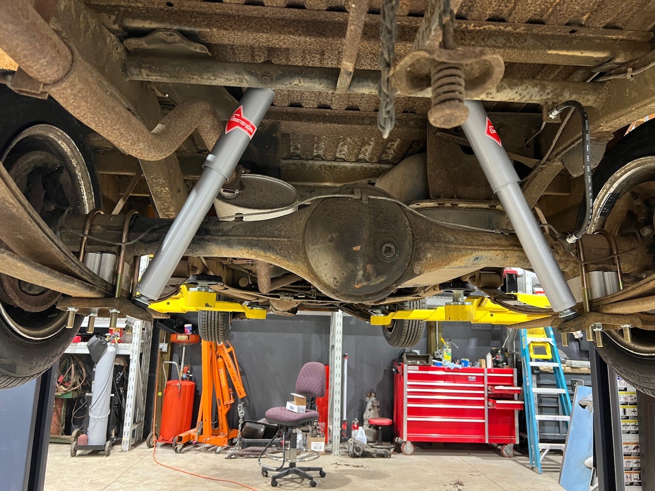

Draker Posted March 12 Author Report Share Posted March 12 New shocks front and rear. New swaybar end links. oddly enough these raised the back end about and inch due to the rebound force. So i removed the 2” blocks and replaced with 2.5” blocks. 3 Quote Link to comment

banzai510(hainz) Posted March 14 Report Share Posted March 14 On 3/11/2026 at 9:33 PM, Draker said: these raised the back end about and inch due to the rebound force. Yes Gas a Just do that(or the new MONOMAX KYBs. Dont cut that strap untill you got the bushing on and aim and shoot. I put the gas a just on front of my 521 to keep it from bottoming out since I lowered it down. Put cheap regular shocks in back Gabrials I think. 1 Quote Link to comment
