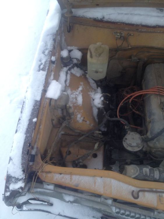

I've been kicking around the idea of a 620 build for a while now. It had to be a 79 king cab, deluxe is a plus. We'll I found one locally and been going back and forth if I should buy it. It's pretty rust free, other than a small spot in the door. It's got a few dents and dings, but otherwise pretty straight. Pics..
  • Like 4
My plan is to just get it running and clean it up. Lower it a bit and new wheels.
The devil is in the details however. The engine is seized up (L18 with a87 head). I pulled the spark plugs and it looks like the head gasket blew, filled #3 with coolant and it rusted up pretty good. I use my bore scope and the rust is pretty bad. Probably going to need a complete rebuild of the lower end. Since I'm still plugging away at the 1200, this project will likely take a bit to get to. Maybe this winter? I'll probably pull the motor in the next few months. I figured, might as well buy it since it was available.
The interior is a mess, but the floor pans are clean!! There have been some rodents living in the cab, so it smells lovely. I'll collect parts as the become available and get this thing on the road!
