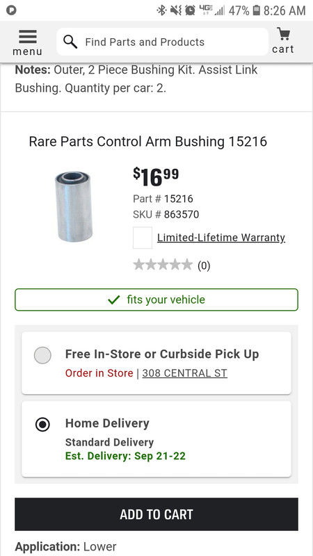

Crashtd420 Posted September 14, 2020 Report Posted September 14, 2020 16 hours ago, Zonargx said: Does anyone know how I can get all the bushings for a 1971 521 I need all the bushings even the leaf spring bushing. When I did the front disk conversion I was gonna replace them but the local auto parts seem to not have any information on them. So basically what I need is just the upper spindle and lower bushings and leaf spring bushings. I Mikeklotz (bluehands.com) is making them again get his upper spindle bushing.... better design.... What lower bushing are you trying to find? The one pressed into the frame? I think I have the package for the rear leaf spring bushings in my garage... i can look for that later..... From autozone... Upper One in the frame Quote

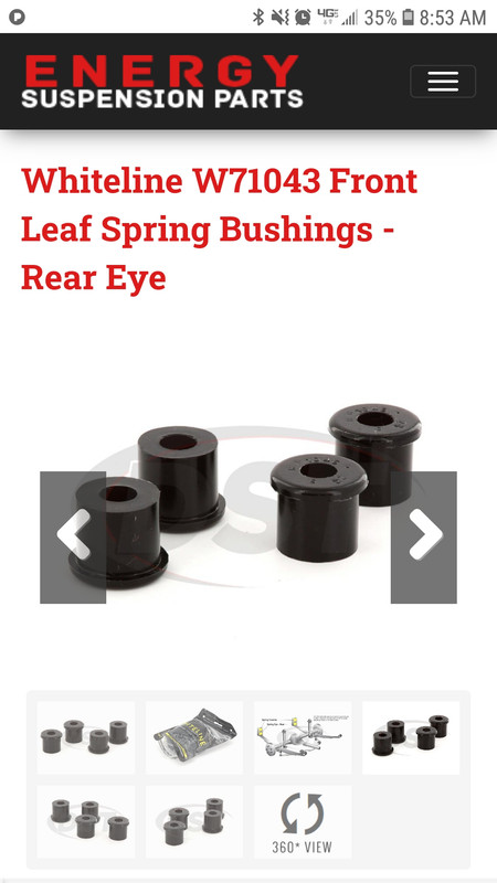

Crashtd420 Posted September 14, 2020 Report Posted September 14, 2020 I think these are the leaf spring bushings... They are listed for the 720, I know people swap the leafs onto the 521s so I think these are the ones but again I'd like to confirm it with the packaging in my garage ... Quote

Crashtd420 Posted September 16, 2020 Report Posted September 16, 2020 On 9/14/2020 at 8:57 AM, Crashtd420 said: I think these are the leaf spring bushings... They are listed for the 720, I know people swap the leafs onto the 521s so I think these are the ones but again I'd like to confirm it with the packaging in my garage ... I couldnt find the package in the garage or part number I used to verify this.... I'm gonna check my pictures and see if I have something there... 1 Quote

Charlie69 Posted September 17, 2020 Report Posted September 17, 2020 The shackle bolt diameter is larger on the 521 than the 720. Gene Knight was having a local spring shop custom make them for his 521. The rear spring shackles on a 521 are different from any other Datsun/Nissan trucks. 1 Quote
Crashtd420 Posted September 17, 2020 Report Posted September 17, 2020 9 hours ago, Charlie69 said: The shackle bolt diameter is larger on the 521 than the 720. Gene Knight was having a local spring shop custom make them for his 521. The rear spring shackles on a 521 are different from any other Datsun/Nissan trucks. Really makes me wonder what I used ... I have an extra shackle and bolt for the leaf springs I'll do some measurements and maybe try to see if I can find the part number i used in my notes... i dont remember having issues with things fitting... This is why I said to verify, been a while since I installed mine.... 1 Quote
Charlie69 Posted September 17, 2020 Report Posted September 17, 2020 The 521 leaf spring bushings used to be on eBay all the time. Now they show up once in a while. If I remember cxorrectly the 521 takes long and short bushings. 521 leaf spring bushings 1 Quote

Zonargx Posted September 19, 2020 Author Report Posted September 19, 2020 Ok so the two small one are for upper Ans the long one is for lower. So for the leaf springs they change based off what type of shackles I have ? 1 Quote
