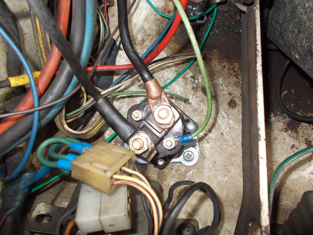

banzai510(hainz) Posted August 5, 2020 Author Report Share Posted August 5, 2020 OK Wayno cant open the photo in PM try here. so maybe this is the same what I am going to post. Im trying to figure out where you use the big busslink to short out the 2 battery lugs. I think you just want something like this will get where you need to be and not cause the spinning of the gear???? so on the photo here , the right side you would but your battery cable which would then go to the Ford selionoid Quote Link to comment
wayno Posted August 5, 2020 Report Share Posted August 5, 2020 OK, Hainz is asking how I did what I did to that starter and had it work in my photo, so here is what I did. So what I did was run one large cable to the starter with the buss/jumper to the relay in the photo above, the green wire goes to the key, and the other large cable goes to the battery, the alternator charge wire went straight to the positive post on the battery as it was an internally regulated alternator as you can see the jumper wires in that photo also . Right now I bought a used starter from a guy in Brooks OR(relocated Canby meet), that is in my truck now so most of this was removed. Quote Link to comment

banzai510(hainz) Posted August 5, 2020 Author Report Share Posted August 5, 2020 (edited) Wayno I think I got it but still cant open photo Im thinking you could have moved the bat cable to the right lug(Not use the Thick flat short buss) . would be the same???? Ok I go to think this one out its really simple ai just go to picture differently Edited August 5, 2020 by banzai510(hainz) Quote Link to comment
wayno Posted August 5, 2020 Report Share Posted August 5, 2020 OK I will try the photo one more time using the in-house system, can you see this photo? Quote Link to comment
banzai510(hainz) Posted August 5, 2020 Author Report Share Posted August 5, 2020 (edited) OK I see it. So the green wire is from the key switch that went to the stock selinoid tab on the starter? mine is the usually blk /yell wire Im thinking you still need the stock selinoid on the starter even if you use the remote selinoid set up as you have. Im only half way guessing is that the selinoid is designed to get thrown out to hit the pinion gear then make contack to start the motor. only then start turning. More or less the original vehicle( being a British Car parts site) is using what we have been doing for year is adding a Hotstart relay in the mix as I don't see a wire on the stock selinoid tab , Can I assume the motor is turning way before it hit the flywheel causeing the gears to get worn???? I was reading the add for this and was getting confused on the remove selionoid set up and figure I ask you as you said you have something like this. Im still looking at your set up but think now maybe going back the orginal Datsun set up and just use the Ford relay to give you the 12volts to the starter tab will do it . But if it works just leave it along what drawing below is the common Hot start but work with the ford if you know the connections which is ez to figure out but only need like a 20 ga wire to send to the start TAB 87 and 30 would be the BIG lugs on FORD relay 30 I hook up at the starter lug(battery side) 86 would be the orginal stater wire from key 85 is ground or the Case on the Ford relay Edited August 5, 2020 by banzai510(hainz) Quote Link to comment
wayno Posted August 5, 2020 Report Share Posted August 5, 2020 I have done that to more than one starter, but the other starters had a small wire going from the buss/jumper to the post on the solenoid where the Black/Yellow wire normally goes, that starter didn't need that small wire. For some reason that starter in the photo engaged the flywheel without grinding most the time, I went thru a lot of starters at that time and was trying anything to have something work that was dependable, used starters out of wrecking yards worked the best/longest for me, but I have not bought a new starter in several years now, I buy them used at Datsun swap meets/shows. Quote Link to comment
