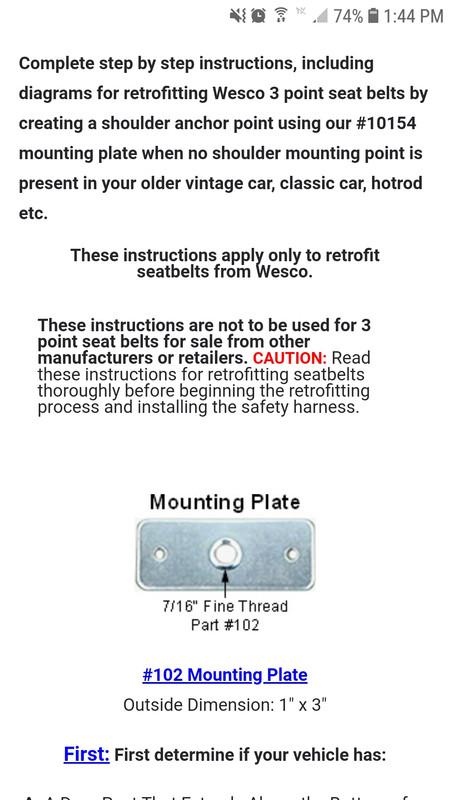

Crashtd420 Posted August 1, 2020 Report Share Posted August 1, 2020 (edited) You may have the mounting point .... I believe others have said it's high up in the b pillar.... I dont know If its covered or not..... If it's not there you can add one of these plates.... https://www.wescoperformance.com/retrofit-seat-belts-shoulder-mt-door.html Edited August 1, 2020 by Crashtd420 Quote Link to comment
Payco Posted August 1, 2020 Author Report Share Posted August 1, 2020 Thanks for that.. Quote Link to comment
