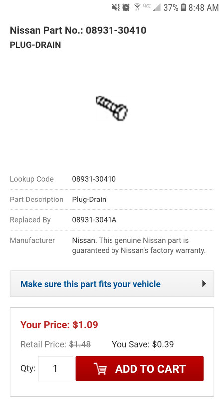

I fill the radiator up with water for the break in and it starts pouring out of the side of the block...after a mild heart attack I realized the coolant plug was missing from the block. It was in when I took it to be boiled out and just overlooked making sure it was there when I got the block back.
Long story long...what do I need to put in there, I can't find the proper plug on line dang it!

I assume this is for a 521? L series?
Well the 521 L16 has different part numbers for it's core plugs than all other L16/L18/L20Bs.
Its 11023-58000  or 00933-14000 and fit the 521 L16
All other L16s like in the 510 and the early 620 and all other L18 and L20Bs are 11021-21000.
