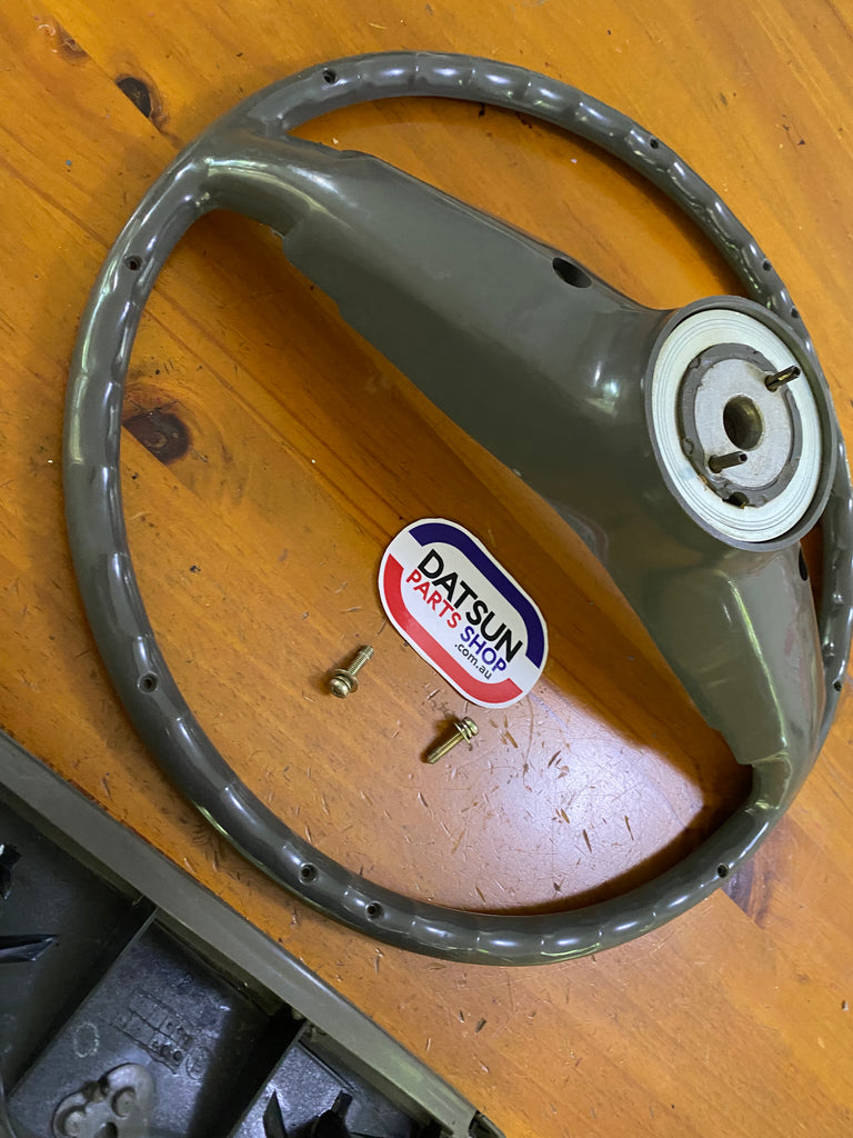

Signal cancelling is done at the turn signal. If one side not working look there, something is broken. If the steering column is not exactly centered, (very doubtful) then the signal might cancel sooner on one side than the other when turn is finished and steering wheel centered is all. Take the clam shell and steering wheel off and watch the mechanism and how it works on the good side and compare to the opposite.
If steering wheel is not centered with wheels straight ahead, remove steering wheel and center it on the splines on the column.

The indicator / turn signal stalk doesn't self cancel when straightening up after a left turn. It does after a right turn or if going from a left signalled turn to a normal right turn. Given this is operated off the steering column and is not adjustable by itself, it would suggest that the steering column isn't in the centred position
That is not how this should work. There should be two pins in the back side of the steering wheel. These are what kick the turn signal off after you turn. If the wheel is crooked one way, it's very likely that one way will cancel and one way won't.
You can do this, but I would suggest taking the wheel off and checking those pins I mentioned, and/or seeing if the (often brittle) plastic arm on the switch that interacts with those pins is broken.
