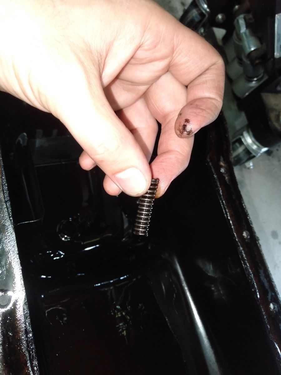

Lachlan Posted January 12, 2025 Author Report Share Posted January 12, 2025 Oil leaks have plagued me for some time. I put off tearing into the oil pan gasket because I didn't want the car off the road for that long. I also was unsure what to 'fix-while-I'm-in-there'. After some reading, it seemed that now was the best time to also do the timing cover gasket and front crankshaft seal. After finding the sludge in the cooling system and reading about removing the water pump to really flush things out, that sealed it. This has now turned into a bigger job. Thanks to many previous posts, I was well informed that it was going to be a challenge getting the oil pan off with the engine in the car. Give the choice between lowering the crossmember or loosening the oil pickup bolts, I chose the former. Given my recent success refreshing the steering system, I knew I could suspend the engine from above and remove the supporting structure underneath for greater access. Here's my totally safe and shadetree approved setup. Don't worry, it'll be fiiiiiiiiiiiiiiine. Once the engine was supported, the engine mounts were released and the engine lifted from below with the trolley jack. The straps up top were providing additional support so the strain wasn't all on the bellhousing and transmission shaft. I unbolted the crossmember and it gave a bit more clearance to get the oil pan past the oil pickup. BIG TIP: With the pan free from the block, try rotating it 90 degrees instead of going straight forward. I found this worked for me in getting out without even touching the oil pickup. I unbolted the sway bar but you don't need to do this at all. Here's the bottom end of the A12. Cool little thing. Never seen the bottom end of an engine before. I found this spring in the oil pan. Anyone know what it might be from? I can't see anything missing anywhere. Here's how things are looking right now. The timing cover is really stuck on. I'll have to keep massaging it to get it off. I've resisted prying as I don't want to damage the gasket surface and create leaks. Here's a quick story that I forgot in the valve seal post. The spring compressor has a c-clip keeping the spring plate bracket from falling off. Somehow it came loose and fell onto the head after I released a spring. I watched it bounce down into an oily hole and stick to a pushrod. Blood pressure immediately rising. I rapidly turned off the music, ripped off my gloves and frantically grabbed a pick. Carefully, slowly, pick up the c-clip ... NO! ... dropped it right down the hole. I nearly died right then. My wife heard me assessing my life choices with imaginative language and came to watch / help. After I'd explained the cause of my malady, she casually suggests using a magnet to fish it out. "I don't have one ... wait ... aren't my screwdrivers magnetic?" Had it in my hand within 10 seconds after a single dip into the abyss. She is worth her weight in gold. 1 Quote Link to comment

datzenmike Posted January 12, 2025 Report Share Posted January 12, 2025 My guess is this is from the timing chain tensioner. It's a teflon or nylon coated plunger with internal spring that bears on the slack side of the timing chain to help keep it taut. If the timing cover was off you would see it. Someone had the chain off or worked on it and lost it down the front and it ended up in the pan. If you buy a timing chain kit it should be included with it or look for one that does. I suppose it may have been replaced and that's the original and no harm done. 2 1 Quote Link to comment
KELMO Posted January 12, 2025 Report Share Posted January 12, 2025 I have taken apart several "A" motors and agree with Mike's aguessment. 1 1 Quote Link to comment
RyanC Posted January 12, 2025 Report Share Posted January 12, 2025 (edited) Yep I would say timing tensioner spring as per the others. Def worth running a coolant flush through her by the looks mine wasn't that bad. Beware, where you drop it will kill any grass etc ask me how I know thankfully not a big deal for me. Also I think it needs another after pulling my manifolds again still some sign of gunk but figure once running reguarly it will help clean it. Use the best coolant you can find. Edited January 12, 2025 by RyanC 1 Quote Link to comment

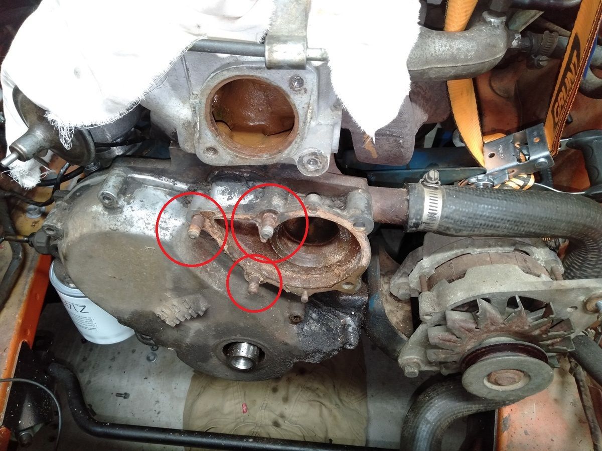

datsunfreak Posted January 13, 2025 Report Share Posted January 13, 2025 On 1/12/2025 at 5:45 AM, Lachlan said: Here's how things are looking right now. The timing cover is really stuck on. I'll have to keep massaging it to get it off. I've resisted prying as I don't want to damage the gasket surface and create leaks. IIRS, these go all the way through the cover and into the block. The rust build-up you see around them is probably keeping the cover on. I usually removed these and replace them with bolts. 1 Quote Link to comment
Dguy210 Posted January 14, 2025 Report Share Posted January 14, 2025 (edited) 15 hours ago, datsunfreak said: IIRS, these go all the way through the cover and into the block. The rust build-up you see around them is probably keeping the cover on. I usually removed these and replace them with bolts. Always put some anti-seize on these bolts as a favor for the next guy too...which is often yourself. Been enough times that I had to fix that poor bastards problems it is a rare treat when he thought ahead 😂. Edited January 14, 2025 by Dguy210 1 Quote Link to comment
Lachlan Posted February 22, 2025 Author Report Share Posted February 22, 2025 On 1/13/2025 at 12:52 AM, datzenmike said: My guess is this is from the timing chain tensioner. I'd say you're spot on. When the timing cover was off, I could confirm that the tensioner was doing its job of taking the slack out of the chain, so this errant spring must have been the original. On 1/13/2025 at 9:25 AM, RyanC said: Def worth running a coolant flush through her by the looks mine wasn't that bad. ... Use the best coolant you can find. Great tip. I watched a ChrisFix video on flushing your cooling system and followed most of the steps. I did have the thermostat installed because I'd put in all the effort of flattening gasket surfaces, sealing half the gasket and greasing the other that I didn't want to remove it again and have it tear. The amount of shmutz that came out was horrid. I did a Tectaloy (local brand) radiator flush followed by at least five demineralised water 'fill - run - drain' flushes. Some included a drive, some included draining the block and the last ones included both. I got to the point where what was coming out was just dirty water with less of the heavier mud component, so I called it good after the fifth. On 1/14/2025 at 12:44 AM, datsunfreak said: IIRS, these go all the way through the cover and into the block. The rust build-up you see around them is probably keeping the cover on. I usually removed these and replace them with bolts. On 1/14/2025 at 3:47 PM, Dguy210 said: Always put some anti-seize on these bolts as a favor for the next guy too...which is often yourself. Been enough times that I had to fix that poor bastards problems it is a rare treat when he thought ahead 😂. Yeah, and also the little nubs poking out to locate the timing cover / water pump as you send it home. Both had rusted the cover / water pump in position. I gave everything a really good clean and mild polish before reassembly. I didn't go the whole hog and remove the studs and replace with bolts. I can't remember if I applied copper grease or if I just cleaned everything really well. Yeah, you're right - that other guy is usually me going back to fix my earlier work! 1 Quote Link to comment
