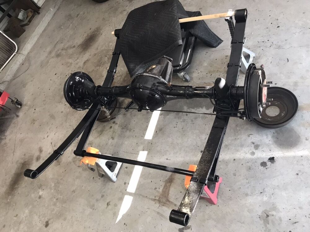

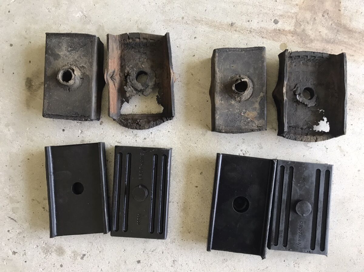

Greaser2 Posted October 2, 2020 Author Report Share Posted October 2, 2020 Finally got new leaf spring pads in, late 60’s chevy pads, just need a little trimming. Originals were shot. 1 Quote Link to comment
Greaser2 Posted October 2, 2020 Author Report Share Posted October 2, 2020 Except for shackle bushing, got everything ready to go back on. I always go crazy with the POR15. 1 Quote Link to comment
