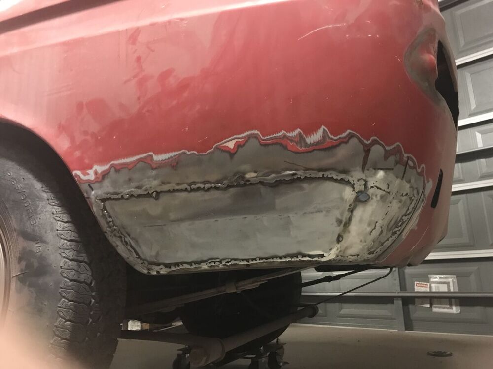

Greaser2 Posted August 23, 2020 Author Report Share Posted August 23, 2020 Cut out the rust on driver side rear quarter this Sat. Welding went from bad to beginner. 3 Quote Link to comment
MikeRL411 Posted August 24, 2020 Report Share Posted August 24, 2020 21 hours ago, Greaser2 said: Cut out the rust on driver side rear quarter this Sat. Welding went from bad to beginner. Now paint the interior pocket with lots of primer and inject light weight foam. Just before the foam finishes expanding compress the top surface flat and it will look like the factory cardboard filler strip. It will also be paintable. Quote Link to comment
Greaser2 Posted August 24, 2020 Author Report Share Posted August 24, 2020 Awesome idea. Quote Link to comment
MikeRL411 Posted August 24, 2020 Report Share Posted August 24, 2020 2 hours ago, Greaser2 said: Awesome idea. No moisture, no oxygen, no rust. Quote Link to comment

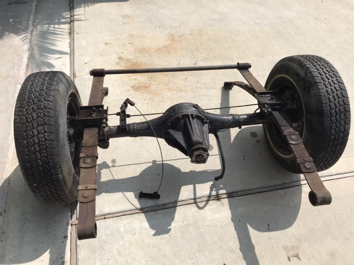

Greaser2 Posted September 19, 2020 Author Report Share Posted September 19, 2020 Taking a break from body work so pulled out rear end. Quote Link to comment
MikeRL411 Posted September 20, 2020 Report Share Posted September 20, 2020 16 hours ago, Greaser2 said: Taking a break from body work so pulled out rear end. See those pockets on the spring leaves? If you know of a source for the greasable inserts let me know. Quote Link to comment
Greaser2 Posted September 20, 2020 Author Report Share Posted September 20, 2020 (edited) Yea, I saw the rubber, not in great shape and I have never seen a mention of a replacement. Edited September 20, 2020 by Greaser2 Quote Link to comment
MikeRL411 Posted September 20, 2020 Report Share Posted September 20, 2020 30 minutes ago, Greaser2 said: Yea, I saw the rubber, not in great shape and I have never seen a mention of a replacement. I would put circles of poly "fabric" with a ton of body lube as a last resort, kitchen pot scrubbers for example. Just pumping grease into the space between leaves is OK but does not have any retention. Loaded Teflon would just cause wear on the steel. Plain Teflon would wear out too soon. As long as we don't carry 600 pounds in the back seat should be OK. Quote Link to comment
Greaser2 Posted September 20, 2020 Author Report Share Posted September 20, 2020 What about the leaf spring front bushings, options? also the axel shims where the axels bolt to rear housing? Two on one side are good, 1 on other side is not great. Quote Link to comment
ppeters914 Posted September 21, 2020 Report Share Posted September 21, 2020 8 hours ago, MikeRL411 said: See those pockets on the spring leaves? If you know of a source for the greasable inserts let me know. Have you checked to see if the roadster ones will work? https://www.datsunparts.com/1992 Quote Link to comment
MikeRL411 Posted September 21, 2020 Report Share Posted September 21, 2020 14 hours ago, ppeters914 said: Have you checked to see if the roadster ones will work? https://www.datsunparts.com/1992 Part number 2143R looks like it should work ! Quote Link to comment

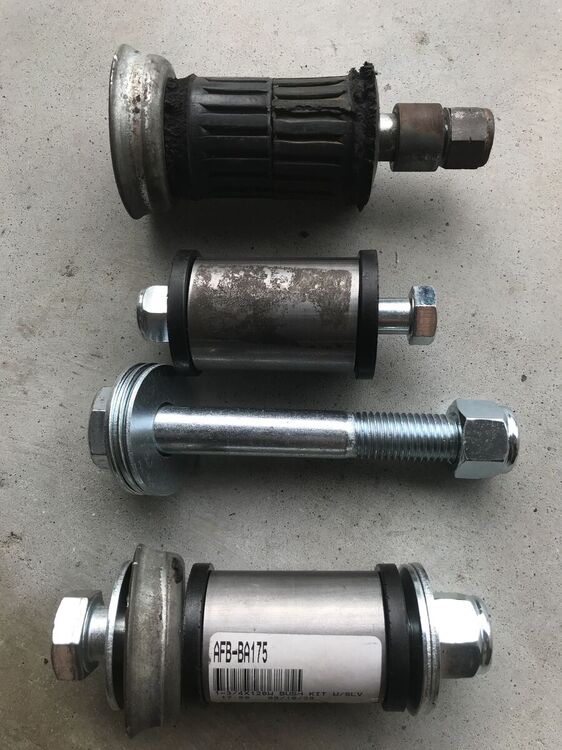

Greaser2 Posted September 28, 2020 Author Report Share Posted September 28, 2020 Should have a solution for the front leaf spring bushing. Top is the factory bush, not horrible but.. Second Kartek bush part AFB-BA175. Third is extras needed, a 3/4 bolt 5.5”, 3 washers, and a locking nut per side. You could also use a 9/16 bolt with the inner bushing sleeve but ACE’s selection on 9/16 bolts was limited. Bottom is new setup, because I went with 3/4 bolt u will need to open up the factory perch mounts holes a hair. 1 Quote Link to comment
difrangia Posted September 29, 2020 Report Share Posted September 29, 2020 The bolts in the pic above look to me like Grade 5 bolts. Markings on bolt head would show. I'm judging by the Cadmium looking finish. I've always heard that it's not a good idea to use any fasteners below Grade 8 on steering, suspension, and other critical applications. There're all kind of articles and forum discussions to search on internet on this subject. Here's an example: https://www.hemmings.com/stories/2013/11/22/tech-101-identifying-and-replacing-automotive-hardware Another consideration that I always address on really critical applications is machined versus rolled threads. I visited in on a lengthly thread on one of the car forums a couple years ago about this aspect of fasteners. Machined threads can leave stress risers in the finished product that can provide the start of a cracking type failure. Sure don't want that in any steering components. Quote Link to comment
