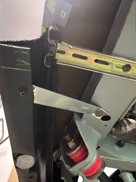

Getting at it some more. Hadn't accounted for the thickness of the sound deadener + carpet incl underlay, so had to re-fit the rear panel. Corners will need to be re-fit as well, probably the kicks too.
The 720 floor pan is definately flatter. Got some humps that carpet don't fit over very well, but at least those are under the seats so no biggie. Trans tunnel a bit oversized too.

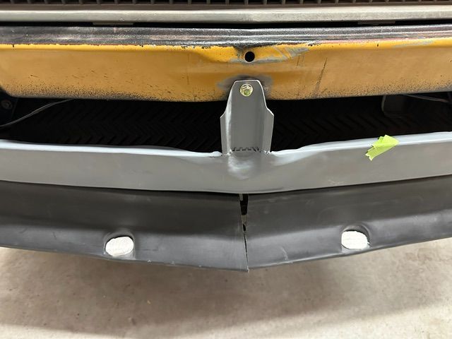

Some of the work is on hold while I wait to resupply the waterproof connectors I need, so I'm wasting time working on the front spoiler.

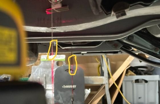

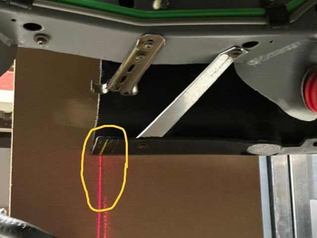

I had already recurved the R side end and had mounted it up while I worked on the L half. I thought "hey why not use a laser and mark up the exact center from behind?" which I proceeded to set up. With the project sitting on jack stands it really doesn't give me much room to work on things underneath, so a few choice curses were thrown at my creeper, trouble light, and anything else that I could throw...
IMG_5959.jpeg.1ce7159ab269c9ddae80b377456a21e2.jpeg IMG_6128.jpeg.02b3a86396e84d008e4443d6516f978f.jpeg
Eventually I had dropped a couple of plumb bobs off the center frame bits, and queued up the laser to catch both the rearward and forward lines, so figured all is good. Marked off the R side spoiler before dropping it off to work on the L side.
IMG_6130b.JPG.fbd65f0e8a05755e8b5a67b97d758498.JPG IMG_6132b.JPG.be82b1c7725ffbdb8961f19b931ad03a.JPG

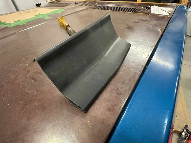

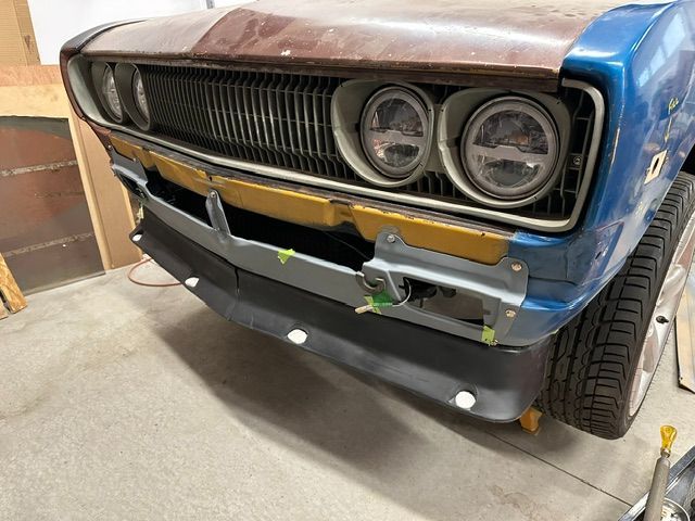

The L side end curve worked out better than the R did (practice makes perfect you know) and proceeded to mount that one up and mark the center line on it. Crunch time now, had to hold my breath and make the cuts.
After remounting the 2 sections, I can say that the workmanship is maybe slightly better than mediocre, the fit at the bottom is good but somehow the top has a gap. Good thing I have the factory center section which has the correct bend, but now I'll have 2 joints to deal with instead of just one. Oh well, good enough. Nicely hides the bar ends though.

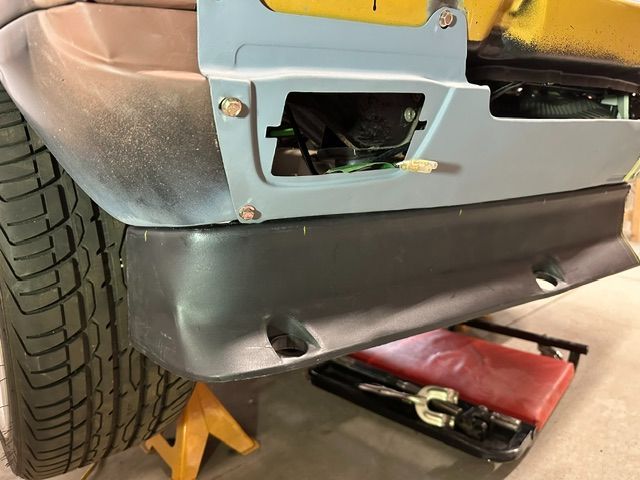

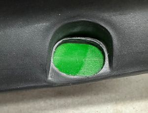

I think I figured out how to deal with the holes in the spoiler - I sliced a chunk of ABS and flattened it, it makes a pretty solid hunk of flat stock that I can use for this purpose plus a couple other unrelated issues.
IMG_6142b.jpg.21aeb154b6a9578e74e29d4be1d5635a.jpg (no that's not the ABS) and yes, the holes are offset and angled - GM quality.
Also I think I have figured out how to deal with the buck-tooth spoiler gap, by overlaying the center chunk. I think that will be better than trying to fit 3 individual pieces together.
