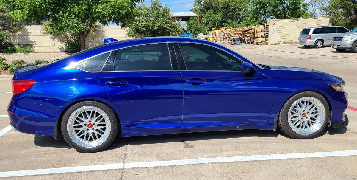

datsunfreak Posted November 23, 2022 Author Report Share Posted November 23, 2022 FYI, I also used this technique to customize my center caps on my daily... Round 1... Round 2, changed to red and removed one B... 1 Quote Link to comment
Duncan Posted November 23, 2022 Report Share Posted November 23, 2022 (edited) BBS: Bunch of Bullshit? 🙂 Sorry. Always the consumate wise ass... They DO look nice. I like the blue background that matches the car vs the red. Edited November 23, 2022 by Duncan Quote Link to comment
datsunfreak Posted November 24, 2022 Author Report Share Posted November 24, 2022 22 hours ago, Duncan said: BBS: Bunch of Bullshit? 🙂 They DO look nice. I like the blue background that matches the car vs the red Not sure if you can see it, but the ones on the car just say BS. 😁 These are replicas of the BBS LM (hence the BS). On the LMs the center caps are black for the road version and red for the racing version. That's why I went with the red in the end. i liked the blue also, but the other factor was that I think I am going to take the wheels off and paint the centers gold, and the red looked better against the gold. 1 Quote Link to comment
