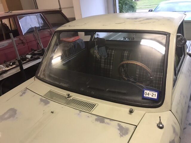

Greaser2 Posted May 15, 2019 Report Posted May 15, 2019 Bought this 1970 Datsun 521 out of SoCal after selling my 280Z. U may have seen it for sell. Plan on going through all systems, not doing a restoration but towards the ratsun look. Have been fixing the usual electrical issues; lights, switches, horn. First project will be the stance. More to come. 11 Quote
Draker Posted May 15, 2019 Report Posted May 15, 2019 Looks like a clean truck. Post wanted ads in the classifieds for stuff you are looking for, lots of parts for that thing still kicking about. 1 Quote
banzai510(hainz) Posted May 15, 2019 Report Posted May 15, 2019 (edited) Lower it maybe Its nice just the way it iS I got the same mirrors also Edited May 15, 2019 by banzai510(hainz) 1 Quote
BrothersGarage Posted May 15, 2019 Report Posted May 15, 2019 What a mint truck! I look forward to seeing what you do with it! 1 Quote
gene knight Posted May 16, 2019 Report Posted May 16, 2019 nice looking 521, i agree on dropping it a little 1 Quote
mrbigtanker Posted May 16, 2019 Report Posted May 16, 2019 Wow wow wow nice truck great truck. Post more pics . 2 Quote
530-521 Posted May 16, 2019 Report Posted May 16, 2019 Awesome. Looks like a nice clean truck. Keep the pics coming! 1 Quote
