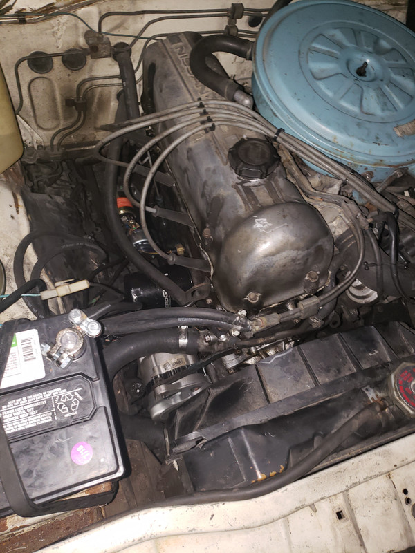

Justin620datsun Posted October 21, 2018 Report Share Posted October 21, 2018 Found this at a car lot and I had to act fast because they were people looking to buy it everyday. Luckily I had the cash. I've been working on it here and there. Today I installed a new battery alternator and starter. The old original ones were still in it but no good. It runs alright now still needs some tuning. 2 Quote Link to comment

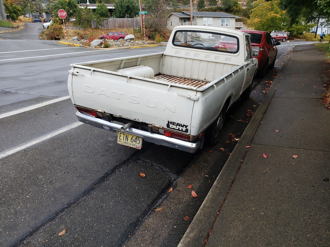

Justin620datsun Posted October 21, 2018 Author Report Share Posted October 21, 2018 Well that's the best I can do. Anyways what exactly does the "heavy duty" mean? 1 Quote Link to comment
datzenmike Posted October 21, 2018 Report Share Posted October 21, 2018 What's the build date on the tag on the driver's door jam? 1 Quote Link to comment

Justin620datsun Posted October 21, 2018 Author Report Share Posted October 21, 2018 Got it. Thanks guys! That was a day or so after I got it running again. I'll check the door jam in a bit. The title says 79. 1 Quote Link to comment
Justin620datsun Posted October 21, 2018 Author Report Share Posted October 21, 2018 Door jam says 2/21/79 1 Quote Link to comment

datzenmike Posted October 21, 2018 Report Share Posted October 21, 2018 1 hour ago, Justin620datsun said: Door jam says 2/21/79 The fender emblems are slightly wrong and there is a hole on the passenger side A pillar for the radio antenna. Should be on the left side. Or maybe it isn't a hole. 1 hour ago, ]2eDeYe said: That is a real nice specimen, love it. ? It is. Heavy Duty (I think) was only on the long bed trucks, and would have some of the suspension parts that came on the Camper option. Different rear leaf springs and it retained the front sway bar that was dropped from use after '77 on the disc brake trucks. It might have the air conditioning rad and water pump/clutch fan (but I can't fine any reference to this) And the decals. Quote Link to comment
Justin620datsun Posted October 21, 2018 Author Report Share Posted October 21, 2018 Yes there is a hole in the a pillar passenger side. But the antenna isn't there. It's on the fender. On the driver side. Which emblems are supposed to be there? I'm new to the datsun game. I know Toyota well not so much datsun/nissan. And on the heavy duty thing that's kind of what I figured. Quote Link to comment
Justin620datsun Posted October 21, 2018 Author Report Share Posted October 21, 2018 I have an electric fuel pump not the mechanical ones obviously but there's no condenser or anything? Could it have been removed. Quote Link to comment
Justin620datsun Posted October 21, 2018 Author Report Share Posted October 21, 2018 here's the fuel pump. Dont mind the mess now that I have it running good I'll be detailing and cleaning off the grim. 1 Quote Link to comment
datzenmike Posted October 21, 2018 Report Share Posted October 21, 2018 Earlier, DATSUN1600 '74 on just DATSUN. Usually the '79 say DATSUNby NISAN This was to start getting people used to the Nissan name change coming in '82. On a vehicle this old it wouldn't be impossible to have changed rusted out or damaged front fenders, in fact the entire cab could have been. The Heavy Duty decal is a '79 item though The '79 was the only 620 to have the antenna mounted on the driver's side A pillar. The fuel pump is mechanical and mounted on the head near the #1 spark plug... you can see the delete cover. Electric pumps were used on '79 air condition or camper trucks. 1 Quote Link to comment
Justin620datsun Posted October 21, 2018 Author Report Share Posted October 21, 2018 Ok I knew mechanical fuel pump was there. So do I have an aftermarket electric fuel pump? Or did someone swap one in? Or is the factory block off plate from the factory? 1 Quote Link to comment

datzenmike Posted October 21, 2018 Report Share Posted October 21, 2018 1 hour ago, Justin620datsun said: Ok I knew mechanical fuel pump was there. So do I have an aftermarket electric fuel pump? Or did someone swap one in? Or is the factory block off plate from the factory? 2 hours ago, datzenmike said: Electric pumps were used on '79 air condition or camper trucks. 1 Quote Link to comment

Charlie69 Posted October 21, 2018 Report Share Posted October 21, 2018 The electric pump you have on your 620 is the same electric pump used on the later 720 carbureted engines. Every time I find one of these pumps on a truck in the junk yard I buy it. Quote Link to comment
Justin620datsun Posted October 21, 2018 Author Report Share Posted October 21, 2018 So someone put it in? Or I can find parts for it if I need to? Because I only find parts for the mechanical ones. Quote Link to comment
