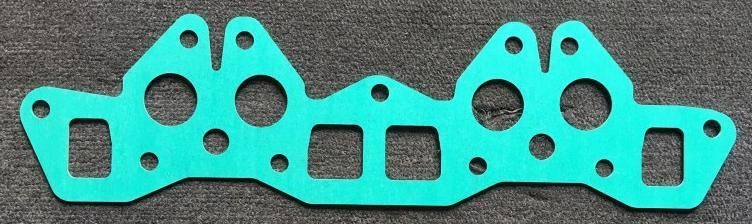

distributorguy Posted July 19, 2018 Report Share Posted July 19, 2018 Who makes the good green intake/exhaust gaskets for square port heads? Emergency rebuild before Bonneville (in 3 weeks) and I need one or two ASAP I can port for my huge header and huge intake. HELP!!! Quote Link to comment

docbainey Posted July 19, 2018 Report Share Posted July 19, 2018 I believe its Top End Performance? There listed on Ebay. Maybe not? https://www.ebay.com/itm/Datsun-510-Exhaust-Header-GASKET-For-L16-L18-L20-510-and-Pickup-/312184834731?_trksid=p2385738.m4383.l4275.c10 Quote Link to comment
distributorguy Posted July 19, 2018 Author Report Share Posted July 19, 2018 Thank you Doc. I searched and searched and couldn't find that late last night. Quote Link to comment

docbainey Posted July 20, 2018 Report Share Posted July 20, 2018 I believe distrutorguy is looking for a gasket that actually seals the 2,3 exhaust ports from each other, he's racing. Most of the manifold gaskets that are out there for 4 cyl L engines, do not seal the 2,3 exhaust ports from each other. Street motor, who cares, racing, different story, especially land speed record sht. What stoff suggested, that gasket cut up, would seal the 2,3 exhaust ports from each other. Just my 5 cents, inflation! 1 Quote Link to comment

distributorguy Posted July 20, 2018 Author Report Share Posted July 20, 2018 I clearly stated I need a larger gasket that I can port to match my HUGE ports. This is for the Bonneville race motor, as stated. My header ports are 2 1/8" pipe, formed to the square port to allow severe anti-reversion. A stock gasket is way too small, and if it has a fire ring, the ring does not land on the header seal area. I specifically asked for the green gasket because its the only one that I can make seal (I have every other gasket money can buy here in stock), despite the fact that its paper and doesn't last long. I only need it to last about 30 miles. The intake ports are 1.6". Thanks again Doc, as those guys not only sold me gaskets, but they had the piston ring set I needed as well and were able to meet my insane timeline for reassembly. You're the only person who answered the question. Cheers!!! 1 Quote Link to comment

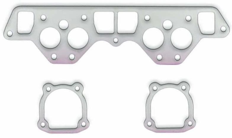

docbainey Posted July 21, 2018 Report Share Posted July 21, 2018 One other source that might work is Remflex. They produce solid graphite gaskets that crush, they will also do custom stuff. http://catalog.remflex.com/NISSAN_Header_Exhaust_Manifold_Gasket_p/15-001.htm Quote Link to comment

Stoffregen Motorsports Posted July 24, 2018 Report Share Posted July 24, 2018 BTW- a friend of mine just brought me a bunch of L series parts for his new 2300. Included in the parts pile are two new Remflex gaskets. I will say, they are nice, but soooooo thick. I wonder how that will or could affect the fitment of things. I'll keep you guys posted as I get them installed. Quote Link to comment
docbainey Posted July 24, 2018 Report Share Posted July 24, 2018 Stoff, According to the Remflex website, I believe they crush to half their original thickness. 1 Quote Link to comment

Stoffregen Motorsports Posted July 25, 2018 Report Share Posted July 25, 2018 Specifically I am worried that they are so soft that the ears will crack off the intake while torquing them down. Anybody ever break a side draft carburetor by over tightening it onto an o-ring style soft mount? I have and I've repaired carbs that others have cracked too. If it's too soft under the ears, extreme care will need to be taken during the installation. Like I said, I'll give you guys my impressions after I've installed them. 1 Quote Link to comment

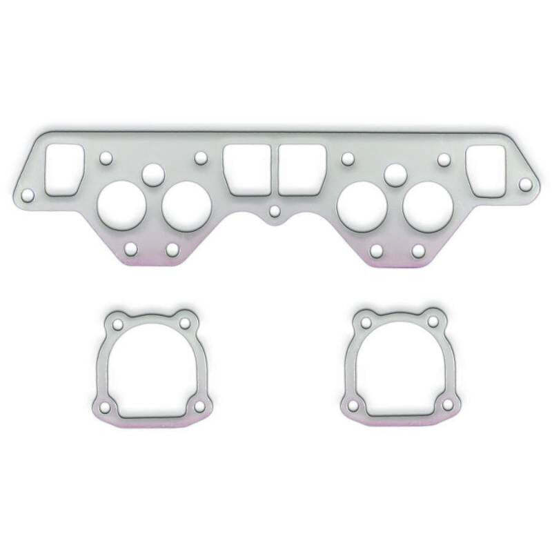

iceman510 Posted May 27, 2025 Report Share Posted May 27, 2025 (edited) On 7/25/2018 at 11:18 AM, Stoffregen Motorsports said: Like I said, I'll give you guys my impressions after I've installed them. Still waiting...🕔 Necro thread revival, but searching around for intake gasket choice information and came across this. The ebay link provided by Doc at the beginning is dead. Anyone know what gasket the was showing? Wait-maybe I found it, but the intake ports don't look that big. https://www.racetep.com/automaker/datsun-z/datsun-headers/header-gasket-45761.html Is that the same one those of you with long memories? Thanks. Edited May 27, 2025 by iceman510 1 Quote Link to comment
Crashtd420 Posted May 27, 2025 Report Share Posted May 27, 2025 41 minutes ago, iceman510 said: Still waiting...🕔 Necro thread revival, but searching around for intake gasket choice information and came across this. The ebay link provided by Doc at the beginning is dead. Anyone know what gasket the was showing? Wait-maybe I found it, but the intake ports don't look that big. https://www.racetep.com/automaker/datsun-z/datsun-headers/header-gasket-45761.html Is that the same one those of you with long memories? Thanks. This is the reflex gasket, I was using one for a while.. actually twice.. never had an issue. https://ebay.us/m/2Dr0Wg 1 Quote Link to comment

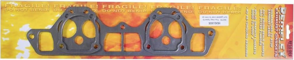

ggzilla Posted May 27, 2025 Report Share Posted May 27, 2025 The original poster was asking about the GREEN gasket that can be hogged out to match HUGE PORTS 3 hours ago, iceman510 said: The ebay link provided by Doc at the beginning is dead. Anyone know what gasket the was showing? He confirmed it was the Top End Performance gasket -- which is only $24 now in 2025 The Remflex is not the one the original poster was asking about. However it does have the split center exhaust ports (seals the 2,3 exhaust ports from each other) and is very thick to conform to iffy header flanges Remflex 15-001 graphie header/exhaust manifold gasket $45 from Amazon 1.25" x 1.5625" square exhaust ports Comes with two intake-to-exhaust (heat riser) gaskets 1 Quote Link to comment
datzenmike Posted May 27, 2025 Report Share Posted May 27, 2025 This will then fit all L16/18/20Bs through '77. '78-'80 L20Bs used the round exhaust. Holes too large are better than too small holes. Quote Link to comment

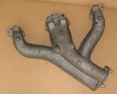

ggzilla Posted May 27, 2025 Report Share Posted May 27, 2025 It looks like it has the large 1.5" intake ports. The most expensive gasket at $45, but the package says "Guaranteed to stop exhaust leaks". Dunno if it can be ported out for HUGE 1.6" racing intake ports like the green gasket can be If you run the cast iron header you won't need this fancy-schmancy gasket. This one isn't tuned like a racing header, but is tuned for street use. Is it big enough for an L20B? Quote Link to comment
