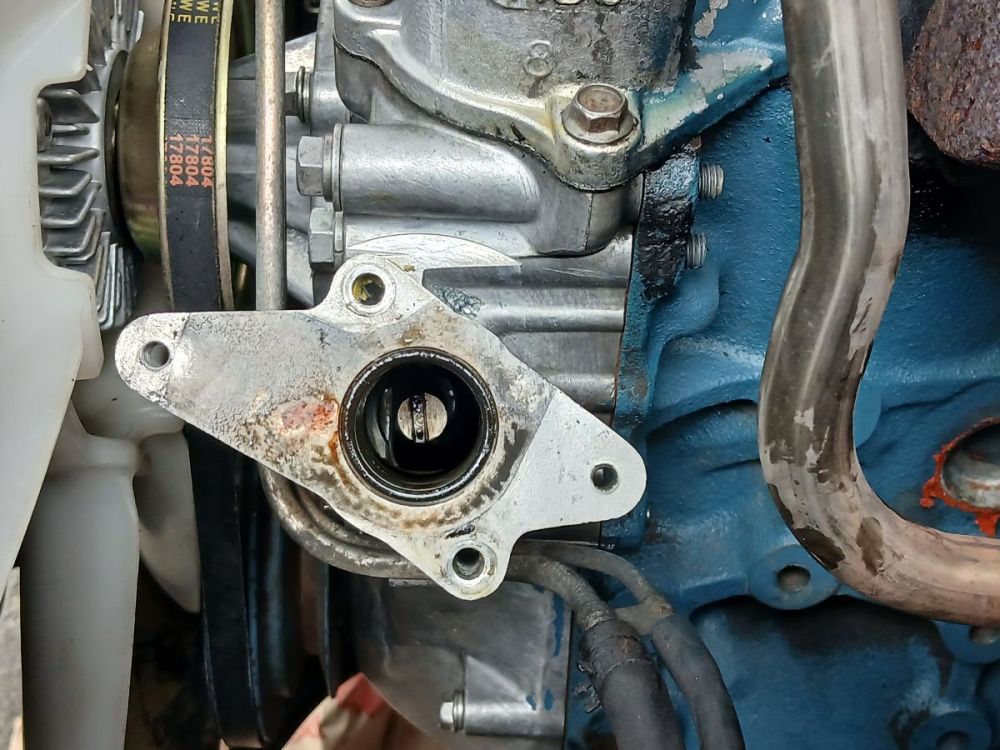

wilfredmatias Posted June 20, 2025 Report Share Posted June 20, 2025 Hello, I have installed the KA 24 E oil pump. Everything went smooth! I just want to pointed out that the rattle noise went away after the 2nd time starting up the car. Besides of this, I ended up installing the new oil pump. Thanks everyone for your help and replies. I really appreciate that. 1 Quote Link to comment

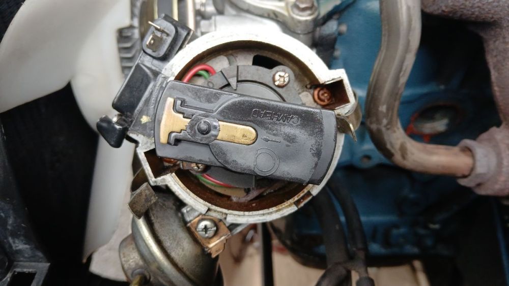

banzai510(hainz) Posted June 20, 2025 Report Share Posted June 20, 2025 should of been a little more clockwise right of top hole.left on bottom. but if ur in time . Drives ok up hill call it good 1 Quote Link to comment
wilfredmatias Posted June 20, 2025 Report Share Posted June 20, 2025 16 hours ago, banzai510(hainz) said: should of been a little more clockwise right of top hole.left on bottom. but if ur in time . Drives ok up hill call it good Hello, Yes, you are correct. I need to spin it a little more clockwise. I will do that. Its not going fast uphills. Many thanks! Quote Link to comment

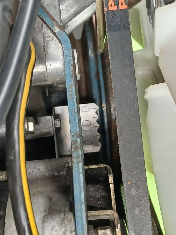

datzenmike Posted June 20, 2025 Report Share Posted June 20, 2025 Use a timing light. If you can set the timing @ 3 to 5 degrees, (check the owner's manual for correct amount) then it doesn't need changing. Don't fix what isn't broken. 1 Quote Link to comment
banzai510(hainz) Posted June 20, 2025 Report Share Posted June 20, 2025 (edited) if you had it where it was pulled and put back in should be ok.( i think) I persoanllly hate that way to do it I pull the whole thing. Done them in parking lots. put to exact TDC on crank then pull notice where the spindal is in case someone did it different earlier. then put back in. go to 47mins Edited June 20, 2025 by banzai510(hainz) 2 Quote Link to comment
wilfredmatias Posted June 22, 2025 Report Share Posted June 22, 2025 On 6/19/2025 at 9:00 PM, banzai510(hainz) said: should of been a little more clockwise right of top hole.left on bottom. but if ur in time . Drives ok up hill call it good Hello, Yes, you are correct. I need to spin it a little more clockwise. I will do that. Its not going fast uphills. Many thanks! Quote Link to comment
