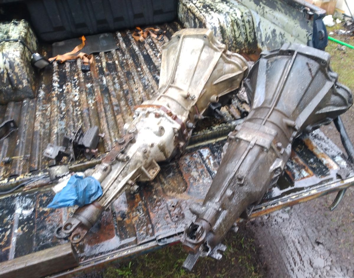

banzai510(hainz) Posted March 29, 2025 Report Share Posted March 29, 2025 i had a vibration once. i jack up the truck and put in gear and saw vibration.2bolts missing .then find out they also sae sizes on 521s except motor. You done good and fast if back on road. I personlly hate 521 trans set up. Pulln all that shit out nearing 60yrs old isnt good. I got 2 toyota p/u. 91 and 92. They not as cool as 521 but way better rigs 1 Quote Link to comment

.sunlover Posted March 29, 2025 Author Report Share Posted March 29, 2025 48 minutes ago, banzai510(hainz) said: i had a vibration once. i jack up the truck and put in gear and saw vibration.2bolts missing .then find out they also sae sizes on 521s except motor. You done good and fast if back on road. I personlly hate 521 trans set up. Pulln all that shit out nearing 60yrs old isnt good. I got 2 toyota p/u. 91 and 92. They not as cool as 521 but way better rigs Thanks! Yeah, it took 8 days to source a new transmission and install it. I of course still had to do my regular work. 5 more days and I found and installed the driveline, and it's a good driving truck, again. Tranny swapping a 521 is pretty awful. That non-removable cross member is the worst part for me. Oh, and this time, I couldn't use my buddies' machine/auto shop, because they are growing into a 3rd unit in the business complex they are in. They bought a massive machine and the stuff they had to get out of the way is stacked in the lift bay. I was working under jack stands on muddy gravel in occasional rain, snow, and hail. Toyotas are good rigs. I dropped a tranny out of an 81 corolla and a 98 4runner, but not 90 91. the 81 was pretty easy, but the 4runner wasn't. everything is wired in, no wire connectors, and it's big and heavy. Oh, and both the strut rods for my 521, at the pick n pull were bent. I could straighten them, but they would be weaker. I am getting some made, soon, anyway. They were the same length as in my 521. Quote Link to comment

NC85ST Posted March 29, 2025 Report Share Posted March 29, 2025 A week to source and install a transmission? Amazing! Where I live that would be impossible, a month maybe. Congratulations on being 9 months sober, that’s even more amazing. Keep up the good work. 1 Quote Link to comment

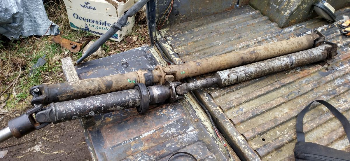

.sunlover Posted March 29, 2025 Author Report Share Posted March 29, 2025 I didn't lower it. PO did. Looks like 1.5" blocks. Bushing is NLA, and not terrible. It has some years on it, but only 50k miles. it's in the driveline picture. with the thing bolted down, it's pretty tight. Not so much, when it's not bolted. But, it's NLA, so, I hose clamped both sides of it, to restrict the movement. Now, since it only moves at the slip yoke, no more hose clamps. Please prove me wrong about that bushing being NLA. I would love to be wrong about that. Taiwan has all the cab seal rubber, but no carrier bushing that I could find. It seems like it will now slide inside the carrier bushing, when it goes over bumps. Snug might be the best tightness for it. Bolted tight and just snug. That's what I've got. Quote Link to comment
Crashtd420 Posted March 29, 2025 Report Share Posted March 29, 2025 10 minutes ago, .sunlover said: I didn't lower it. PO did. Looks like 1.5" blocks. Bushing is NLA, and not terrible. It has some years on it, but only 50k miles. it's in the driveline picture. with the thing bolted down, it's pretty tight. Not so much, when it's not bolted. But, it's NLA, so, I hose clamped both sides of it, to restrict the movement. Now, since it only moves at the slip yoke, no more hose clamps. Please prove me wrong about that bushing being NLA. I would love to be wrong about that. Taiwan has all the cab seal rubber, but no carrier bushing that I could find. It seems like it will now slide inside the carrier bushing, when it goes over bumps. Snug might be the best tightness for it. Bolted tight and just snug. That's what I've got. I did a write about for a replacement carrier bearing.... Go down the page to the b2000 information... https://ratsun.net/topic/80193-datsun-521-carrier-bearing-replacement-option/ 1 Quote Link to comment

wayno Posted March 30, 2025 Report Share Posted March 30, 2025 (edited) On 3/26/2025 at 9:30 PM, .sunlover said: I do not know what that is on the driveline closet in the photo, but that is not a 521 center support, when installing that driveline the round piece with the rubber has to fit tight in the center mount, if it is tight the driveline cannot back out of the transmission as that piece on the driveline is supposed to be tightly mounted on the drive shaft. Was the center mount mounted to the cross member tight? It appears the 620 driveline(farthset away in photo) does not have the center support piece either, where is the rubber support? Edited March 30, 2025 by wayno Quote Link to comment
datzenmike Posted March 30, 2025 Report Share Posted March 30, 2025 This is the 620 rubber surround and it DOES allow some forward and back movement because it does not have a slip yoke on the rear most driveshaft. If there is a small amount of forward and back at the differential from suspension flex or during acceleration and braking then the spline can slide in and out of the transmission. The PL521 front driveshaft is SOLIDLY bolted to the transmission and any forward and backward component of the differential is taken up by the slip shaft in the rear driveshaft. Quote Link to comment
wayno Posted March 30, 2025 Report Share Posted March 30, 2025 I suspect he has a 5spd with a slip yoke installed on the 521 driveline same as I did on my 521 work truck, my center support had a 521 rubber surround, it allowed very little forward/rearward movement, Sunlover said he had to slip the yoke back forward into the transmission at some point to get home, this just does not seem possible unless the center rubber support was free to move around. Quote Link to comment
.sunlover Posted March 30, 2025 Author Report Share Posted March 30, 2025 41 minutes ago, wayno said: I do not know what that is on the driveline closet in the photo, but that is not a 521 center support, when installing that driveline the round piece with the rubber has to fit tight in the center mount, if it is tight the driveline cannot back out of the transmission as that piece on the driveline is supposed to be tightly mounted on the drive shaft. Was the center mount mounted to the cross member tight? It appears the 620 driveline(farthset away in photo) does not have the center support piece either, where is the rubber support? What I have is the thing on the 521 driveline, slid forward of the carrier bearing. It is what I got when I bought a new carrier bearing and bushing for it, about 25 years ago. the metal around it unbolts and comes off of it. Just the rubber is in the picture there. The 620 driveline had an open hole where the bushing was supposed to be and a somewhat similar housing to what I have. I wouldn't think I have a different bushing, since it bolts perfectly into place on the 521, but I guess it's possible. I really think the thing to focus on is that it is there, it fits and bolts down correctly, and it does allow for a little movement, like a 620 driveline setup requires. Thanks for the help. I'm going to go drive my Datsun, now. Quote Link to comment
datzenmike Posted March 30, 2025 Report Share Posted March 30, 2025 I agree. The driveshaft was moving back and collapsing into the slip yoke. I bet the rubber surround is totally gone. The 620 surround will move but maybe an inch both ways. Quote Link to comment
.sunlover Posted March 30, 2025 Author Report Share Posted March 30, 2025 1 hour ago, datzenmike said: This is the 620 rubber surround and it DOES allow some forward and back movement because it does not have a slip yoke on the rear most driveshaft. If there is a small amount of forward and back at the differential from suspension flex or during acceleration and braking then the spline can slide in and out of the transmission. The PL521 front driveshaft is SOLIDLY bolted to the transmission and any forward and backward component of the differential is taken up by the slip shaft in the rear driveshaft. Wow, so weird. Mine and the wrecking yard 620 carrier bushing and housing are similarly different. Mine allows for some movement, so I'm calling it good. It's hard to remember the details of a 25 year old purchase that was one of many I was making at the time. Thanks for the info. Quote Link to comment
.sunlover Posted March 30, 2025 Author Report Share Posted March 30, 2025 Ok, I will be driving with the imaginary rubber bushing that is in the driveline picture there. I guess I will imagine it's driving nice and smooth too. Just like you guys are imagining that after 30 years of automotive experience that I don't know the difference between a missing bushing and a snug one that allows for some movement. Even when there is a picture of it. Quote Link to comment

wayno Posted March 31, 2025 Report Share Posted March 31, 2025 OK, this is the only photo I have of the rubber piece in a truck, this is my 720 which has a larger rubber piece, the piece was so bad(deteriorated) that I put rubber hose pieces around the inside of it so it would hold it in the correct place as I did not like the clunking and more importantly I did not want it to explode and possibly have a catastrophic event like losing the driveline and have it come out from under my truck and hit something, or have it completely raise the back of the truck up and finally breaking off the rear axle, I can only imagine bad things happening. I had a drive line come out of my 1965 Nova/4spd with a 350hp one time power braking on the start line, I was lucky no one was on the side of the car, it flew 30 feet sideways. That rubber piece keeps the forward/backward motion of the driveline happening in a 521 with a rear slip joint, one could say the 620 driveline without a slip joint will not move forward or backwards, without that rubber piece in the joint it can wobble, at high speed that wobble could take you out of the picture. Quote Link to comment
.sunlover Posted March 31, 2025 Author Report Share Posted March 31, 2025 I have run out of ways to attempt to let you know that the bushing I even took a picture of, does indeed exist, and is working perfectly for the application it is designed for. Feel free to go on ignoring everything I say and the picture of it. I have been driving it daily for a week now and it is fantastic. No clunk, no wobble. Do you know why? It is because it does exist and is working great. after 25 years, it allows for some movement. Bad for a driveline that slipped at both ends, but great for the 620 style. What do I know, though? I'm just the mechanic that owns it, is looking at it, working on it, driving it, taking pictures and telling you several times, in perfect English what is going on. My patience is spent. Quote Link to comment
datzenmike Posted March 31, 2025 Report Share Posted March 31, 2025 If the rubber surround was in place and working then the front driveshaft couldn't have wandered more than an inch or so to the rear. What do you think? Quote Link to comment
.sunlover Posted March 31, 2025 Author Report Share Posted March 31, 2025 It was in place. the limiting factor for how far forward it can walk was where it would hit the bushing housing. It was hose clamped around the bushing that does exist, on both sides, like I have said. first to keep it from walking forward, then to also keep it from walking back. I think that the one time it walked back (like I mentioned) and made a horrible vibration, and I fixed that by knocking it forward and adding the 2nd clamp to prevent that, it was far enough back to either aggravate an existing crack or make one. After I did that in the hobo freight parking lot, I drove home a short distance just fine, but the next time I drove it, BOOM. I told you that it was there, described the condition, took a picture, repeated myself and was as clear as possible, explained that I am sober and have been for almost a decade. What did you think? I'm too stupid to know the difference between a bushing being in place and an open hole where it's supposed to be? That seems to be the story you are going with. That's not supposed to be insulting to me? That is the most logical explanation? Quote Link to comment
