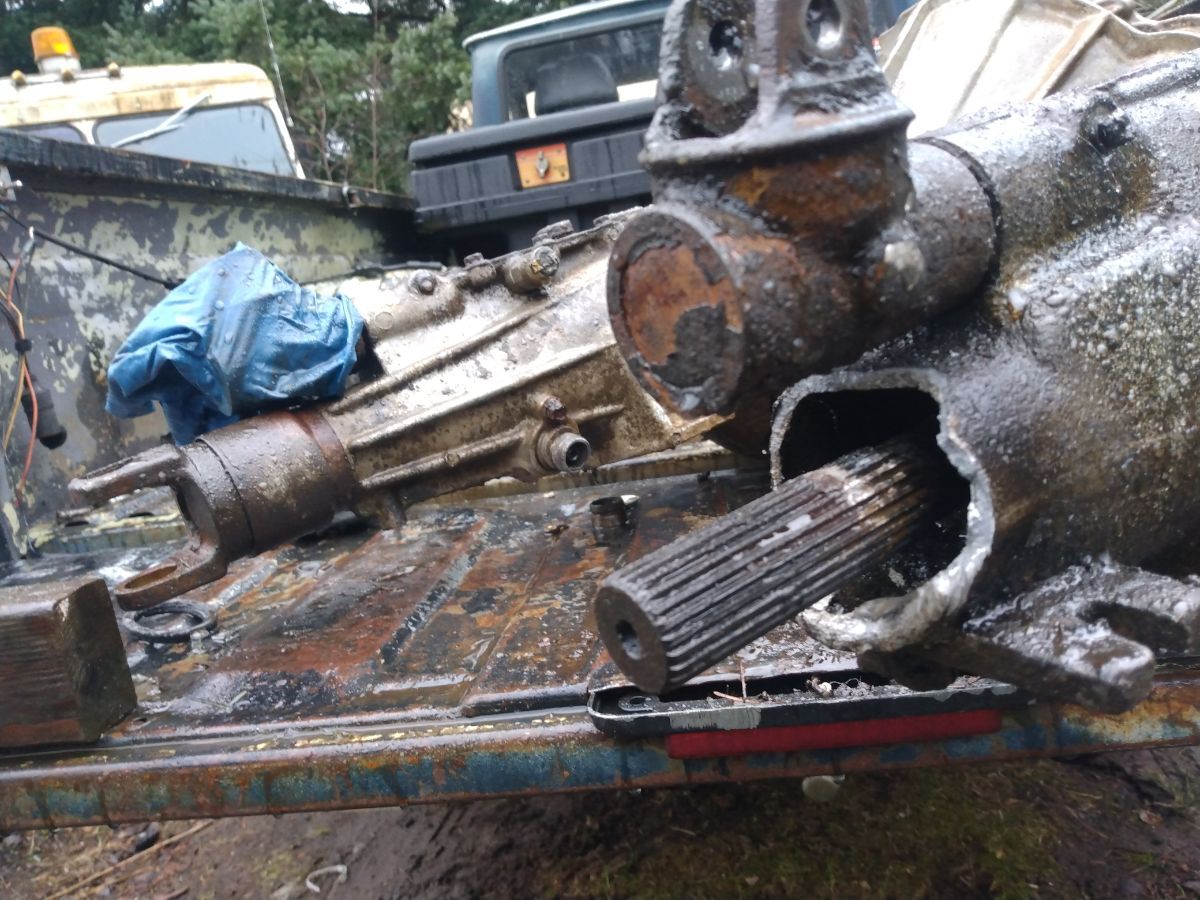

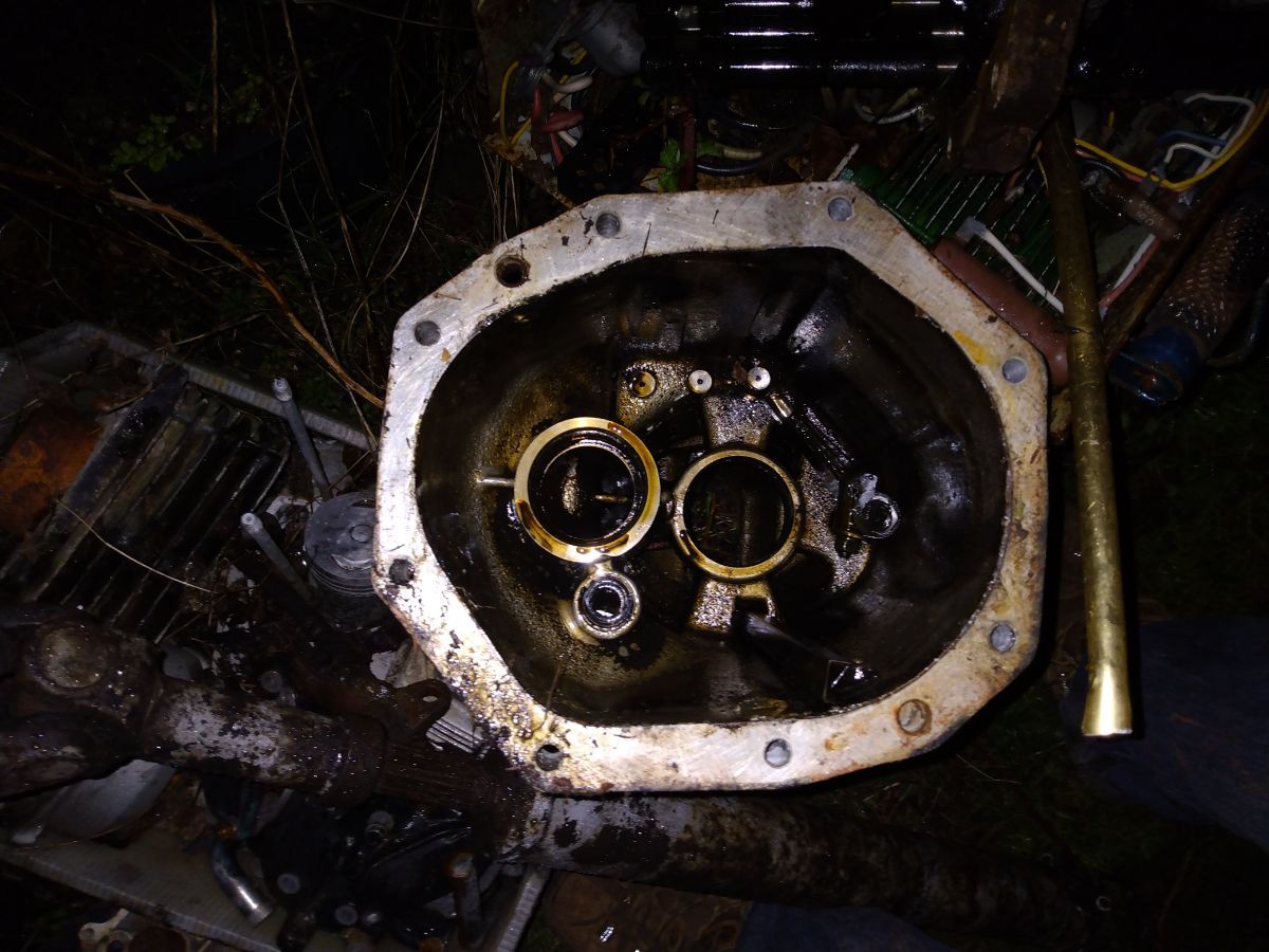

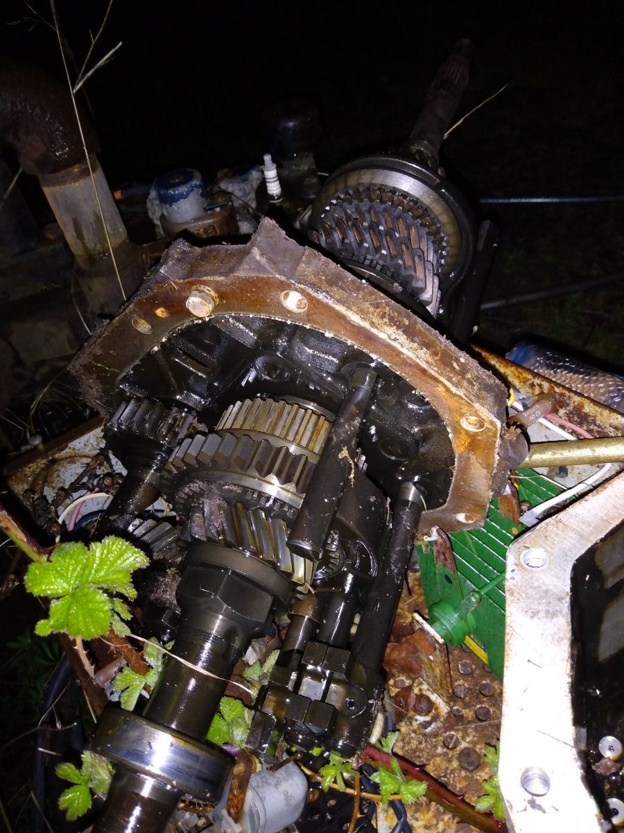

.sunlover Posted March 27, 2025 Author Report Posted March 27, 2025 I have been DDing my 521 for a decent amount of time since my last major issue. I did my fuel tank treatment, so no more boat tank or rusty clogged fuel filters. Recently, my transmission ejected the back of itself in pieces. (Bad bearing) The transmission my budget allowed for was a 4 speed, sadly. So nice having the (low miles 78 620) truck transmission, though. 280z 5 speed was not so smooth. (close ratio) I miss fifth gear, for sure. I shit you not, my old 5 speed put impact dents in the tunnel around the tail. Shook the thing so hard a spark plug wire came out of the dizzy. I found out afterward that in addition to roasting the slip yoke, it loosened the spline that my rear driveline slides along (the adjustable part. It drove like it had a really bad u joint with the new to me transmission. .......All the way to pick n pull to get the driveshaft out of a 73 620. That was today. I used the best out of the 2 assemblies and was lowering the jack in front for the test drive and noticed the end was broken off of one of my strut rods.... Grrrr They seem to be unobtainium, so I welded it. I don't know how long it will last, being so hard and brittle at the weld, but I am back on the road comfortably, again. Classifieds don't list any, but if anyone knows anyone that has them, or one, I would appreciate it if you pointed me in the right direction. Oics are coming. Quote

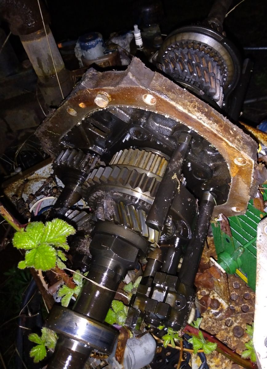

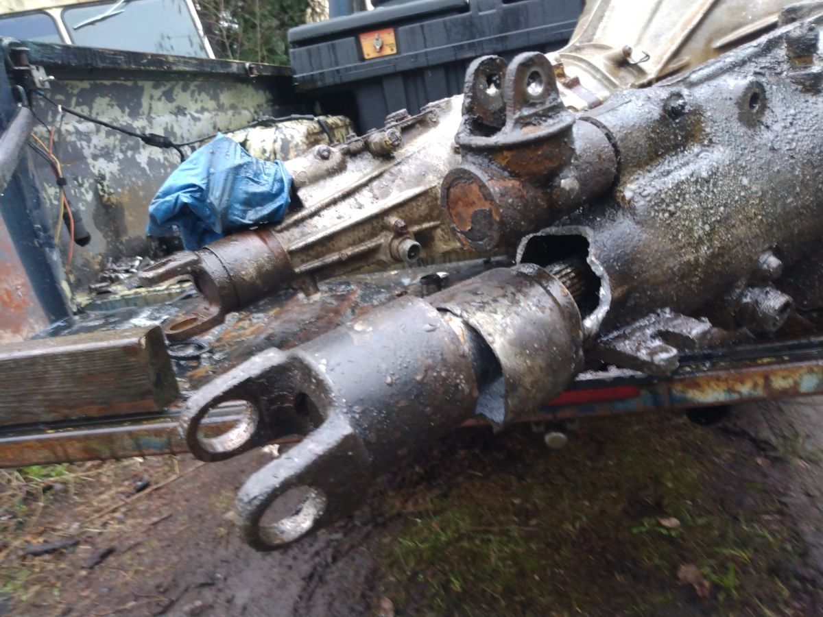

.sunlover Posted March 27, 2025 Author Report Posted March 27, 2025 It was 1:00am when the tail of the Transmission exploded and all the oil ejected. I looked at the aftermath, cussed a little, then hit the slip yoke forward into the open spline from the transmission a bit further. Then I drove a few miles home, the remains of that dust sleeve jingling the whole way. Transmission was toast anyway. Might as well try to save myself a tow bill. Not a drop of oil came out of the drain, when I got back. I wonder what the inside of it looks like, lol. .....Yeah, I'm going to take a look. Quote
datzenmike Posted March 27, 2025 Report Posted March 27, 2025 Something wasn't right. Transmissions don't just blow up. Quote
NC85ST Posted March 27, 2025 Report Posted March 27, 2025 How long was that transmission in your truck? You ran it a good while with the two slip points, one at the transmission and the other on the back half of the driveshaft? When I switched to a 5-speed in mine, I used a complete 620 driveshaft. Quote
.sunlover Posted March 27, 2025 Author Report Posted March 27, 2025 1 hour ago, datzenmike said: Something wasn't right. Transmissions don't just blow up. Everything dies, eventually.. Probably a bearing. IDK how many miles it went before the 50k miles I used it. Gear oil was never low. Still full less than a week before it died. It was whining big time, and I kept using it. The stupid driveline setup that slid before and after the carrier bearing was a pain in the ass and I had to hose clamp both sides of the carrier bushing to keep it from walking forward into the carrier bushing housing, or back far enough that the dust covers at the tranny output didn't overlap. Quote
.sunlover Posted March 27, 2025 Author Report Posted March 27, 2025 16 minutes ago, NC85ST said: How long was that transmission in your truck? You ran it a good while with the two slip points, one at the transmission and the other on the back half of the driveshaft? When I switched to a 5-speed in mine, I used a complete 620 driveshaft. It was already swapped 25 years ago, when I got it. As part of my overhaul back then, I just got a new carrier bushing and bearing and considered it good to go. It kind of stayed as a project until 2010 or so and then I drove it daily. It was off the road for a half a dozen years after that, while I took care of other things, and back to DDing a couple years ago. Then the bushing was loose enough to let it walk and I had to clamp it and let both ends slip, instead. The driveline I just got was out of a 620. Sadly, the carrier style, but no rear slip, at least. Quote

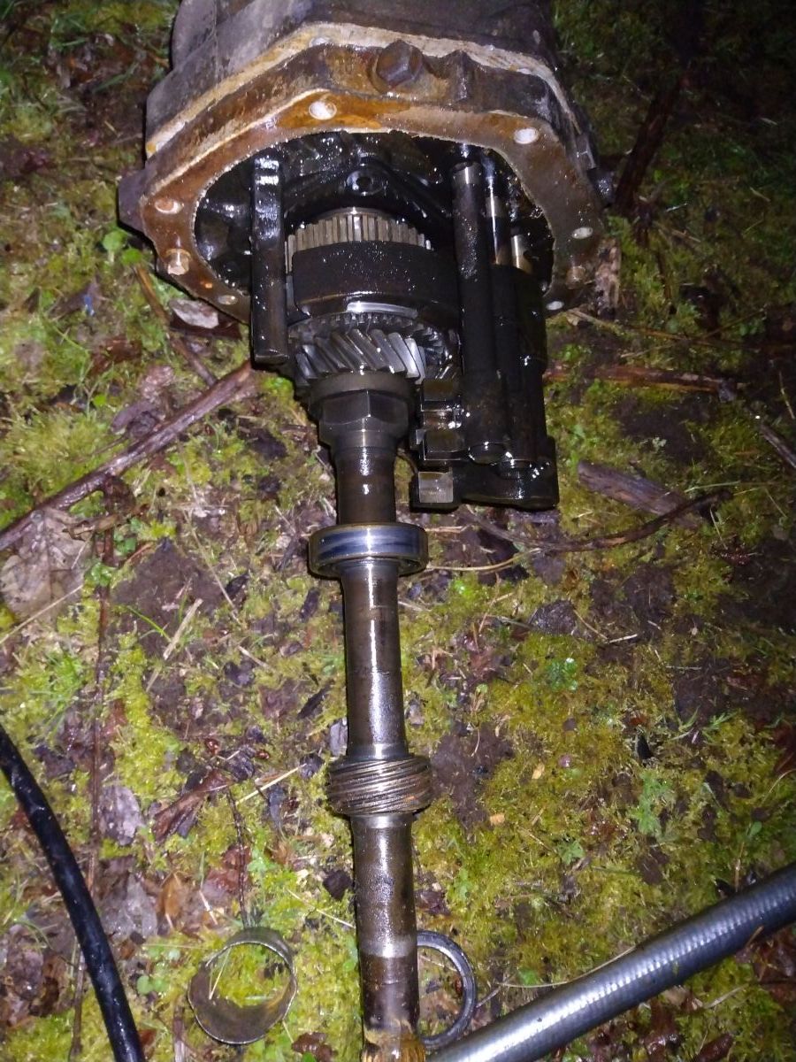

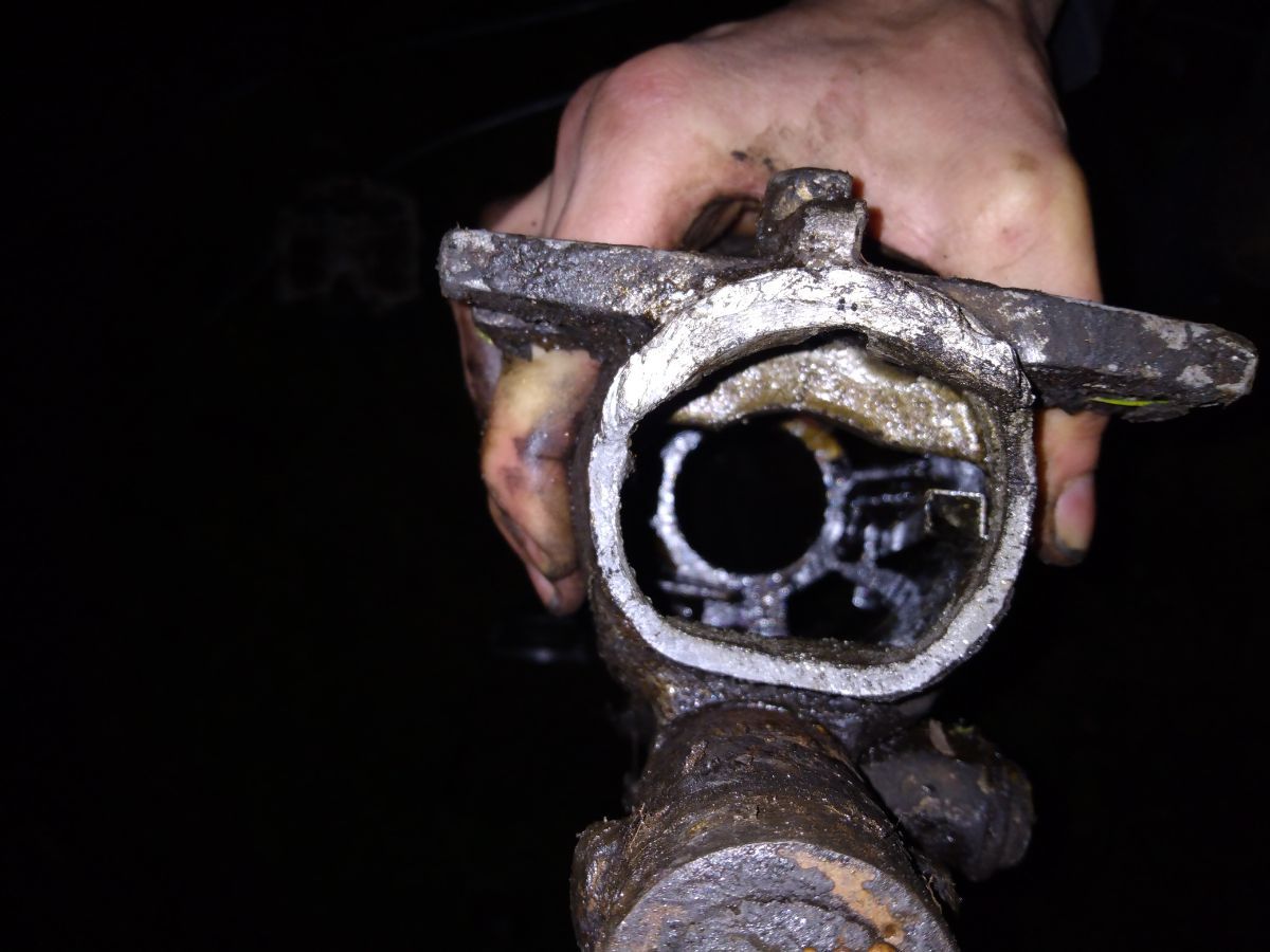

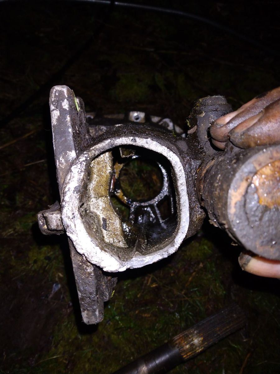

datzenmike Posted March 28, 2025 Report Posted March 28, 2025 9 hours ago, .sunlover said: It was already swapped 25 years ago, when I got it. As part of my overhaul back then, I just got a new carrier bushing and bearing and considered it good to go. It kind of stayed as a project until 2010 or so and then I drove it daily. It was off the road for a half a dozen years after that, while I took care of other things, and back to DDing a couple years ago. Then the bushing was loose enough to let it walk and I had to clamp it and let both ends slip, instead. The driveline I just got was out of a 620. Sadly, the carrier style, but no rear slip, at least. 10 hours ago, .sunlover said: Everything dies, eventually.. Probably a bearing. IDK how many miles it went before the 50k miles I used it. Gear oil was never low. Still full less than a week before it died. It was whining big time, and I kept using it. The stupid driveline setup that slid before and after the carrier bearing was a pain in the ass and I had to hose clamp both sides of the carrier bushing to keep it from walking forward into the carrier bushing housing, or back far enough that the dust covers at the tranny output didn't overlap. There's no bearing right here but just forward is a bushing or sleeve that supports the main shaft. This must have been cracked a long time ago and was ticking. 1 Quote
.sunlover Posted March 28, 2025 Author Report Posted March 28, 2025 27 minutes ago, datzenmike said: There's no bearing right here but just forward is a bushing or sleeve that supports the main shaft. This must have been cracked a long time ago and was ticking. Ah, okay, mystery solved. Thanks Mike. Quote

.sunlover Posted March 28, 2025 Author Report Posted March 28, 2025 I think it looks good, for s tranny with an exploded ass that got run dry for 4 miles. Maybe I should go to the oil spot and get the actual mileage. It would be a good picture.... The truck is driving so good, now. 20mpg and smooth shifting and driving, kind of quiet inside, dry, and everything works. It's like a new truck, but instead of dollars, you pay tears and hours and a little blood and other injury. ...And dollars. I stand behind my choice. Nobody has exactly what I have. Many people are probably thankful that they don't, lol, but it's mine and it's exactly how I like it. except for the things on the never-ending list. Quote
datzenmike Posted March 28, 2025 Report Posted March 28, 2025 Note that the metal looks freshly cracked on the top (it's upside down) but the bottom looks smooth(er)? Maybe welded or it was cracked and rubbing? To break the tail off would have been noticeable when driving... a huge vibration or noise. This was damaged a long time ago. 2 Quote
.sunlover Posted March 28, 2025 Author Report Posted March 28, 2025 5 hours ago, datzenmike said: Note that the metal looks freshly cracked on the top (it's upside down) but the bottom looks smooth(er)? Maybe welded or it was cracked and rubbing? To break the tail off would have been noticeable when driving... a huge vibration or noise. This was damaged a long time ago. Yep, it shook and made noise like bad shit was going to happen, then bad shit happened. It wasn't nearly as obvious that I should stop driving it and find the vibration, until that last trip. It made other less concerning noises, but I wasn't 100% sure that they weren't happening all along. I finally put a muffler on it (and stepped down to 2" and routed it around my spare tire spot.) and started hearing all sorts of things. Like the stereo, for example. Quote
