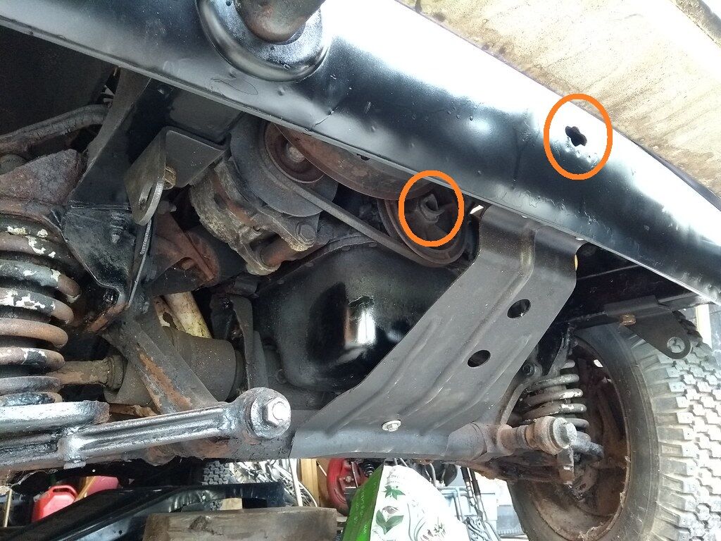

Noll Posted August 3, 2021 Author Report Share Posted August 3, 2021 Really small update, but finally got a nut on to the motor mount that was missing it and had really messed up threads. Not a fun time, enclosed area and deep in under the car. Ended up cutting the thread shorter and nicked the mount bracket in the process, so crappily welded it up (again, hard spot to reach and dark). 3 Quote Link to comment
