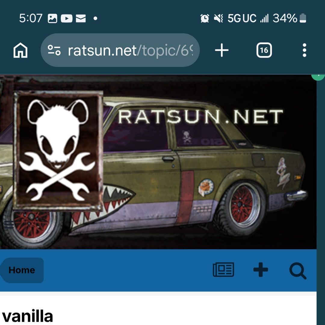

Crashtd420 Posted March 2 Report Share Posted March 2 12 hours ago, DatsuNissanLove said: Yoh mike. How come I can't get to my profile "which used to be an option on the top of the page" from the home page. Try clicking just behind the front wheel of the 510 at the top just under the rat and wrench logo.... 1 Quote Link to comment
DatsuNissanLove Posted March 3 Author Report Share Posted March 3 11 hours ago, Crashtd420 said: Try clicking just behind the front wheel of the 510 at the top just under the rat and wrench logo.... Wow. Lol. Thanks. That worked. Quote Link to comment
DatsuNissanLove Posted March 3 Author Report Share Posted March 3 Before I would just see a ¼ of the green circle indicating a notification. Quote Link to comment
datzenmike Posted March 3 Report Share Posted March 3 Must be a hand held device. At home the rats n wrenches is on the far left. Quote Link to comment
DatsuNissanLove Posted March 3 Author Report Share Posted March 3 6 minutes ago, datzenmike said: Must be a hand held device. At home the rats n wrenches is on the far left. Yeah. I've always used a phone and it wasn't like this before. All good though. Crashtd420. Thanks again Quote Link to comment

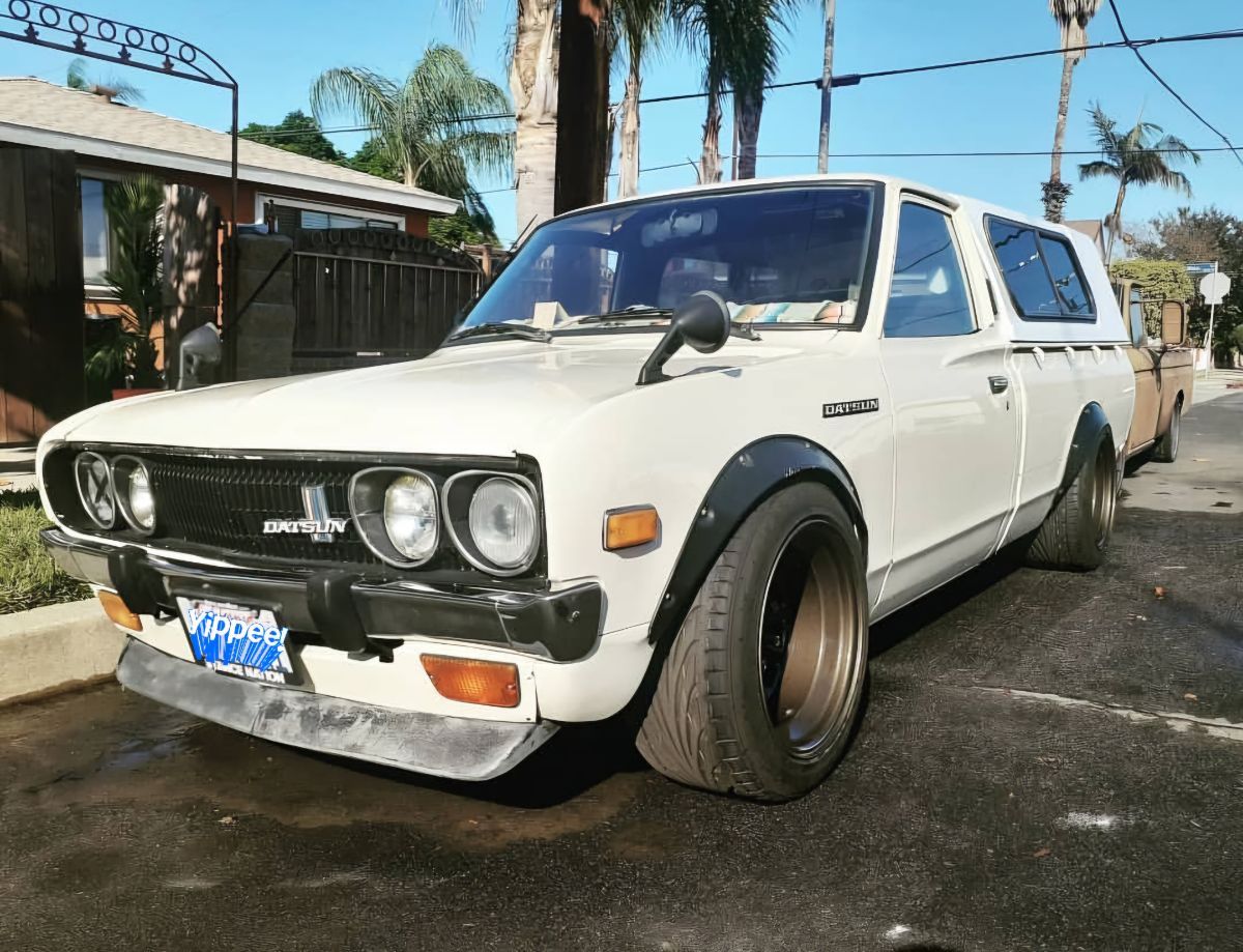

DatsuNissanLove Posted March 10 Author Report Share Posted March 10 Crazy what having a kid does. My daughter is getting to an age where she's a Lil more independent, so my plan is to get my vanilla running and either selling/trading her to get a 510 4 door or a wagon. Pre 75 because dumb california. This is one of the last pics I took of my truck in 2020. Quote Link to comment

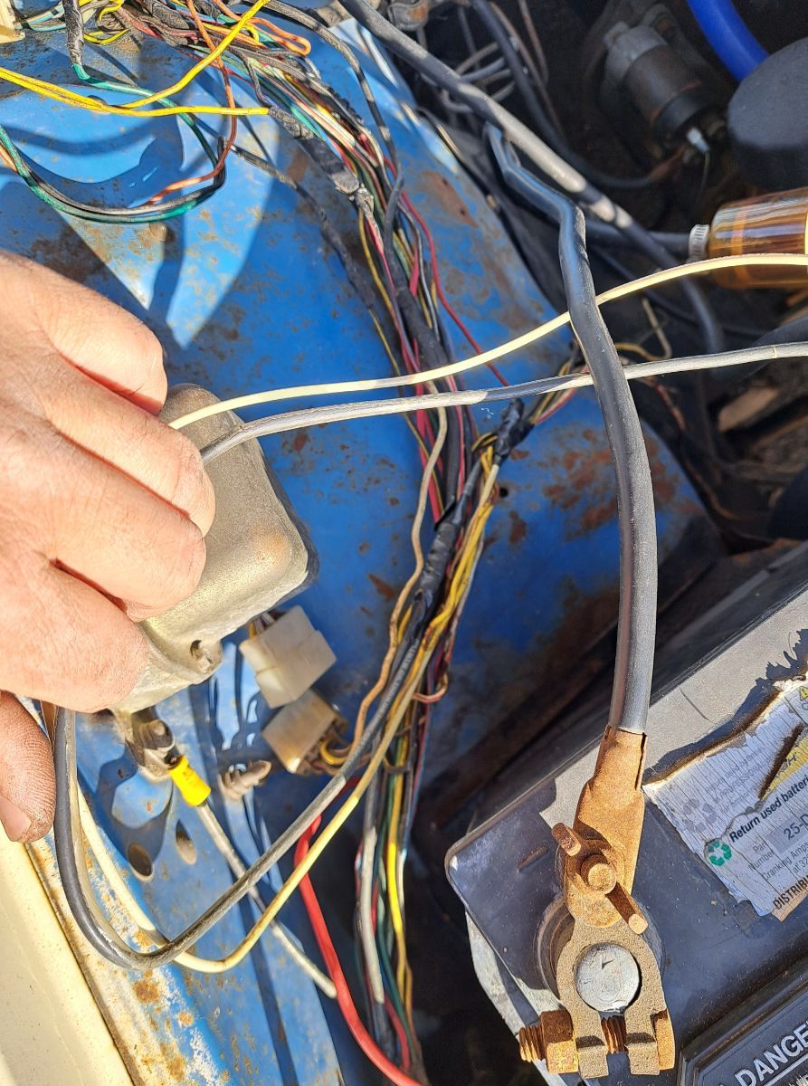

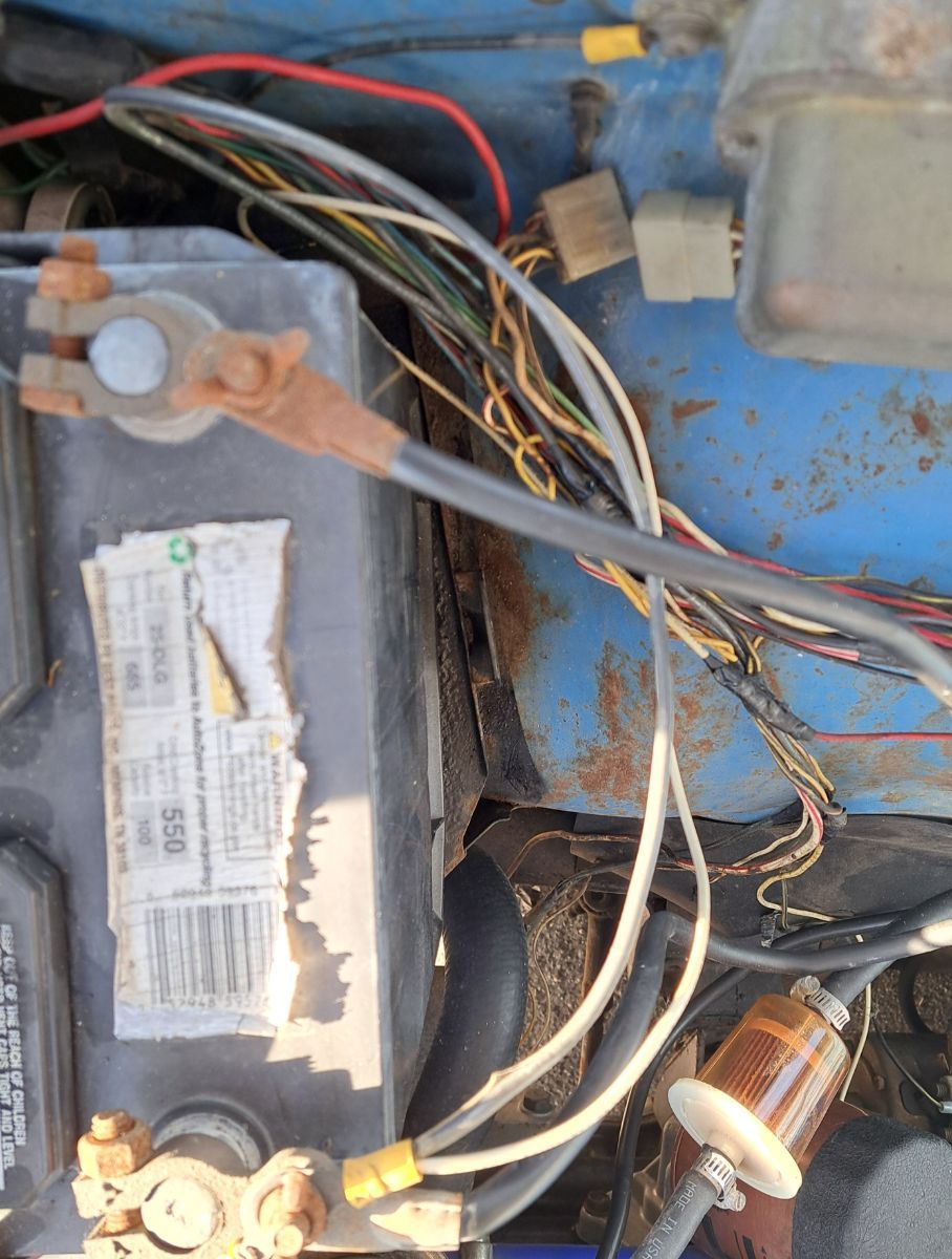

DatsuNissanLove Posted March 15 Author Report Share Posted March 15 On 3/10/2026 at 5:38 PM, datzenmike said: So I tried jumping my car n got no crank and no lights on my dash. No clicks of any kind or anything. Has a fairly new starter in it ( hasn't ran for 6 years though). I did not have the 10 amp fuse in that controls the meter/reverse/regulator because it's the one that kept popping before. It probably also explains why none of the lights on the dash were on? Also had my hazards/ voltage regulator / and turn signal disconnected because I was gonna try Mike's method of figuring out why that 10 amp fuse kept popping. I'm thinking of changing out the ignition switch because I have no idea how old it is. Besides that what else should I check/ change to get it to crank. Quote Link to comment
datzenmike Posted March 15 Report Share Posted March 15 Is the battery charged up? Check battery posts and the cables and make sure the other ends of the cables are well connected to the head (-) and the starter solenoid (+). Check the fusible link attached to the positive battery cable. Should have 12v on both ends. Half the fuses have power with the ignition ON The other half are hot all the time. Check both sides of the fuse. Quote Link to comment
DatsuNissanLove Posted March 16 Author Report Share Posted March 16 Battery is not charged up. Used a portable jumper to try n get it going. Quote Link to comment
DatsuNissanLove Posted March 16 Author Report Share Posted March 16 Just realizing it doesn't have a fusible link Quote Link to comment
datzenmike Posted March 16 Report Share Posted March 16 It will work without one, but the wires to the ignition and the fuse box are not protected. White goes to the voltage regulator so the engine can recharge the battery when running. Black goes to the ignition switch and also to the fuse box for parking/dash lights, interior lights, horn, brake lights, clock all electrical that work without the ignition. Quote Link to comment
DatsuNissanLove Posted March 16 Author Report Share Posted March 16 43 minutes ago, datzenmike said: It will work without one, but the wires to the ignition and the fuse box are not protected. White goes to the voltage regulator so the engine can recharge the battery when running. Black goes to the ignition switch and also to the fuse box for parking/dash lights, interior lights, horn, brake lights, clock all electrical that work without the ignition. White is going to the alternator at the moment. When the harness was fried. I just replaced what ever was damaged. A plug and play style of fixing. My old fuse box was getting hot It seemed like cuhz the plastics were deformed/melted from heat. So that explains that. Will add a fusible link asap. What size fuse do I need? Quote Link to comment
datzenmike Posted March 16 Report Share Posted March 16 When the harness was fried???? ... and you wonder why you keep blowing the 10 amp fuse???? There's no telling where two or more wires are melted through the insulation and joined together. Quote Link to comment
DatsuNissanLove Posted March 16 Author Report Share Posted March 16 10 minutes ago, datzenmike said: When the harness was fried???? ... and you wonder why you keep blowing the 10 amp fuse???? There's no telling where two or more wires are melted through the insulation and joined together. Dude. I went through every wire it seemed like. I guess I'll do it again n see if I catch anything. Quote Link to comment
