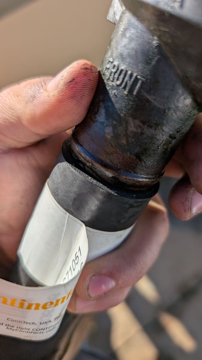

ElliotV Posted January 11, 2025 Report Share Posted January 11, 2025 Does anyone know where I can get a properly sized upper radiator hose for a 85 4x4. Mine is 38mm and any that I find are 32mm. When I installed my inline temp gauge to keep a eye on coolant temps I originally ordered a 32 and it didn't work and a 38mm did. Everywhere I look has the same part numbers for a 32mm or 33mm hose. Quote Link to comment
datzenmike Posted January 11, 2025 Report Share Posted January 11, 2025 That's 1 1 /4" and 1 1/2" Quote Link to comment
ElliotV Posted January 11, 2025 Report Share Posted January 11, 2025 (edited) 4 minutes ago, datzenmike said: That's 1 1 /4" and 1 1/2" Yes that's just what the ones I found listed were metric and the adapter I ordered was standard Edited January 11, 2025 by ElliotV Quote Link to comment
ElliotV Posted January 13, 2025 Report Share Posted January 13, 2025 Yep wrong diameter hose. Quote Link to comment
datzenmike Posted January 13, 2025 Report Share Posted January 13, 2025 Tight pushing it over the beading but wet it and give a good push. 1 Quote Link to comment
ElliotV Posted January 13, 2025 Report Share Posted January 13, 2025 Just now, datzenmike said: Tight pushing it over the beading but wet it and give a good push. Maybe if I end up pulling the thermostat again I can give it a try but I think I finally got it to stop leaking after replacing the gasket. Hose doesn't have any tears and I replaced the clamp with one that won't cut into it like the oe Nissan ones. 1 Quote Link to comment
