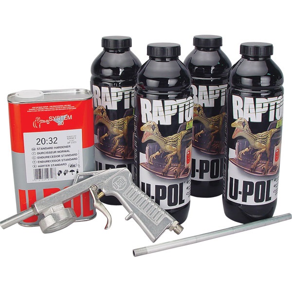

cw240z Posted November 28, 2015 Author Report Share Posted November 28, 2015 I really like the factory look of having the underside of the car textured in the body color, similar to how this 240z was done After searching what was out there I came across this tintable bedliner kit from U-POL. It comes with everything you need to spray, just add 10% of your choice of color to the bottle. After several long nights of media blasting the underside of the car and applying a POR-15 rust inhibitor primer, the four bottles of Raptor liner covered just enough to do from the firewall to the trunk. It lays down very easy on the car and you can always go back over it to get an even texture or to spot in a scratch in the future. It's also a very messy job, I wouldn't recommend doing it in a garage, or even a paint booth. Quote Link to comment
