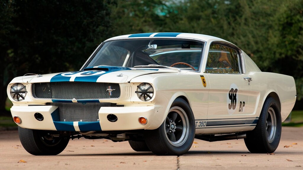

UnderControl Posted February 13 Author Report Share Posted February 13 Threw a tape across my strut rods and they're a good 1" off of each other so I'll have to get the suspension adjusted a bit before I worry about the arches. For today, I got the passenger side fender wiggled into place so I could drop the rest of the front end on. mostly for giggles, and partly because I had to move it to get at the bumper anyway, I clamped the Camaro lip I have laying around on there. At this point I think the original plan of adding a hole to the valance is the play here. Not within the current scope, but the gap between the bumper and the body bothers me. 2 Quote Link to comment
datsunfreak Posted February 13 Report Share Posted February 13 By "hole", do you mean like one of these guys? Quote Link to comment
UnderControl Posted February 13 Author Report Share Posted February 13 Something to that effect indeed, but I'm going to be keeping the bumper. 1 Quote Link to comment
