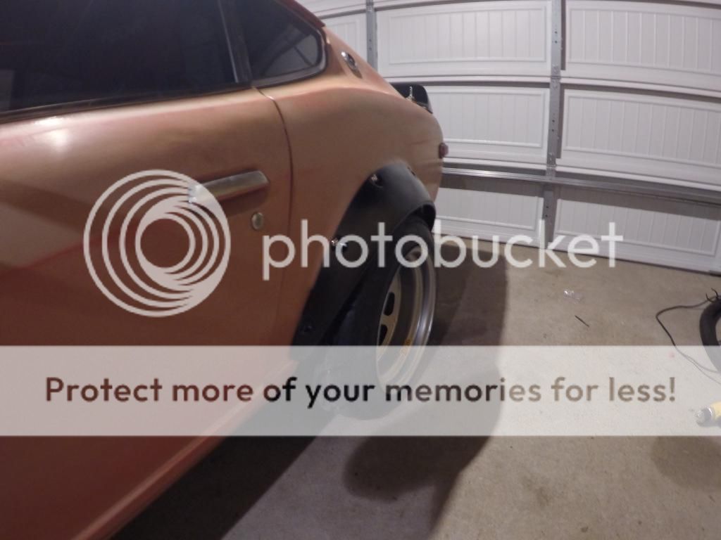

First I drilled the holes in the flares with a 1/4 bit. Then I lined them up where I wanted them on the fenders and held them in place with painters tape. While I had them lined up I marked the fenders with a sharpie where I needed to drill the holes. The flares came unpainted white so once I was done mocking everything up I prepped them for paint. I went with a satin black paint which I think looks good. In between coats I started measuring and prepping to attach the spoiler. The spoiler already came pre painted in a satin black so it already matched the look I wanted with the fenders. It actually worked out nice because where the holes needed to be drilled in the hatch there were rubber plugs on the underside of it perfectly lined up. I love when things work out that easy. So with a few simple measurements, two drilled holes and a size 11 socket I had a spoiler installed.
So I got the flares on now and they went on pretty easy. I'm really happy with what they did to the look and the stance of the car. It got rid of some of that ugly wheel gap. I am eventually going to go with a set of coilovers to bring it down a little lower and tighten up the suspension a tad bit but it already is on some Tokico springs that bring it down a little and surprising do a lot more than I thought they would performance wise. Overall I couldn't be happier with the way the work yesterday turned out. Sorry for some of the blurry pictures! All that drilling in body panels had my nerves shot and my hands were definitely a little shaky afterwords.
