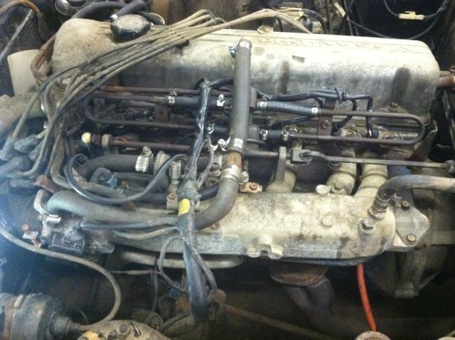

After cleaning up the ground changing fluids, and giving everything a once over I decided to start it. Turns out the fuel pump was junk, so my friend gave me one off a saab 99 that I adapted to fit. After a very very long time of fooling around, and firing the injectors manually and such I got it to fire. It would start up and move around, but not that great as the clutch salve was frozen and it was only running on 4. I did a compression test, none on 1 and 3. Turns out the vlaves were sticking. During this time I replaced all the brake lines, front rotors, calipers pads, repacked the front wheel bearings, replaced the clutch salve, brake master cylinder, all the rear brake parts so eventually when I have it running it will pass inspection. This brings us up to date
After doing everything I could to get the vavles to come into it they were still sticking. I pulled the head off last week. I was cracked between 4 of the valves, so I pulled the head off the other car it has the emissions liners in it, but I'm going to rock it because I have it. I ordered new valves, timing chain, and gasket set so now after I send the head out I will be ready to put it back together. I also pulled the good fender off the other car, and all the five speed stuff so I can swap it all over. There should be more to come soon!

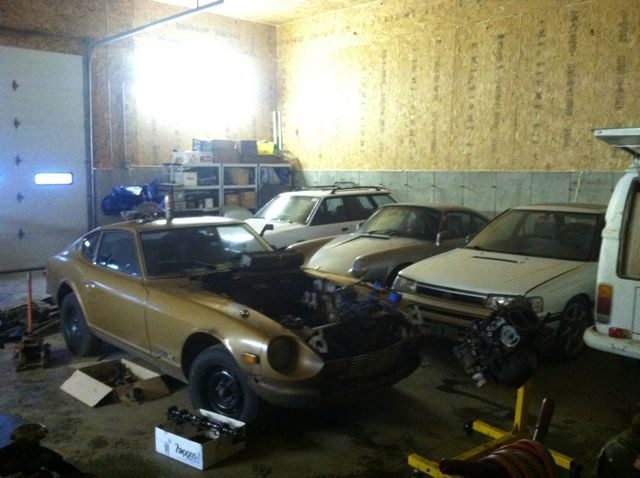

I want your garage...

Thanks man, the garage is awesome, I'm there all the time, and the pic only shows half of it B) I really like this car, my plan is to keep the blue one around for a while, you never know what you may need while putting something together. I'm not too worried about the head, it will work, I'm not worried about power on this build, I have my legacy turbo for that, just something fun to drive around that is rwd!

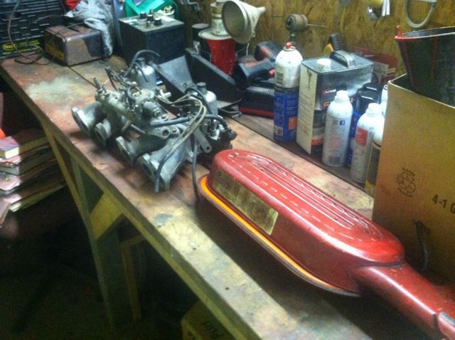

Went to NH yesterday to pick up some parts. Got to meet a pretty cool dude, with some very cool cars. We got to talking for a long time, and I bought some pretty sweet parts for this old girl. I have a set of factory 72 carbs now, a new center console, and I picked up a pair of rust fee perfect fenders, which I do not have the heart to cut up. So I guess my plans for flaring it are over, or at least for the front... No pics of the fenders yet. I spent most of the day cleaning up the head. It will breath a bit better now. I'm now looking for a cam to run with this, anyone have a recommendation for a mild cam? Up next it is time to start putting the engine all back together, after a bit of paint work.
Looks much better in person than it does in the photo. I gasket matched it, and used several bits to get it all pretty smooth. I need to do the intake now as well.

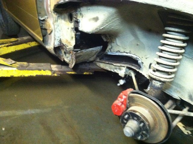

Work was slow today, so I decided to take half the day off, and come home and work on the Z. I got a decent amount of the rust repair done. I cut all the rust out on the front inner fenders, and I started welding up the drivers side. Still have a ton more cutting and welding to do, but it is getting there.
Everything cut out
Welded, I still have to box in the front of the rockers, but I was getting tired and hungry, I'll do that another day. Obviously I need to grind it down as well, I primed it to keep it from rusting over the next however long until I get back to it.

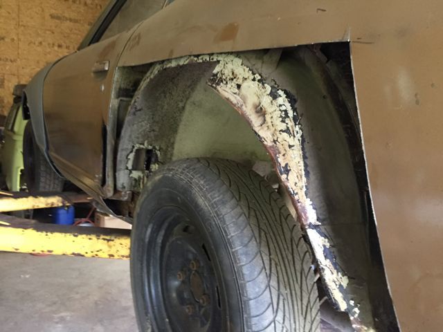

Well this projected died for a bit, something about buying a house, and moving really cuts into the time for your project car(s). Did a bunch of cutting and welding this weekend. Decided I do not want flairs, this car is going to be fixed and painted, I had the rear quarters already they came with the car. This is more work, but i think I will like the outcome better than hacking the rear quarters up, and slapping some flares on.
Fixing several layers of steel on the passengers side
rebuilt the inner arch
