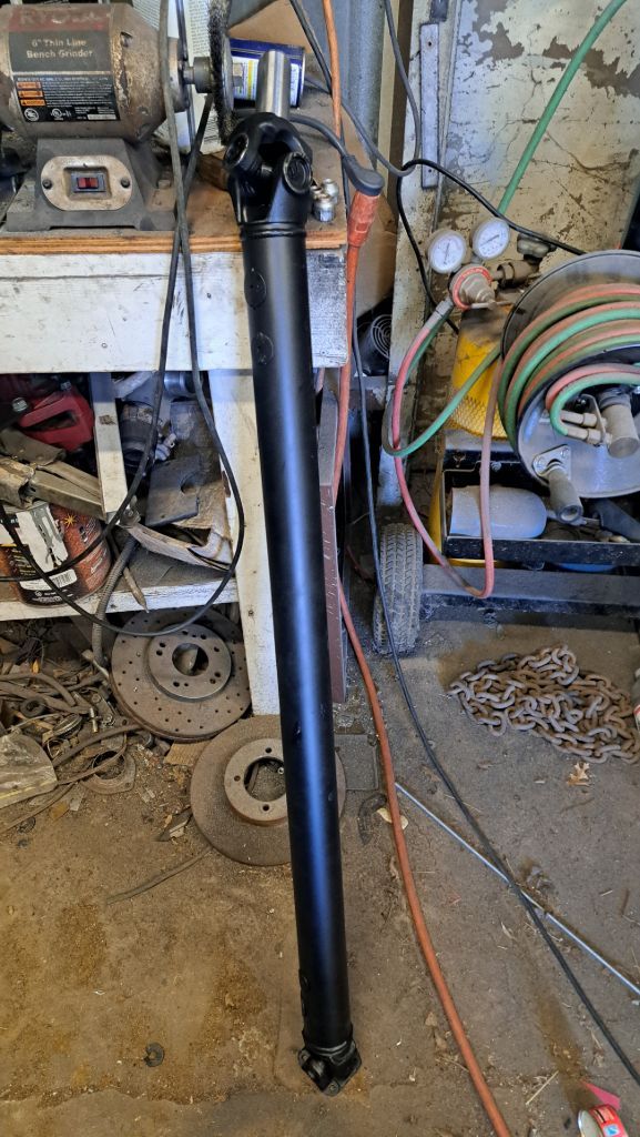

We finally have all the bits to have a driveshaft built...
because, in addition to having non-serviceable joints, as the bishop said to the actress, my old shaft is just too long...

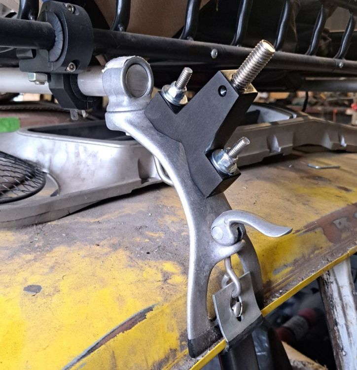

Then we had a look at how we could make a sway bar for the front...
We decided that we could do something similar to what the factory did on the rear by hanging a bar from the T/C rods...
where the yellow line is.  We made a template...
and will have some spring steel rod bent to this shape.  That will attach with the patent pending, Dimlight Racing Method...
So stay tuned!
Edited by dimlight65

...will have some spring steel rod bent to this shape.
This I did...
then bought four sets of sway bar bushings with saddles for it...
and bolted the bar to the T/C rods...
It turned out WAY better than it had any right to...
A quick bounce on the fender showed a remarkable improvement.  I am quite chuffed with this.  We're going to paint it and the rear bar gold to "match" the T/C rods and rear control arms so I can stand back, point to them, and go, "Eh? Eh?  Didja see the sway bars?"

I picked up the driveshaft yesterday...
crawled under the car and installed it today.  You've all seen an installed driveshaft before (and I forgot to take a picture) so use your imagination.

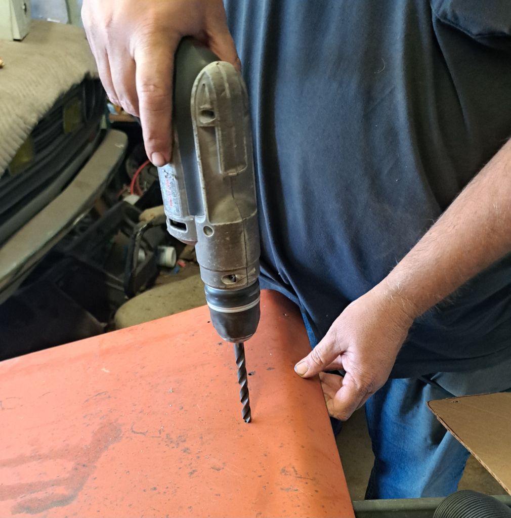

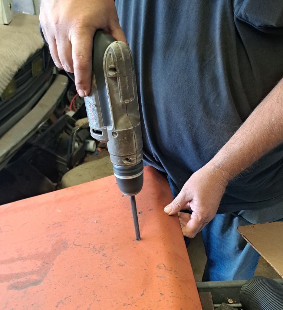

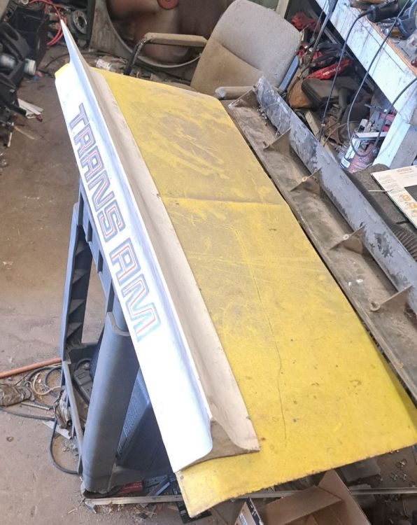

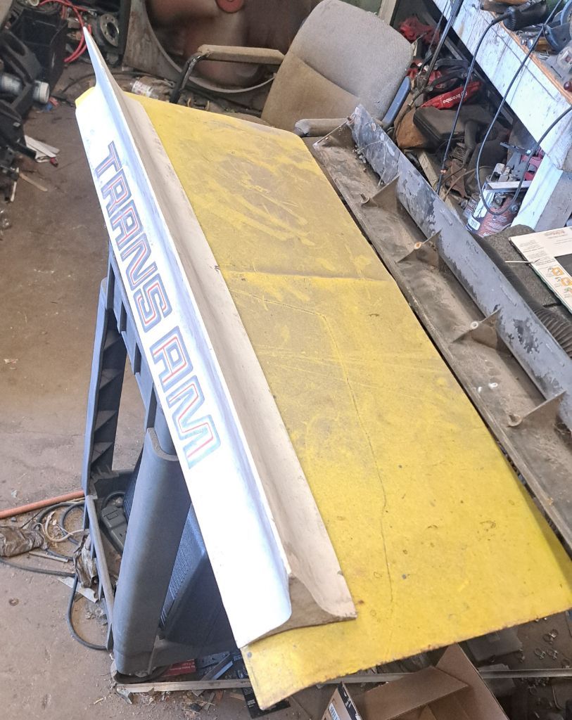

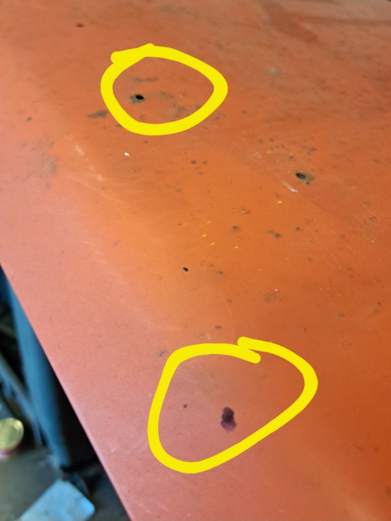

Then we took a trunk lid with a Hugh Jass dent in the middle of it...
marked some spots...
asked each other, "Are you sure?"...
confirmed that each one of us was, in fact, sure...
THEN, after the holes were drilled, we broke off half of the hinge bolts and had to start over with the car's original lid.  Thus producing...
I am 99.28734165% sure it is centered and that is a camera artifact.  We'll fill in the gaps and glass it all in proper later.  It's a shame the Rhino-Liner is going to cover that bitchin' Trans Am decal.
  • Like 4

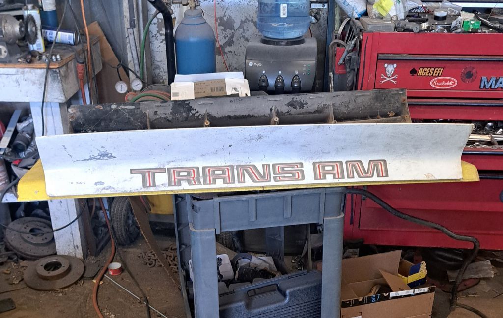

On 5/19/2026 at 6:29 AM, iceman510 said:
Noooooo, don't cover the decal.  Chickenhawk, Firehawk, Firebird, TransAm, it all fits together.
You could get a new one made up... maybe even saying ChickenHawk
Edited by EDM620
added
Ironically, I was working for a race team running a Firehawk car in the early 90s when this car was originally built.  The "Chickenhawk" windshield banner was done in the Firehawk font for that very reason.
