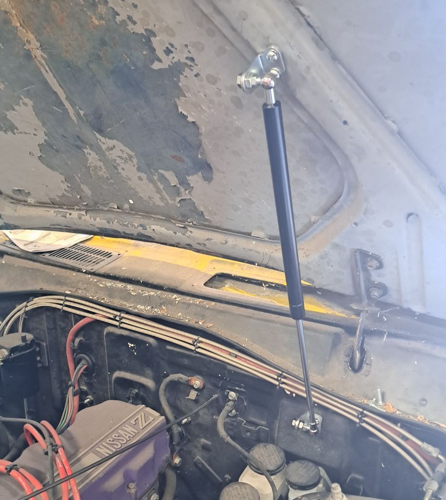

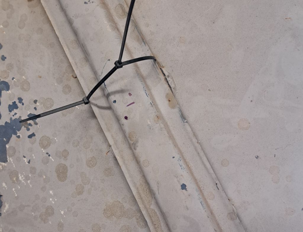

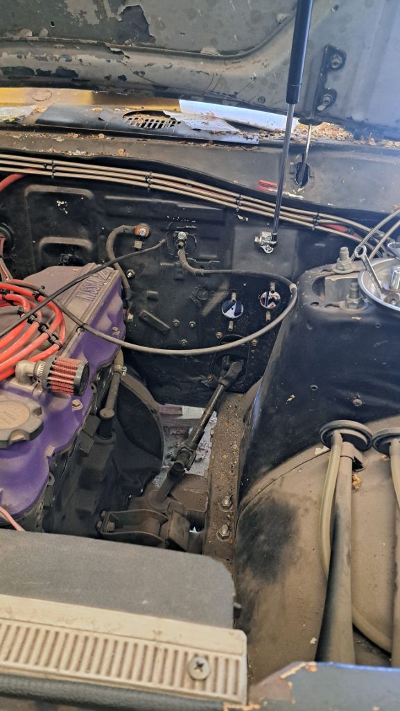

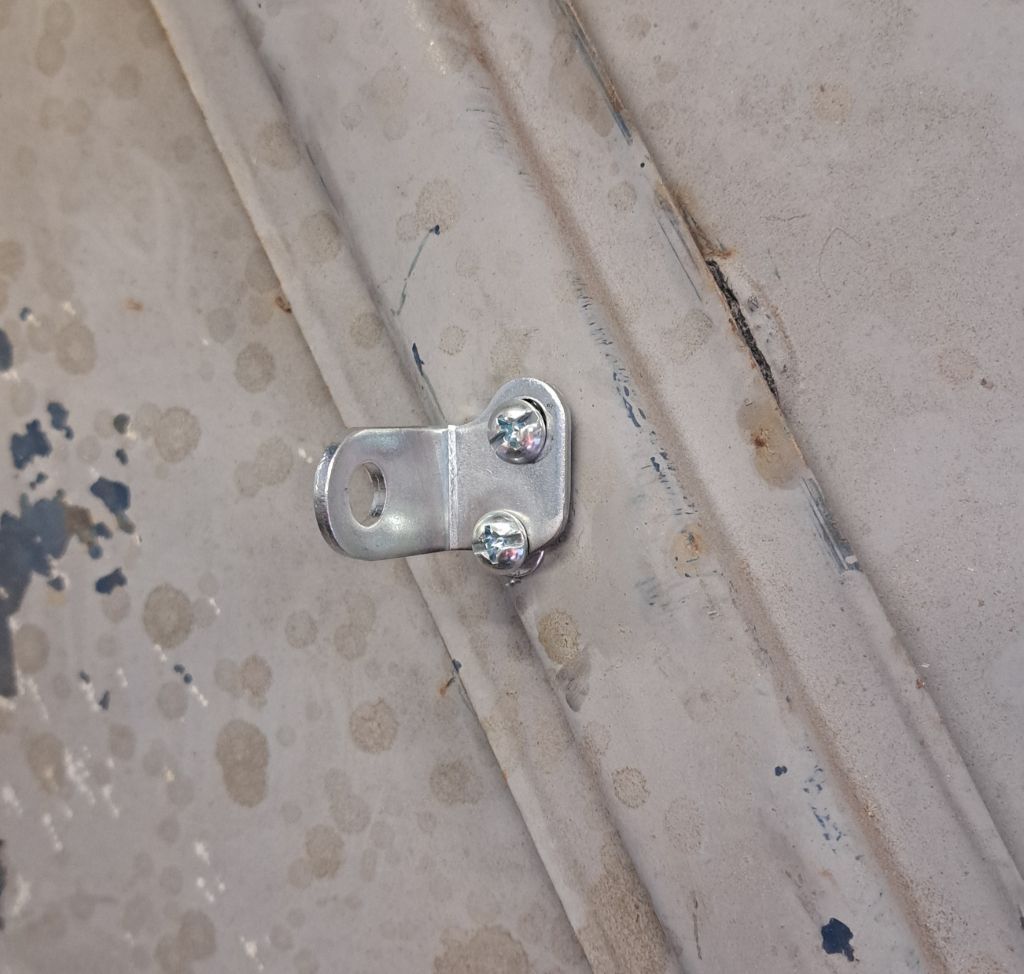

After the success of installing a hood strut on the Dajiban, I decided to use the other strut from the kit on the Chickenhawk.

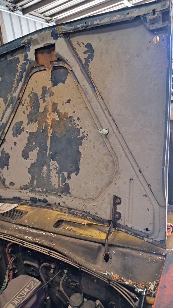

We decided that going from the firewall here...
to the hood here...

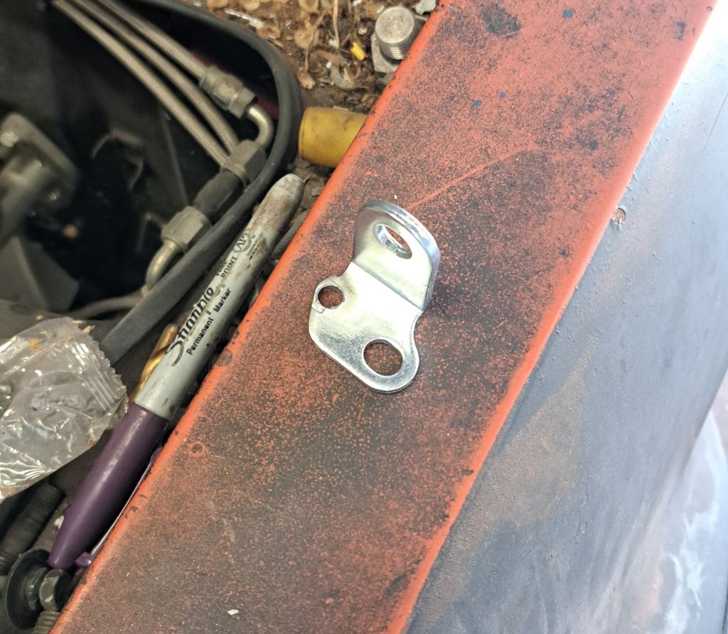

should work.  I cut down the bracket for the hood end...
then nutserted the hood and installed it...
For perspective...
Then I nutserted the firewall, cut down the firewall end bracket, and installed it...

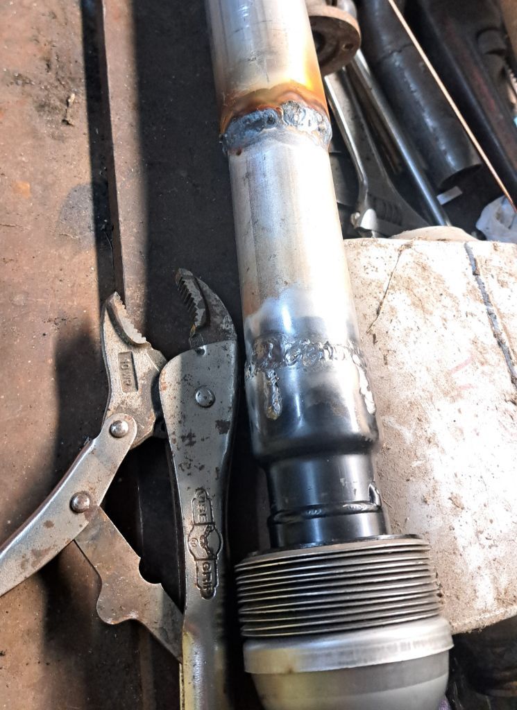

Finally, I installed the rod...
Yeah, I know I installed it upside down.  That's... um, to... put... the weight of the cylinder... on the hood end?  Yeah, yeah!  That's totally why I did it that way!
And a ubiquitous video of it in action...
It's just a tad too strong right now, but once we add the weight of the bed liner paint job, I think we'll be golden!

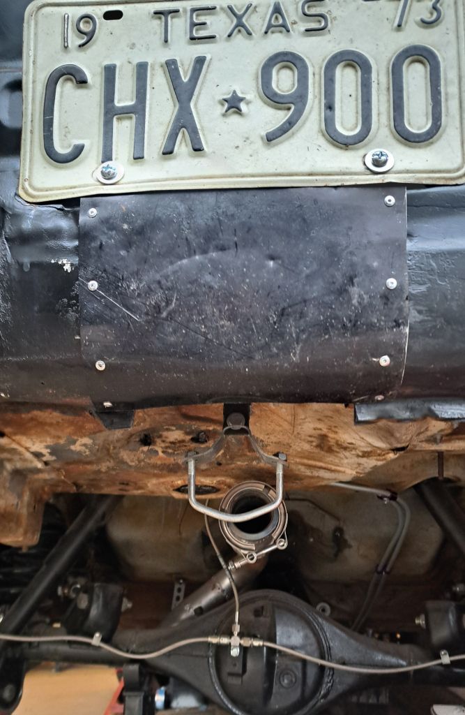

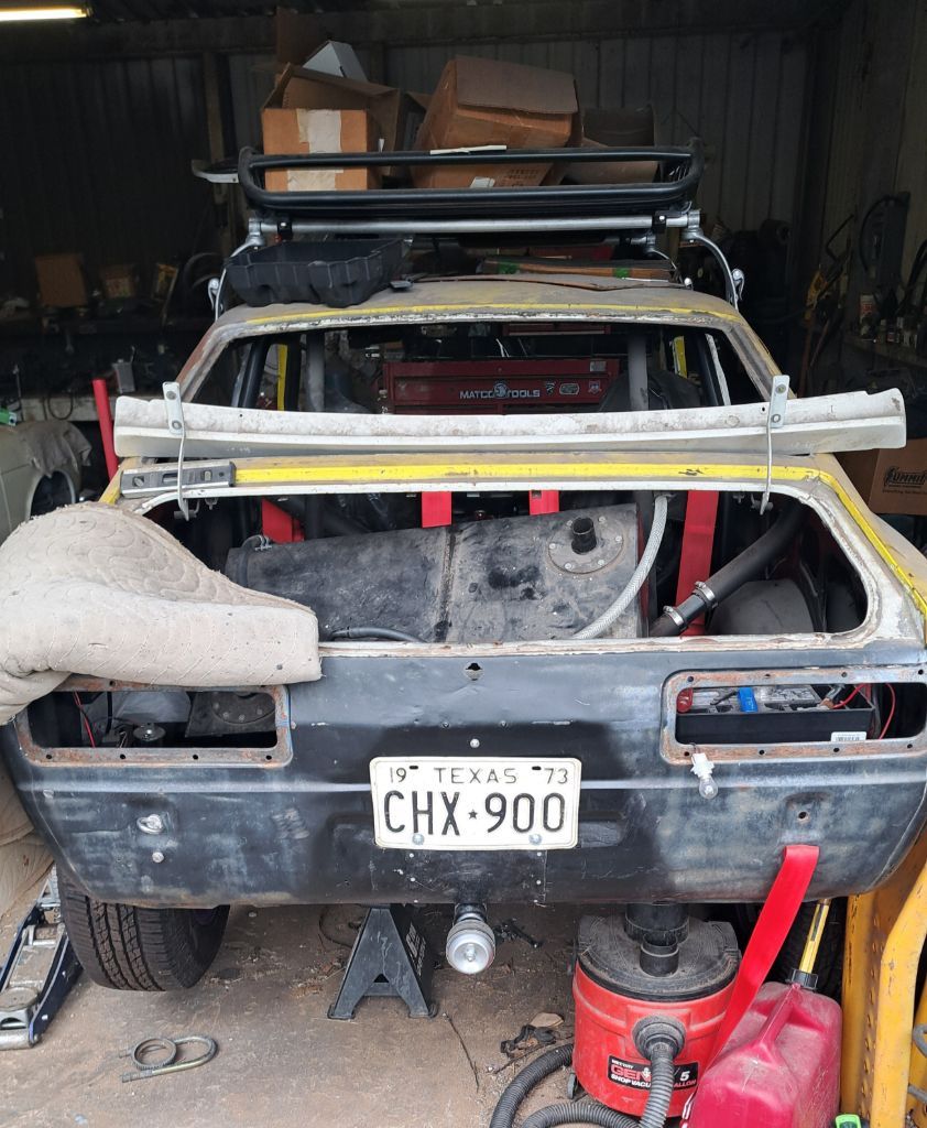

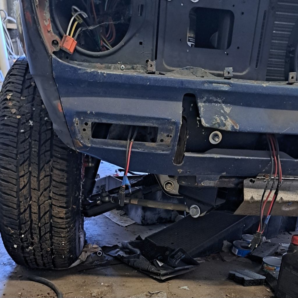

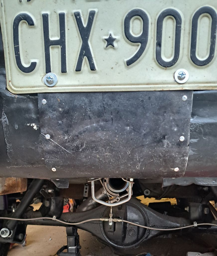

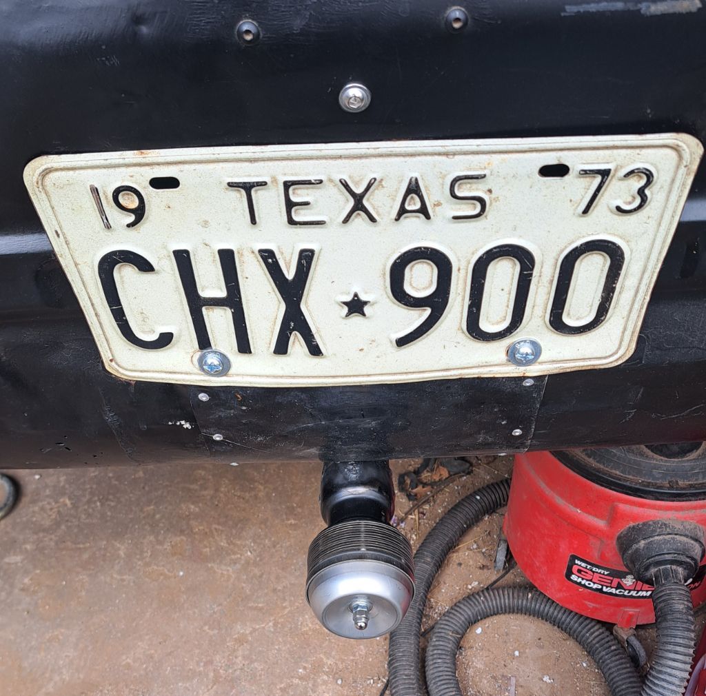

I didn't like the cutout someone made in the lower valance back when we were still planning on being slammed in the weeds.  Today I decided to do something about that.  I took some malleable aluminum sheet and...
Then I zooked up a different stinger...
because the car used to have a Supertrapp spark arrestor and I wasn't happy with the crooked oval tip...
I think it is far enough out so it won't smudge up the license plate...
but only time will tell.

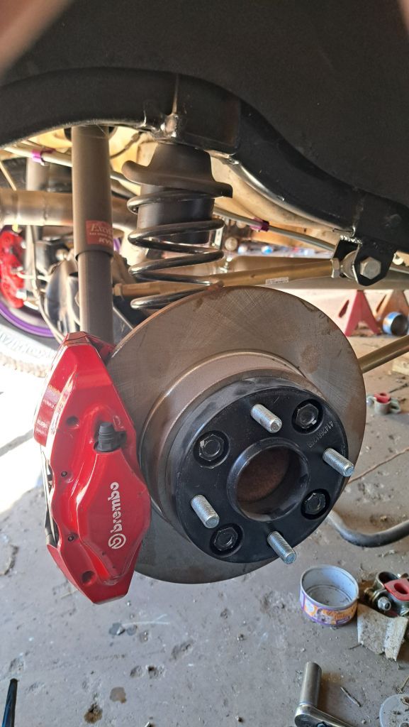

We finally got around to installing the right side rear caliper today...

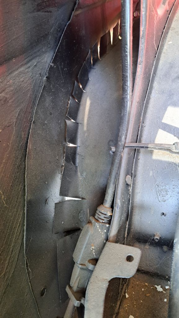

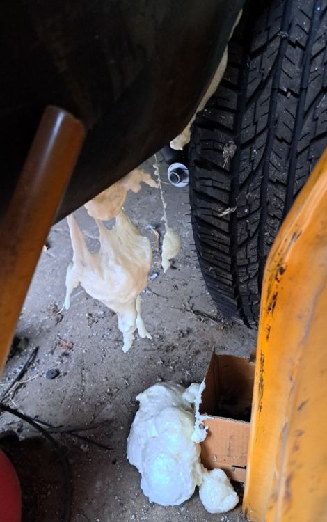

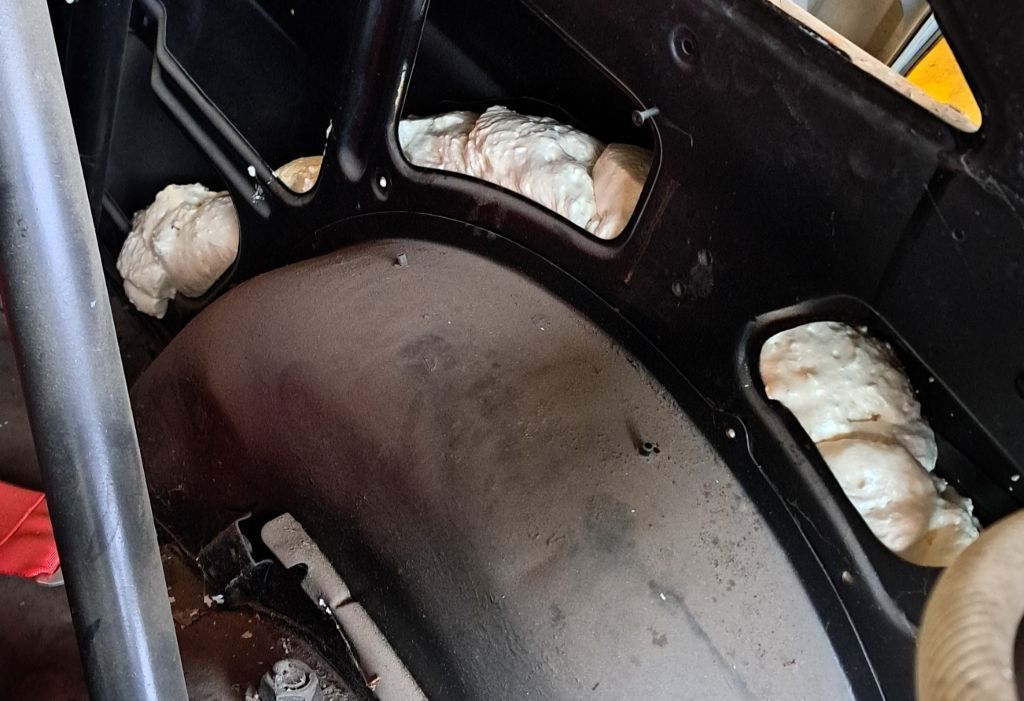

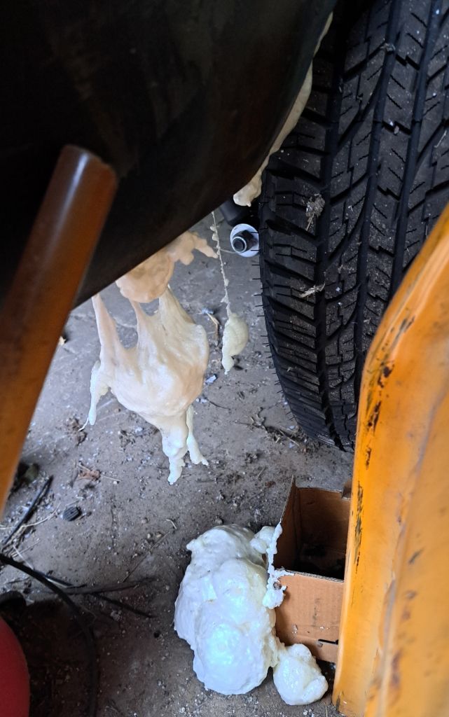

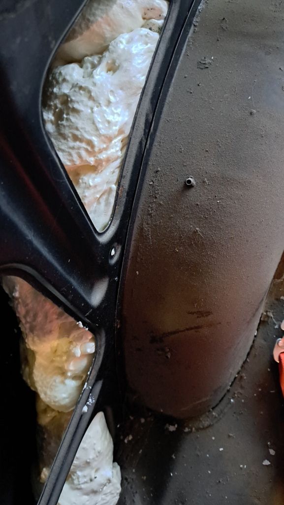

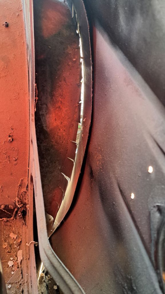

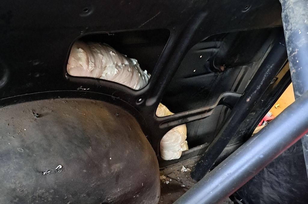

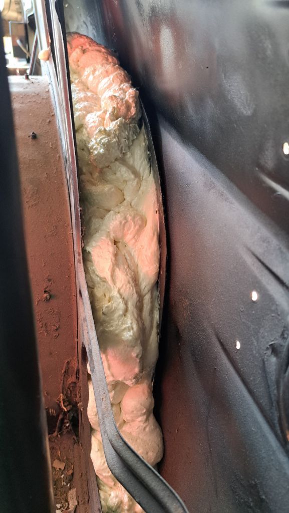

Around 30 odd years ago, some hillbilly* put fender flares on this car and added some ghetto-assed "tubs" to fill the gap left when the arches were opened up...

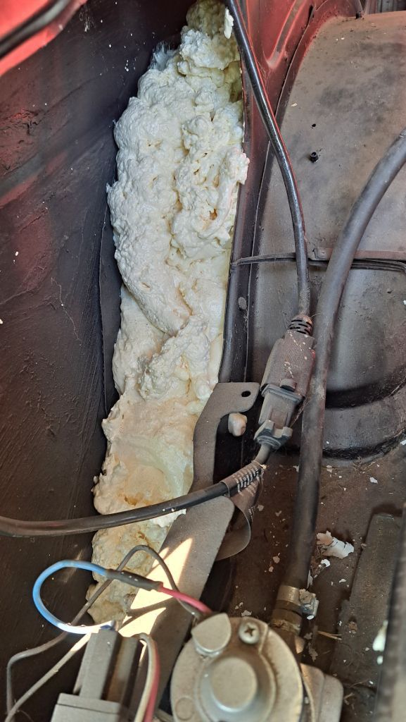

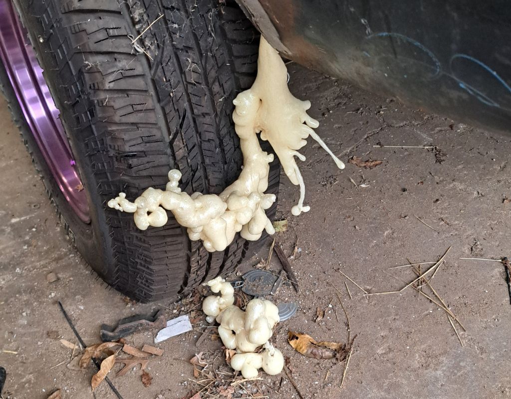

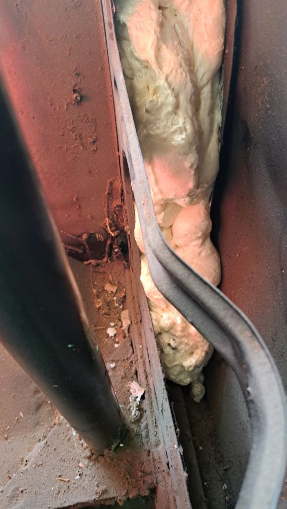

Well, I decided that those gaps needed to be filled.  I bought four cans of...
and filled them up...
I did both sides, but only took pictures of the driver's side for some reason.  I'm sure John will hit them with some black paint once they are good and cured.

20 hours ago, Rustbin said:
I had such a hard time trying to remove that spay shit from my buddies 71 Riv to be able to fix some rust that I cringed when I saw your pics of it. I hope you never have to try to remove it. Keep working on the revival.
Yeah, I got some on my arm and it is very tenacious.  Hopefully a) I will never have to remove it and 2) if I do, the dust, dirt and schmutz I didn't clean out of the fenders will limit the tenacity.
Just an FYI. This stuff holds moisture. If you drive in the rain or snow it will absorb moisture and rot the metal from the inside out. I filled my rockers with this stuff in my 510 many years ago and am now in the process of removing it all and the heavily rusted metal in the inner and out rockers. Not fun..
The current plan is to seal the tire side of this with something, then undercoat over that to keep moisture out.
But also, I know it will never see snow, and only barely see rain.  👌

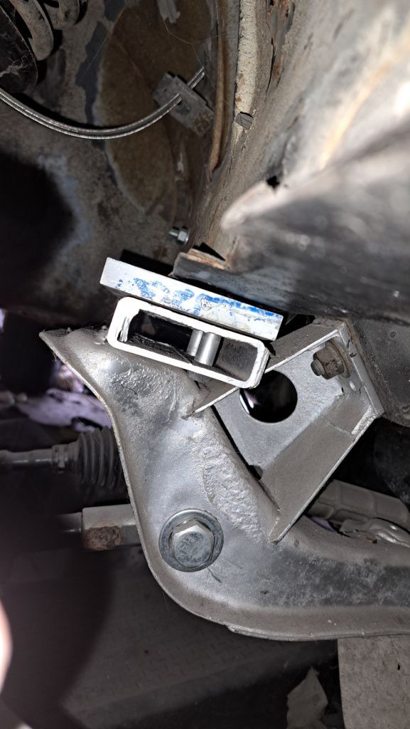

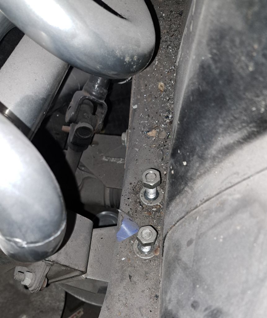

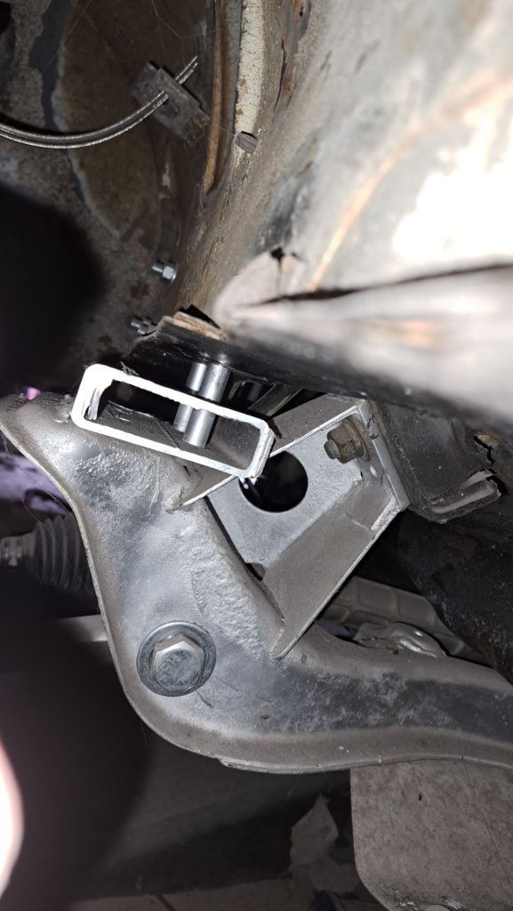

We were looking at the relative angles of the steering links and the lower control arms (as well as the slight positive camber it still has)...
and decided that a pair of 1/2" spacers between the cross member and frame should even them out.  (As an aside, we met shop stray Owen in the Dajiban thread the other day and I mentioned her Evil Twin, Edie.  This is Edie)...

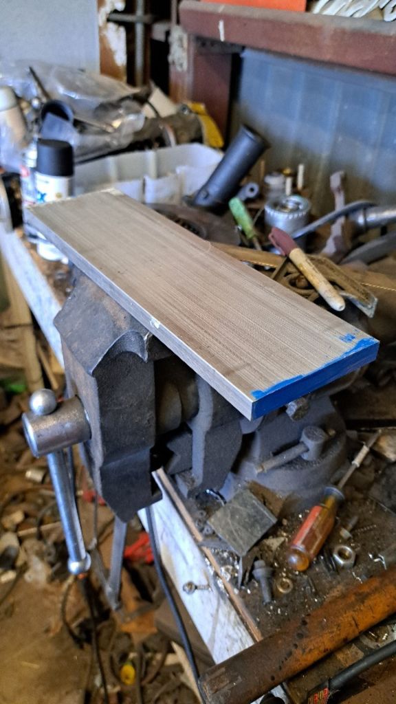

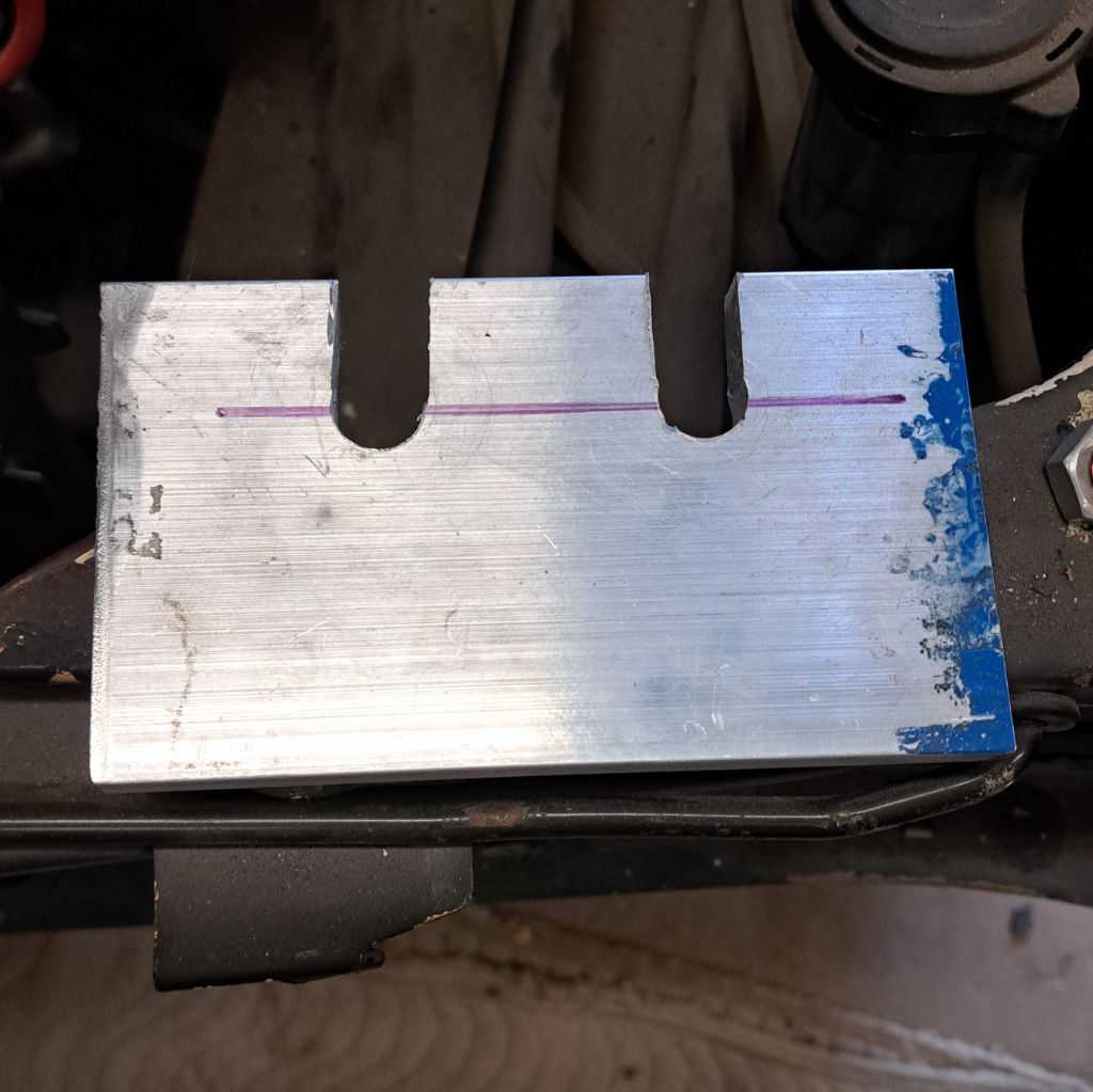

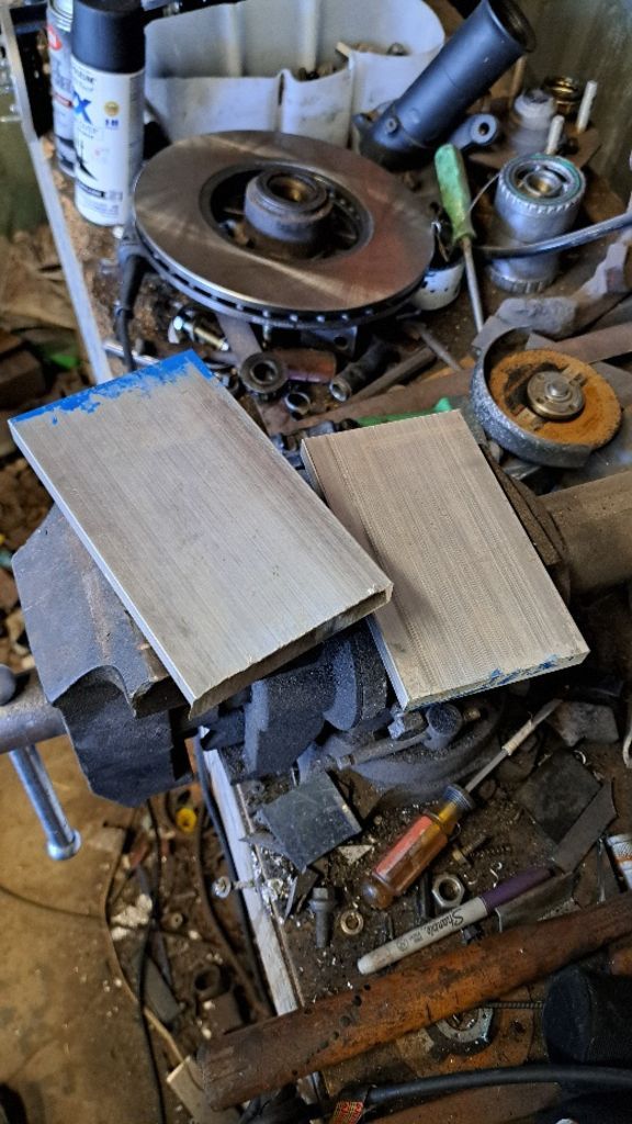

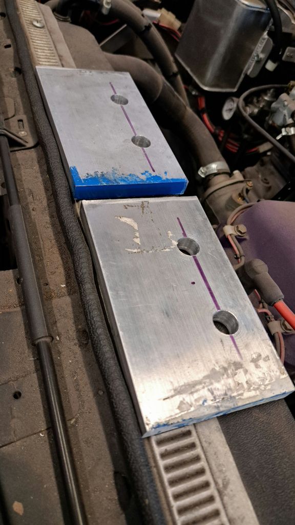

Ok, back to the narrative.  We figured 1/2" of spacer would even out the angles, so I bought some aluminum...
cut it in half...

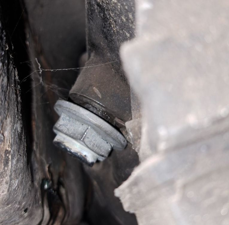

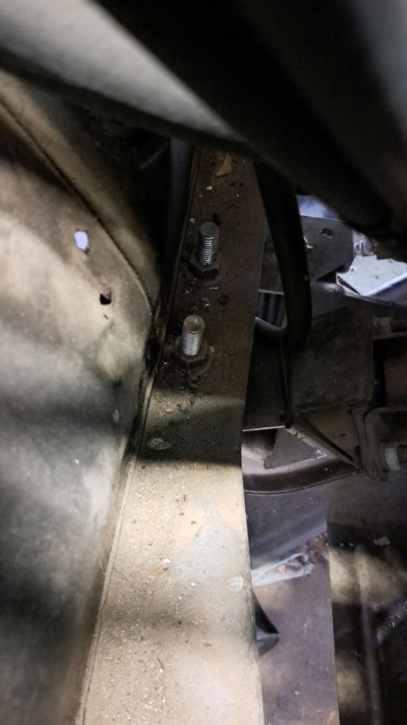

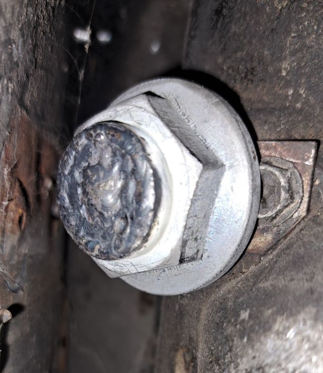

and then crawled under to get bolt spacing but discovered the bolts were welded into the cross member.  Crap.  Well, let's hope they are going to be long enough...
 20260322_103104.thumb.jpg.ef99672ec5ffb2e67b89dbbdc64ad2b6.jpg   20260322_103052.thumb.jpg.2c5ce6ea99536a1aa4d3f3675fb581a2.jpg
Whew!  Looks like I planned ahead without knowing it!  I measured the spacing and drilled some holes...
Now our concern is header to steering rod clearance...
I have some adjustment leeway at the column end...
hopefully it will be enough.  Since I was alone at the shop (except for the cats, and I doubt they would be calling my family if I dropped a 1200 on my head) I decided to wait for John before unbolting the cross member.

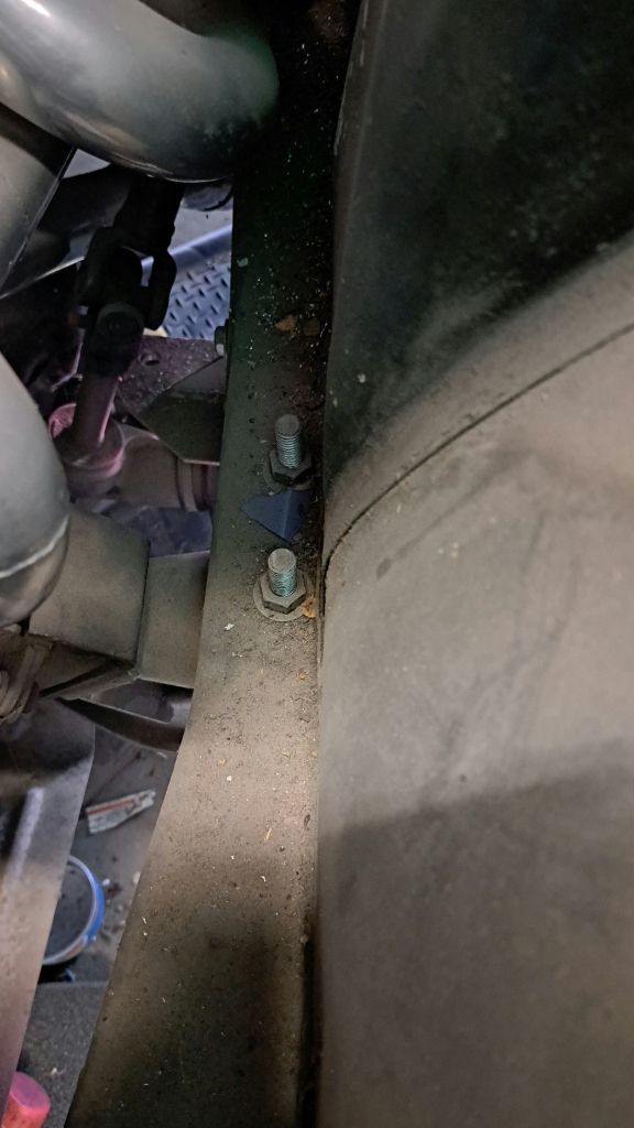

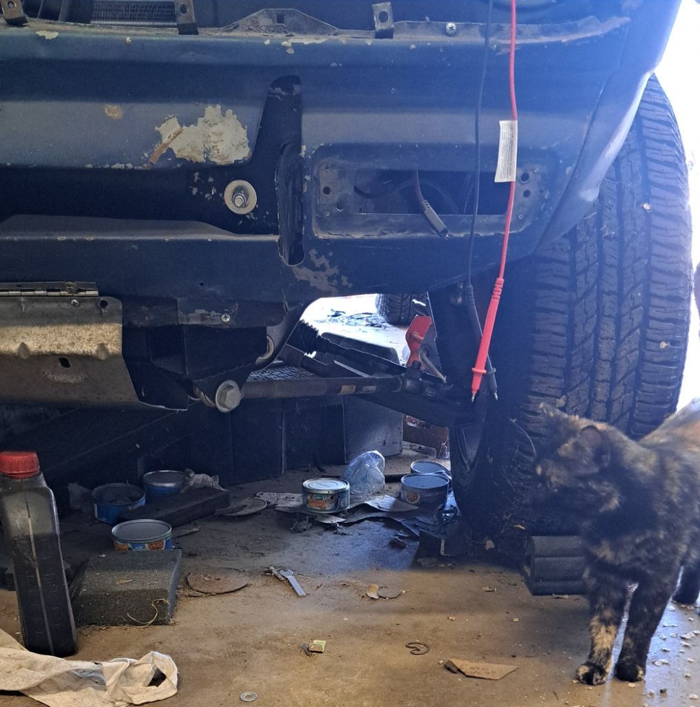

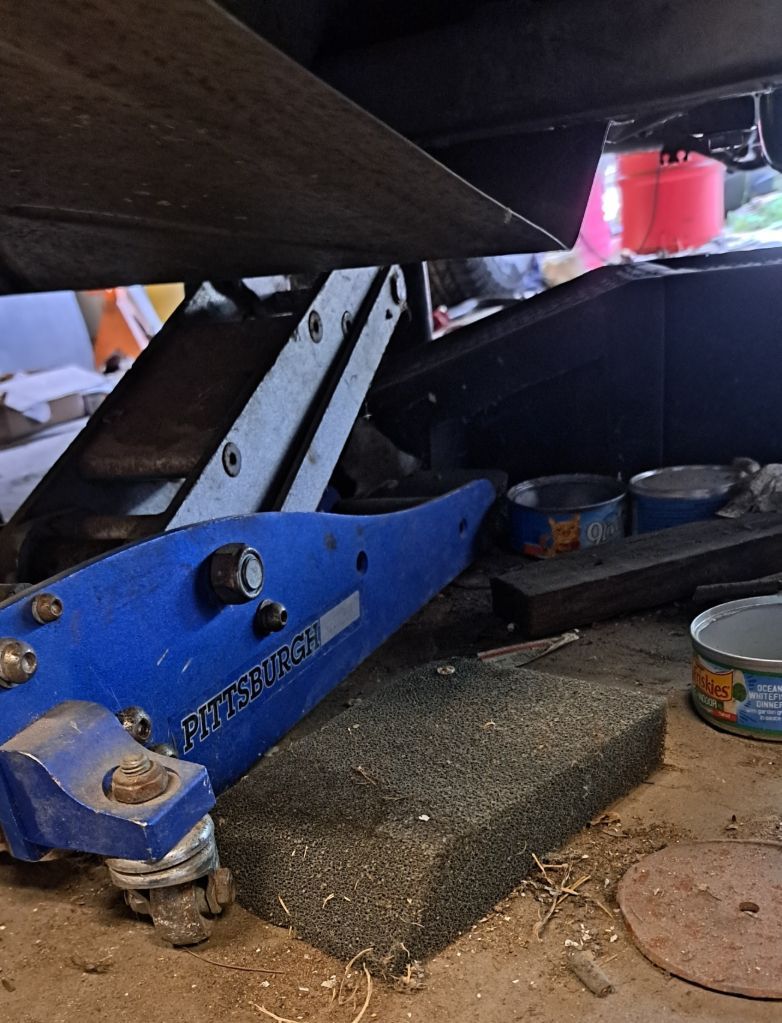

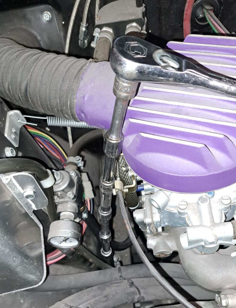

I was lamenting the "fact" that we were going to have to drop the cross member so much to get the bolts out of the frame in order to put on the spacers when John suggested...
So, with the threat of dropping a Z-20 on my head removed, I set the jack...
grabbed a ratchet, socket, and ludicrous number of extensions...
and loosened the nuts...
I lowered the jack a little and gave a bit of a pry to achieve...
space for the shims...

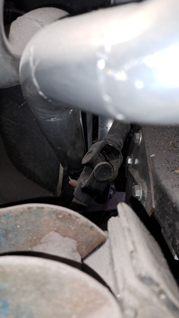

Then, with the nuts re-hunkered, I had a look at the steering clearance...
And we appear to be good.  YouTube video of it in action...
Yes, I did edit out the phone falling off the frame at the end.

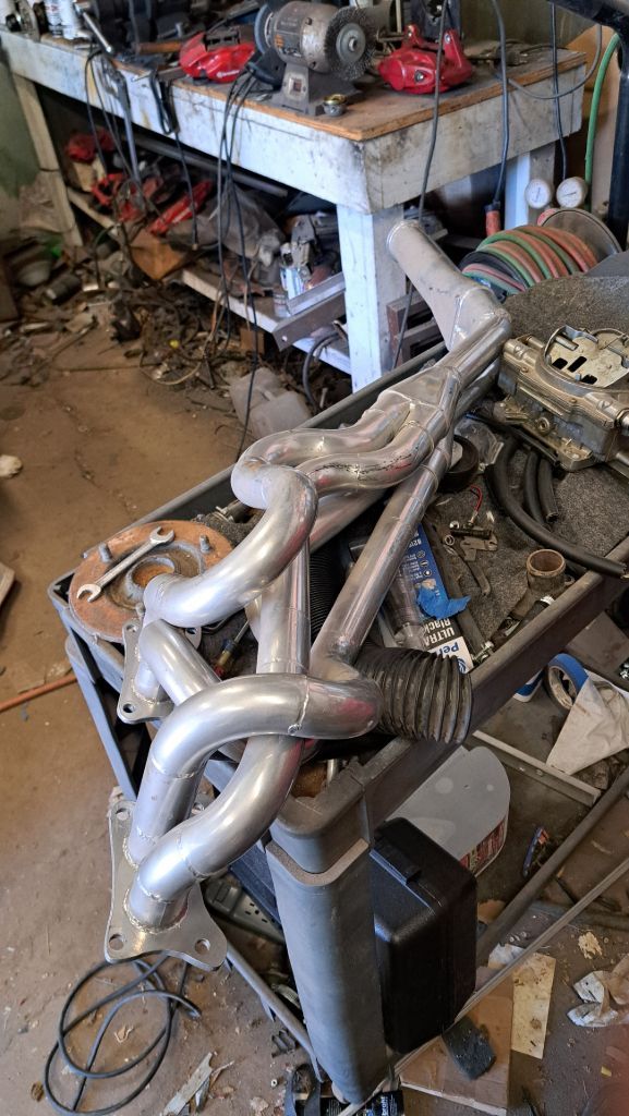

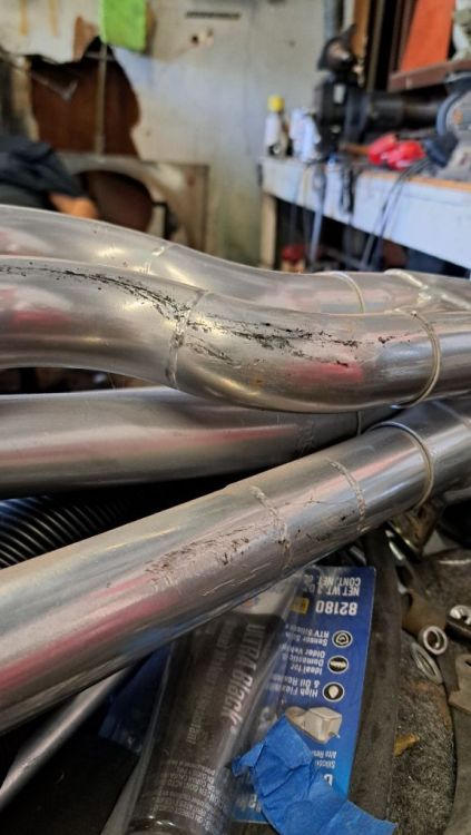

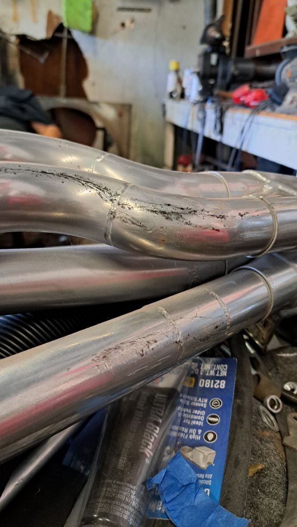

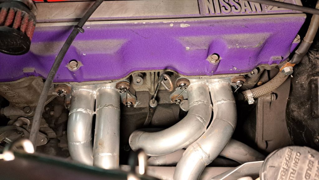

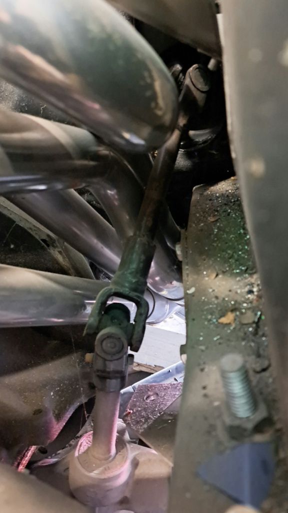

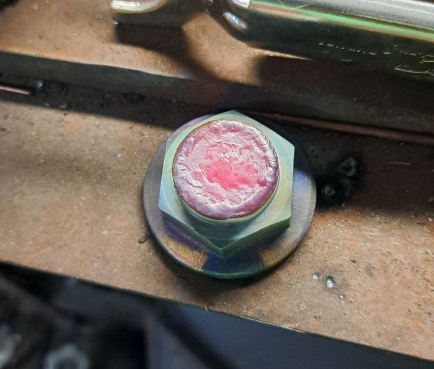

Well, we didn't quite have the clearance I thought we did.  The U-joint was scraping the header.  We wrestled the header out of the bay...
Hello, gorgeous!

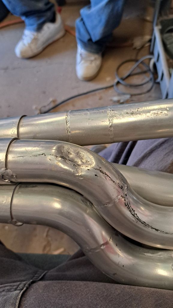

And we can see where it was scraping...

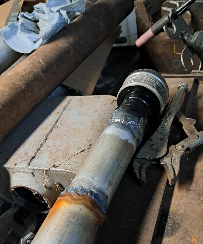

Now, I am not proud of this solution, but it gets us the needed clearance...
We did a temporary reinstall (I want to change the bolts out for ones drilled for safety wire) and gave the steering a test-tickle.  Of course I didn't take any pictures of that mainly because we dented the wrong pipe and had to take it out again to redo it.  NOW it works a treat.

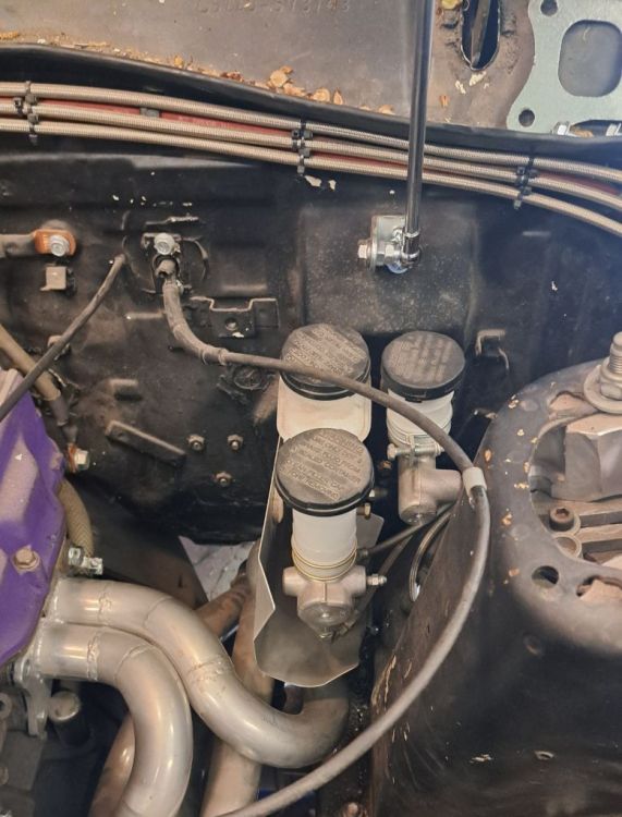

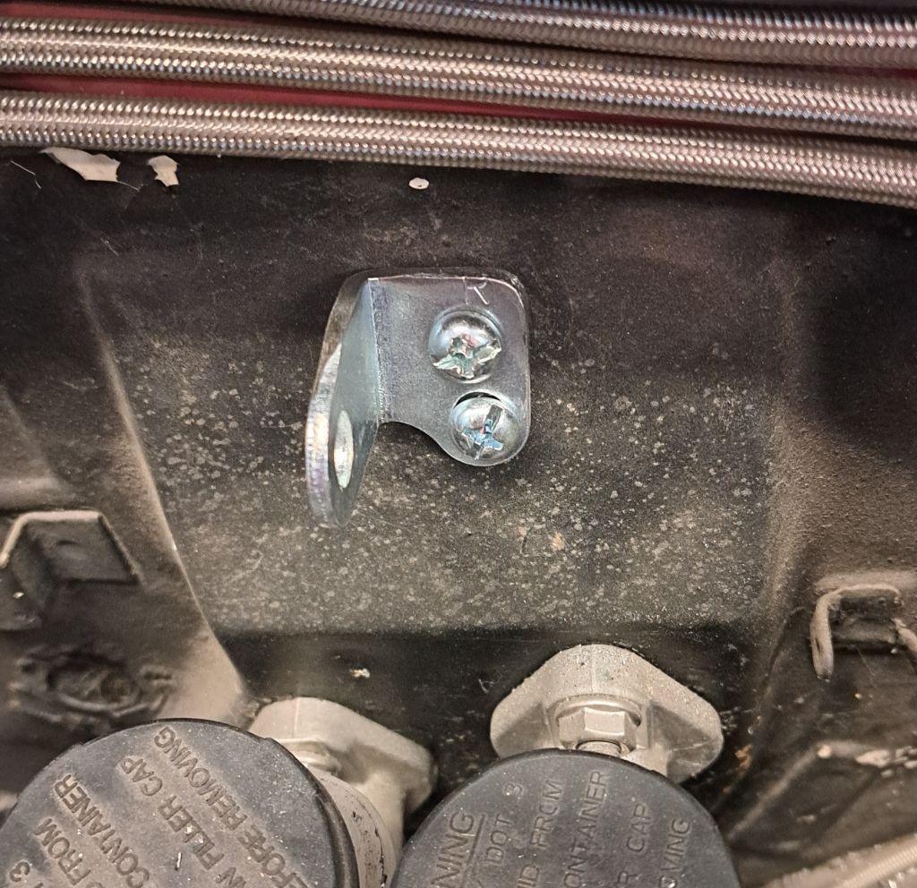

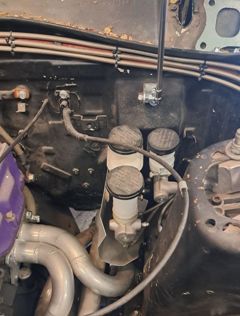

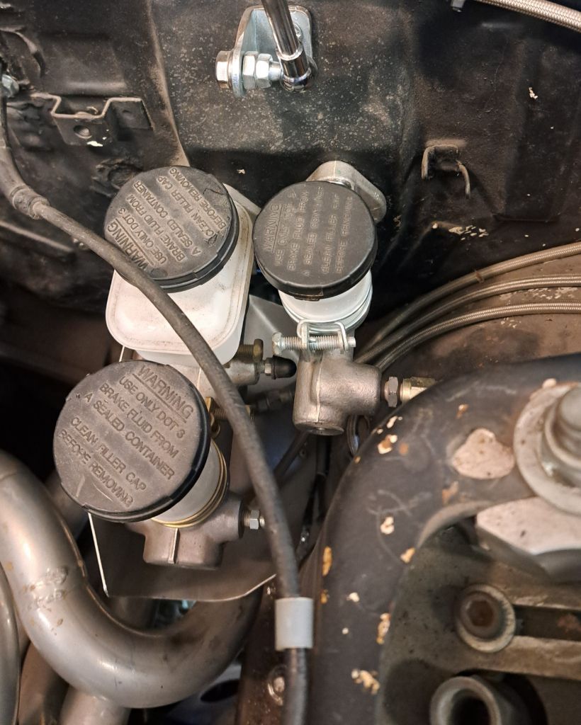

I finally got around to reinstalling the master cylinders today...
Wait, no.  That's the villain "The Master Cylinder" from Felix the Cat.
Here's what I did...
I still need to install the bolt at the bottom of the heat shield, but that's a two man job.

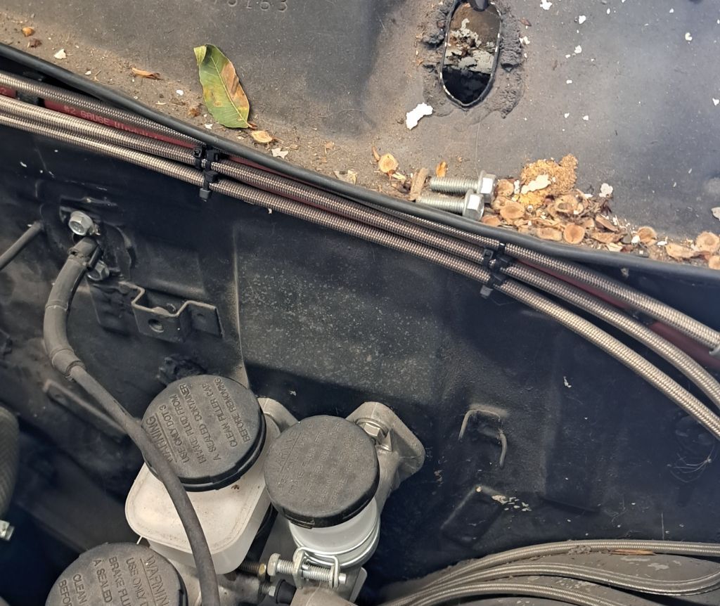

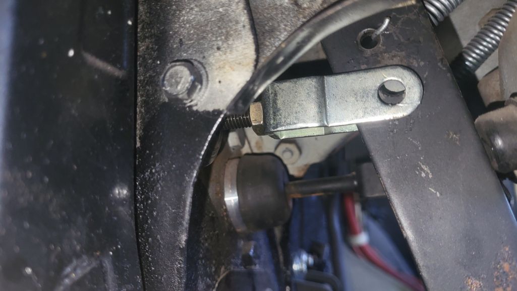

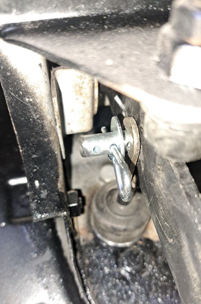

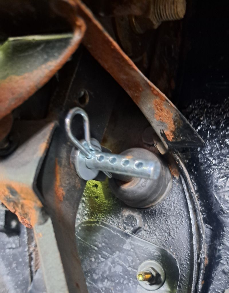

I popped a multi-hole pin in the brake clevis...
which was the fucker of all mothers, or so I thought until I tried to put the pin in the clutch clevis...
As you can see, I had to trim that one down to get it in, and it is still going to be a bit flollopy.

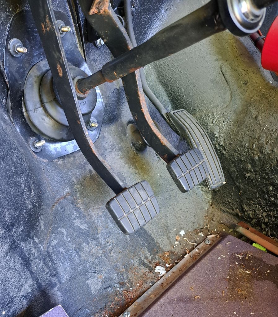

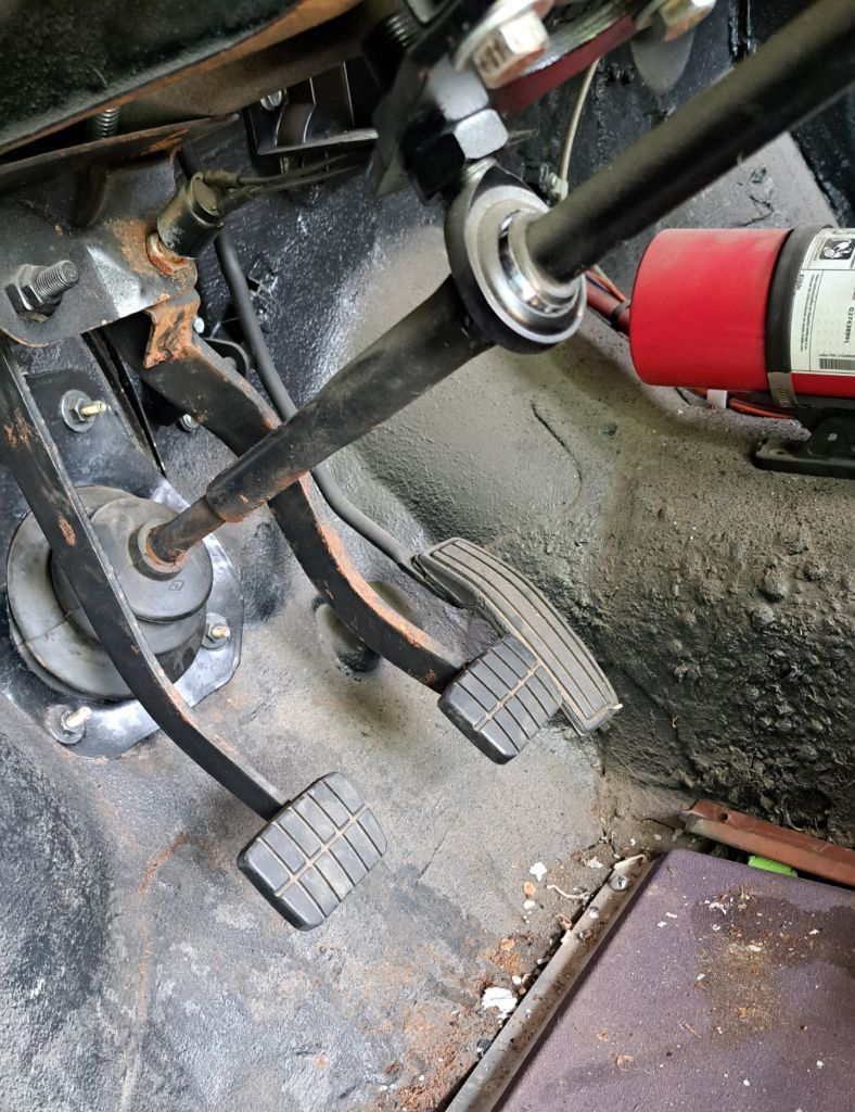

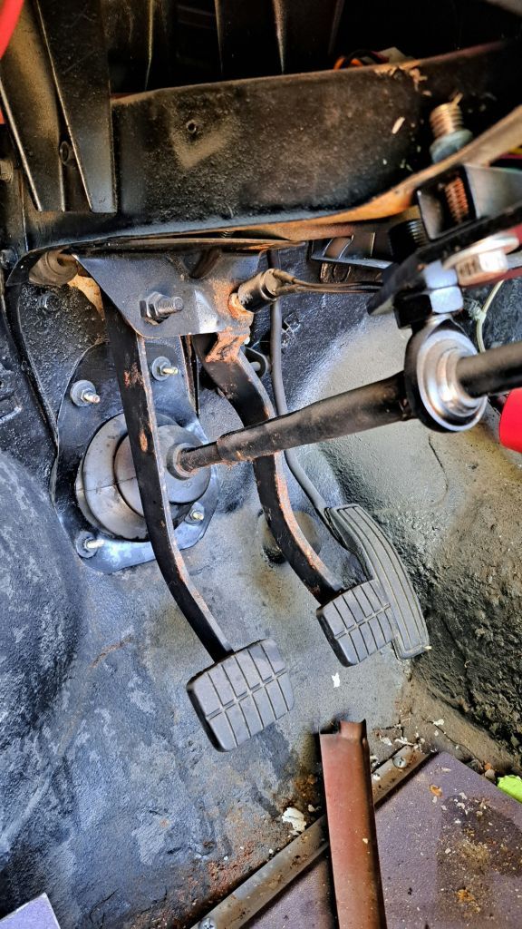

Then, when I stood back to admire my work, I noticed...
the clutch needs a longer rod.  We will have a look at that next weekend.  I was done at this point.
And at it we did look.  We grokked an adjustable rod that John had laying around, but it was WAY too long.  It was decided that we would cut the clevis off, and thread my... um, I don't want to say "rod" because we're all 12 years old here.  Oh, ok.  It was decided that we would cut the clevis off of my unit and... wait, that's no better.  Hmm...
Rather than do all of that, we're going to take an m8x1.25 button head bolt, thread the adjustable clevis onto it, and use that as our push rod.  We finger the button head should mimic the mushroomed head of the stock push rod and... do all the stuff that that does... sort of thing.

Spacing the cross member down is the same as spacing the body up by 1/2". Spacing the steering knuckle down from the strut would be preferable as it levels the tie rod only.
20260322_100528.thumb.jpg.182c3b5b50dffb
Hi Edie! This is Lea the most affectionate tortoiseshell ever. She has adorable bilateral asymmetry of facial colors.  As you probably know males are extremely rare and usually sterile, many tortoiseshells inherit polydactylism. (extra digits)
... and would make our angles worse.
Posted (edited)
And would result in either an uninstallable tie rod, or a bent one on the first dip in the road.
And probably result in a broken ball joint the first time we took it down a bouncy path.
The other issue that needed fixing was that due to the angle of the control arm, the ball joint was acting as our droop limiter. This is not a good thing. Moving the arm angle down gave us much more leeway here, enough that the ball joint should not be the limiter of droop now.

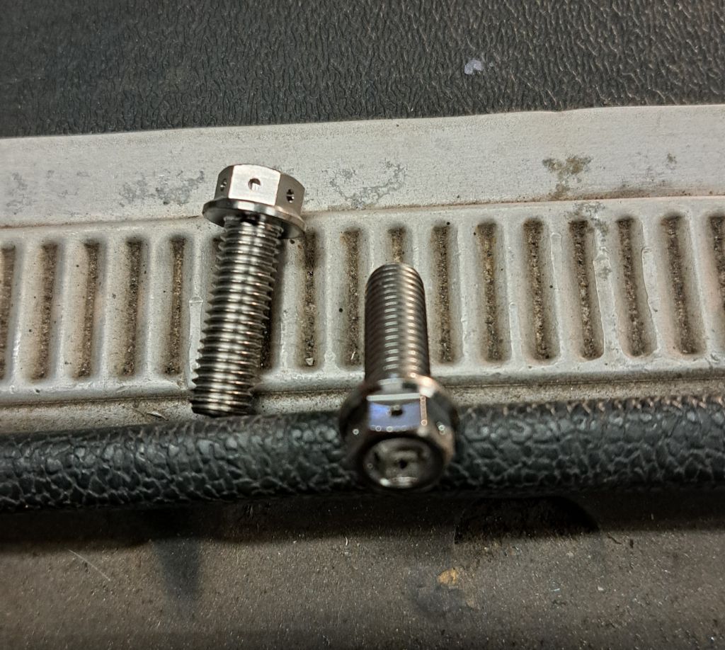

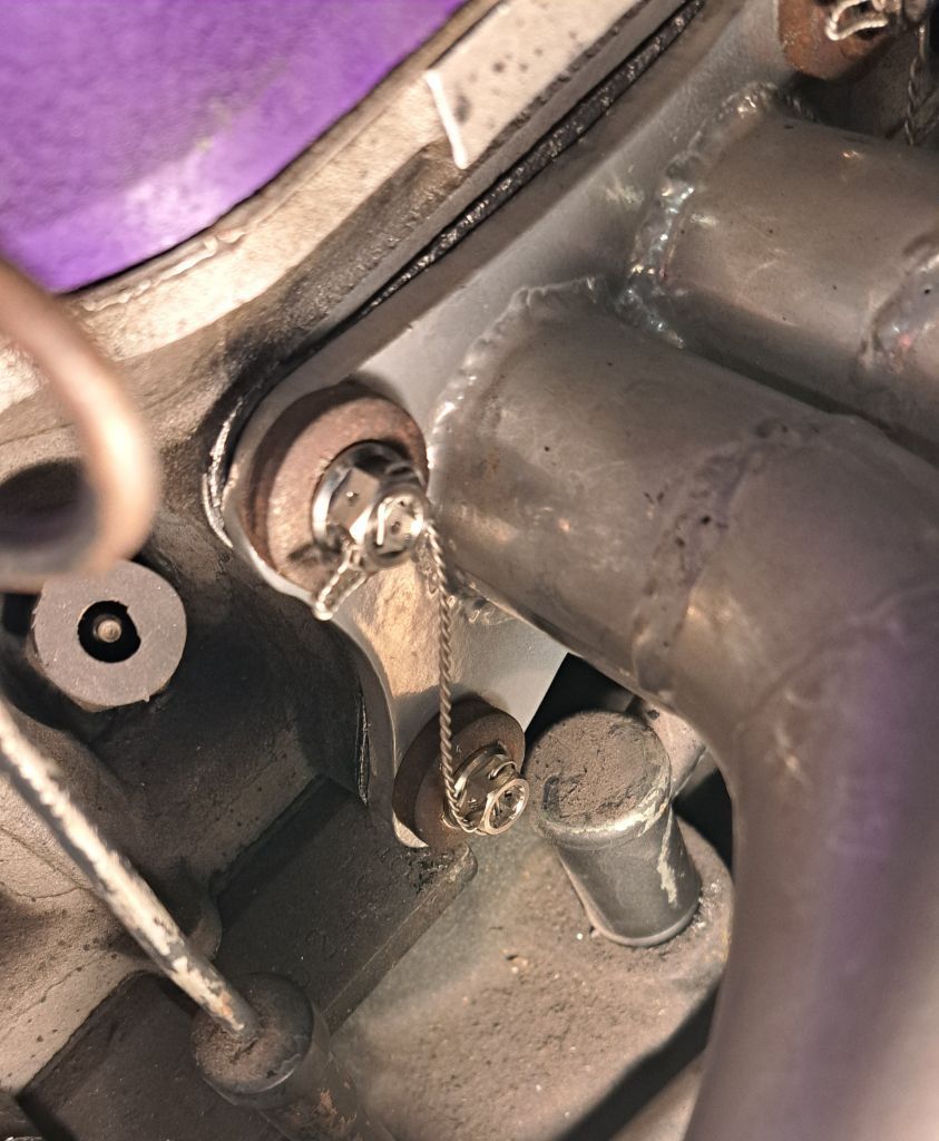

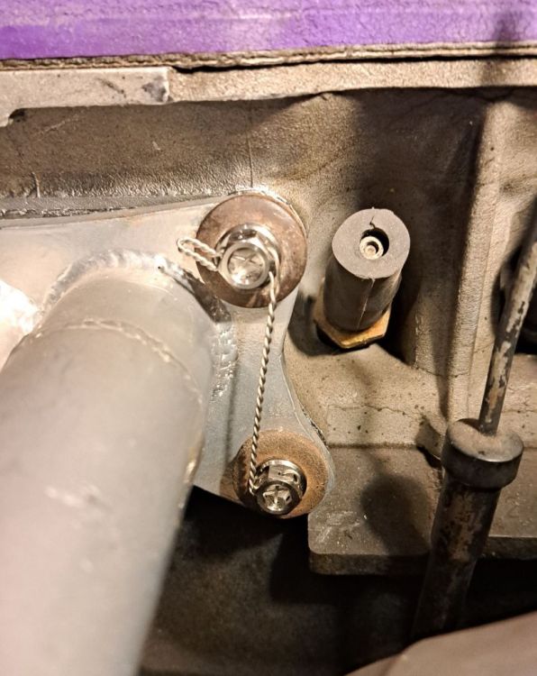

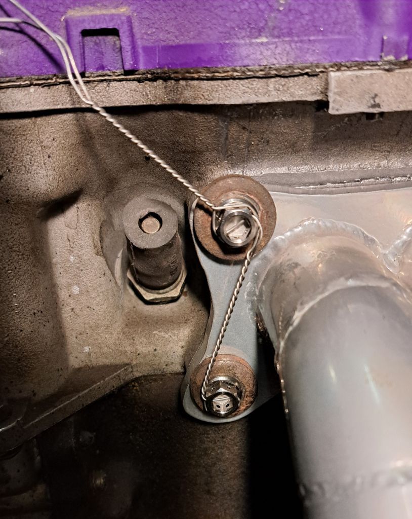

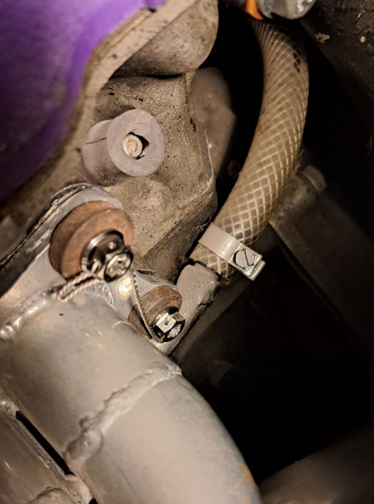

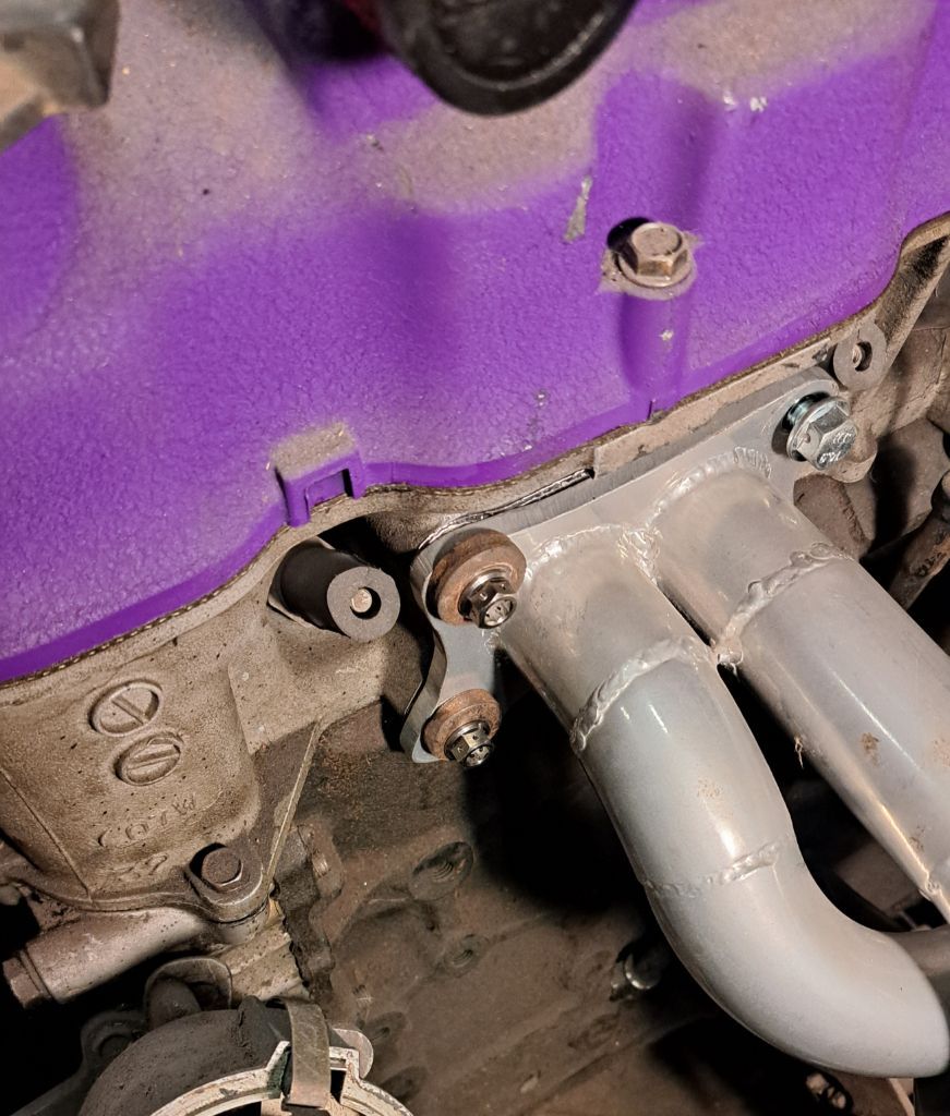

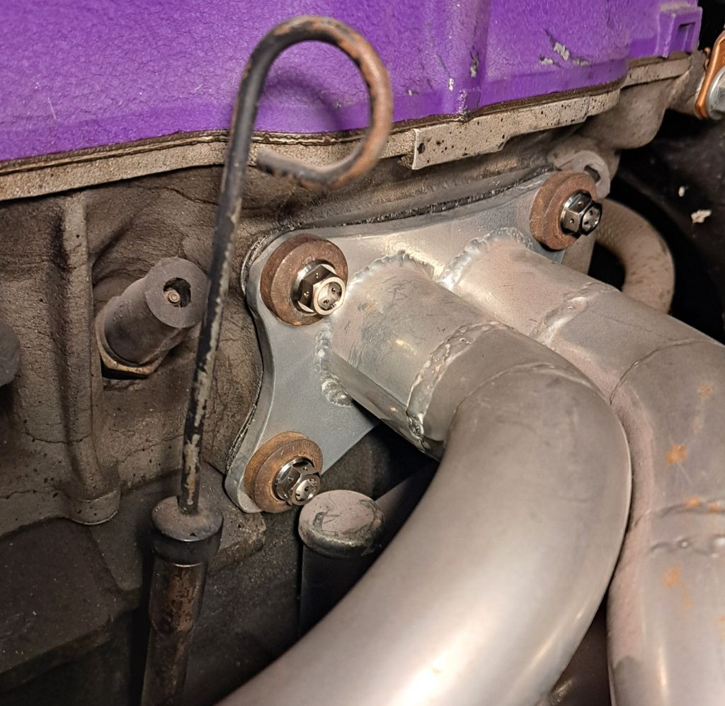

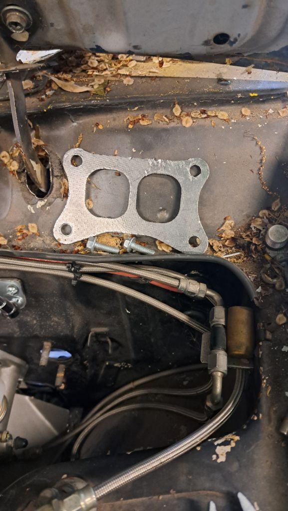

Which finally arrived!  Drilled bolts made of titan-YUM...
And in the process of swapping them out...
and all in...

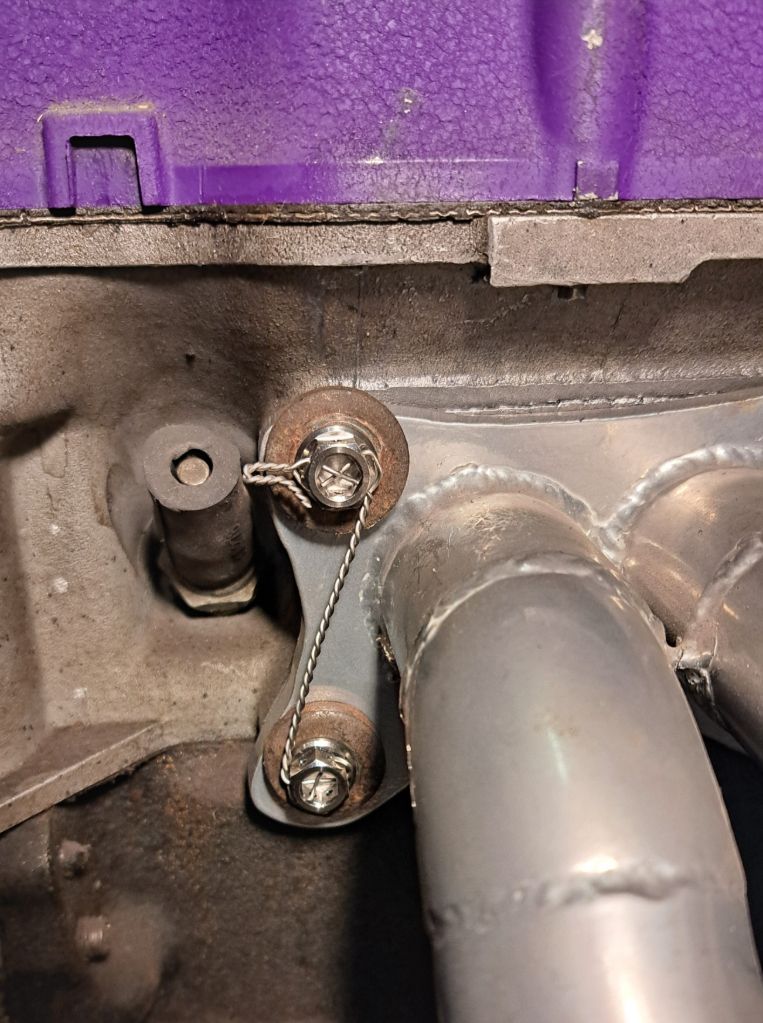

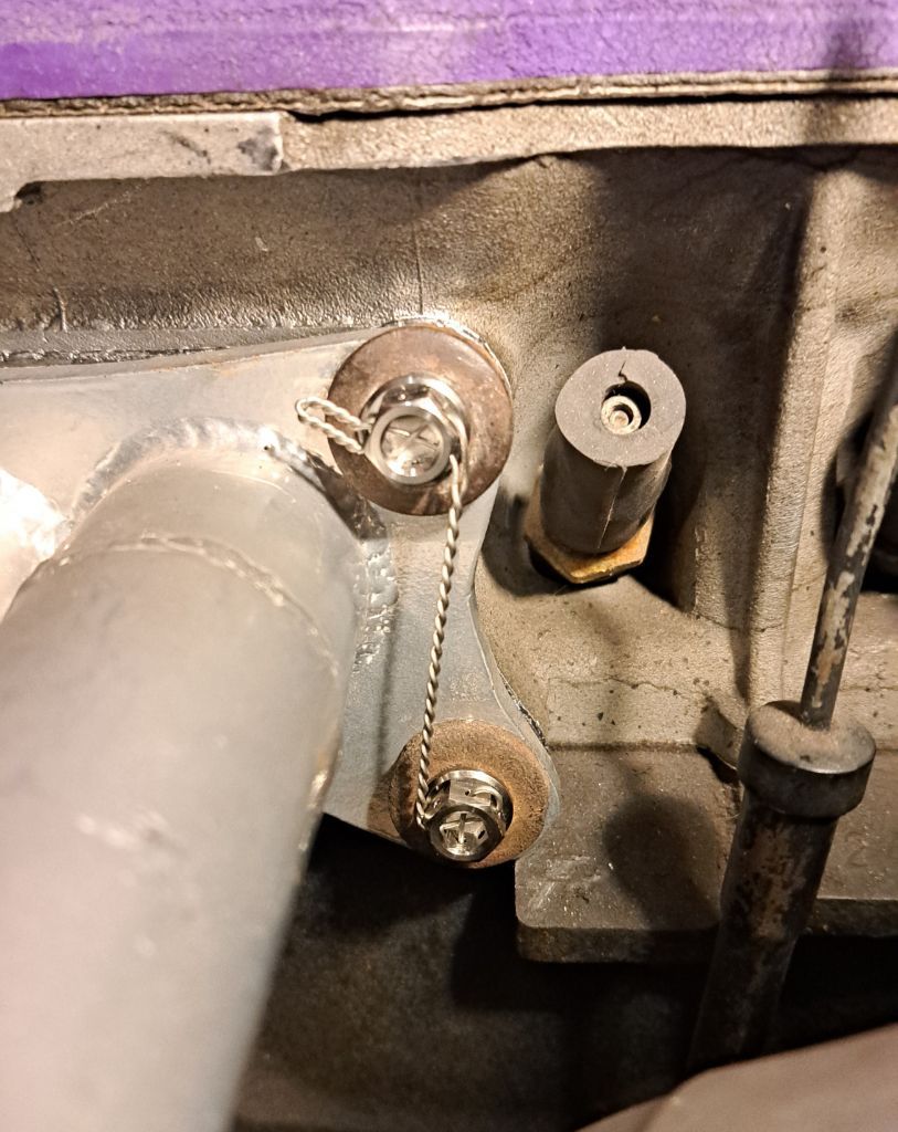

Then, I broke out the safety wire pliers and got to work...
I didn't like how this turned out so I cut it off and tried again...
Much better.  Only three more pairs to go.  Back pair of front flange...
Front pair of back flange...
And back pair of back flange...
And a final gestalt...
SON OF A...
Just kidding.  That's one of the old gaskets.
Which is what we did.  You have seen M8x1.25 button head bolts before (and I forgot to take a picture) so you will just have to be satisfied with this...
And if you compare the above photo of the mismatched pedal height to this...
you will see why...
Oh, and the clutch master is all bolted in and plumbed again...
So, we are basically back to where we were last month.
