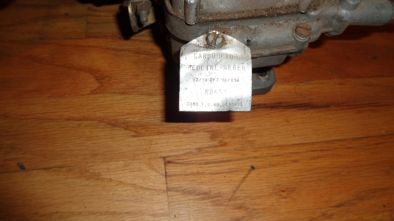

wayno Posted July 29, 2019 Report Share Posted July 29, 2019 (edited) I am curious, is the Weber 32/34 DFT 9A/11A nothing more than an emissions carb. I ask because I have 2 of them and it appeared to me that they will bolt right onto a stock Datsun 320 E1 manifold, I thought they were really old Weber carbs from the 60s, but now I am wondering if they are just modern CA emissions carbs. If they were old(60s carbs) then they would be period correct for the 320 although there is no way the stock air filter housing would fit on the carb adapter it has. Edited July 29, 2019 by wayno Quote Link to comment
Stoffregen Motorsports Posted August 1, 2019 Report Share Posted August 1, 2019 On 4/16/2014 at 7:54 AM, Charlie69 said: On a Z 24 I would not run less than a 32/36. The 38 runs real strong on a fresh Z24. 32 34 is to small in my opinion. Are you possitive your 81 has the Z24? The Z24 was not available in 1981. Chevy sold millions of their V8s with single barrel carbs. I think this one will be fine. 2 Quote Link to comment
Stoffregen Motorsports Posted August 1, 2019 Report Share Posted August 1, 2019 We've had this discussion before. The "smog legal" Weber was very similar to ones found on Pintos, Fiats and other makes/models. There was even a Ford Motorcraft part number for a near identical carb, and they called it a "Holley Weber 5200". You have obviously found out the hard way that there is little to no support for these smog legal carbs, but reading what you posted made me wonder if by searching for parts from a Fiat or Pinto, you may find that a lot of the parts (like jets) interchange. 28/32 ADF 34 DMSA 34 ADF 32/36 DFEV These are just some of the names I found in a quick search for "Fiat Weber". Try one of these and see if any of the parts interchange. Maybe a call to Redline or Pierce would help clear this up. 1 Quote Link to comment
wayno Posted August 1, 2019 Report Share Posted August 1, 2019 I should have mentioned this was an old thread revival. I have found gasket kits(rebuild?) for these carbs at Pierce Manifolds. I guess mostly I was asking if these were period correct for the 320 truck, I got these carbs with a 1964 Datsun NL320 and this is why I thought they might be period correct, but now I understand they are 1980s??? carbs and not made back in the 60s. 1 Quote Link to comment
Stoffregen Motorsports Posted August 2, 2019 Report Share Posted August 2, 2019 I see that now. No, these were not era correct to the 320. If they bolt to a stock manifold, I would still use one though. Good carbs. Quote Link to comment
