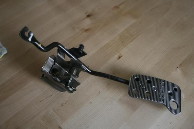

BTW heres the bracket to hold the s2k pedal...
needed to cut it ' date=' weld, and position the pedal like 4 times , but in the end
looks like it came with the car...i even used the s2k cable and firewall clip... :P
