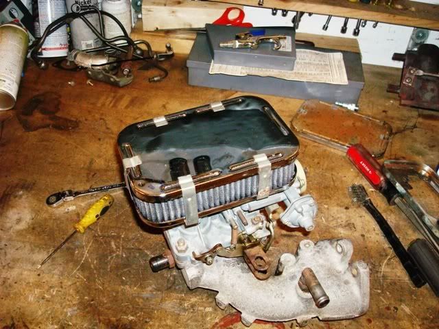

five10freak Posted July 15, 2008 Report Share Posted July 15, 2008 I have used the DGEV, and it had worked with great success. here are a few pics of a DGEV on a stock L manifold. unit was just sold to another Dimer. Quote Link to comment
