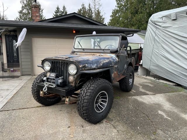

So my I lost oil pressure in my CJ5 and the motor developed this loud banging sound. I decided it was time for a quick engine swap to get my DD back on the road....
Little did I know my jeep had decided it was time to get some major work done 😛
I've been keeping this frame together for a while now as it has to last until this winter, when I can get to building a new frame from scratch (I want to finish the datsun and clear out the garage). I was still quite suprised that after scouting for a camping spot for memorial weekend that my frame developed this...
I ground out the cracks and re-aligned the frame.
Then I welded up the crack and got to work on reinforcing the area.
Started with a cardboard template and a peice of 1/8" plate.
Then I cut out the plate and added a few holes to lighten it up and provide more weld surface area.
Clamped everthing in place and got to welding....no making fun of my welds 😛
Then I strapped the other side as it was starting to crack as well.
A little paint and I'm ready to move on to the next problem....
Last year I bent my drag link that I had repaired once already...I had a spare laying around so I figured I'd beef it up before installing it. So I used a peice of 1" pipe I had (thanks Ryan)
Cut the new drag link in half and prepped the pipe.
Checked the fitment.
Drilled some holes for more weld surface area, and got to welding...
Finished it off with some paint...
I have a few more things to do to get ready for camping, memorial weekend is sort of a big deal for me 😄
I'll try to keep the camera nearby for pic's 😉
Enjoy
