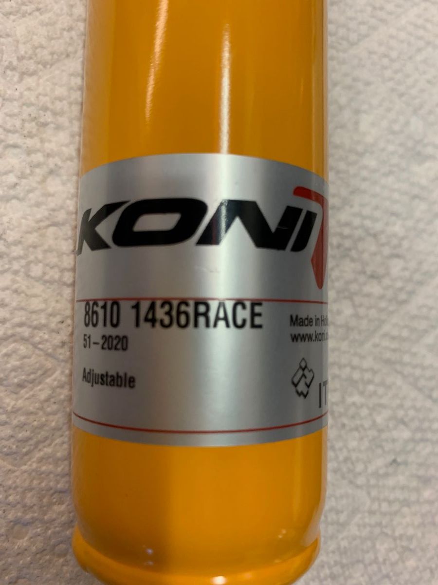

Oh nice! Those look like they will perform well. What struts are you running up front?

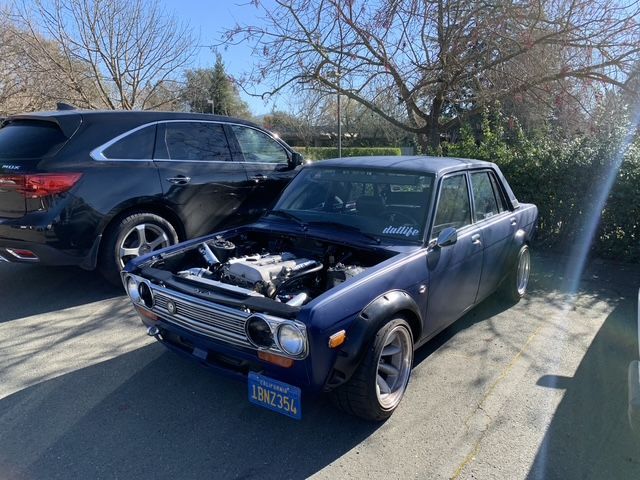

Struts are Infiniti M30, same same as late Z31 turbo or S12 V6 but with 4 lug hubs and floating rotors.
Not much to update, I've just been driving it as much as I can before I take it to get exhaust fixed.

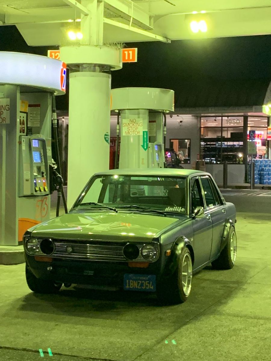

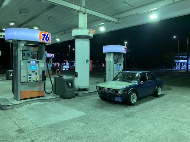

Night cruise!  Before the curfews 😉

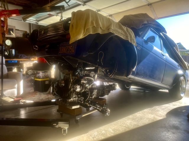

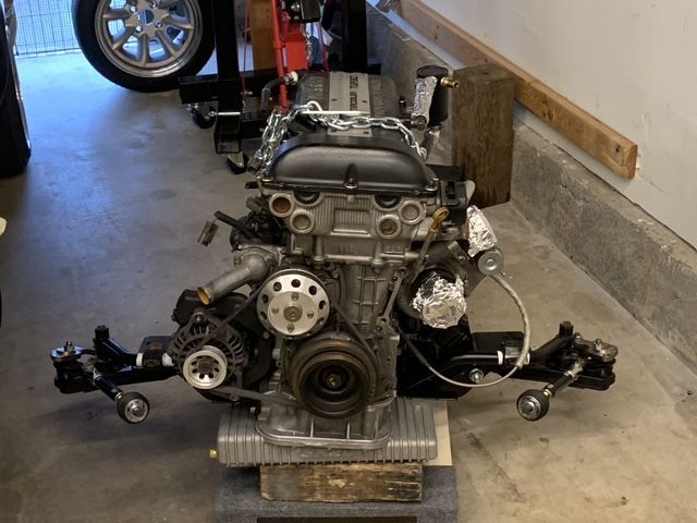

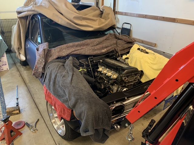

New Clutch, new master/slave, pivot, lever arm, rear main, upper oil pan resealed, etc.  I diagnosed my clutch failure from a while back as an issue of overextending the throw out bearing.  The lever arm had cracked and was flexing to the point that it wouldn't work anymore.
Ready to slide the unit in!
After having done this a handful of times I have found it much easier to lift the car and slide the engine and trans in from the bottom.
With help from a couple good friends it went in smoothly!

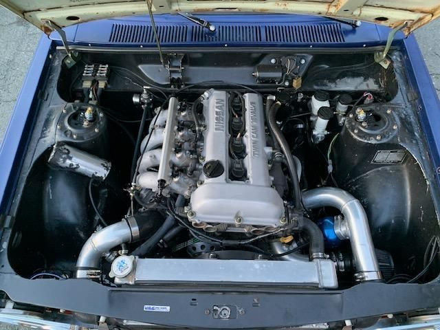

The car wasn't running too good.  Very rich and possibly some boost leaks.  I ordered and installed some replacement injectors as I had determined that at least one was leaking heavily.  After popping those in and monkeying around with my charge pipes it has slowly gotten better.  At this point it is running decently, but not quite as well as it was once upon a time.  I figure (and have been told by everyone I know) the ECU is at it's limit and the car is way overdue for a standalone.  That will likely be the next big mod.

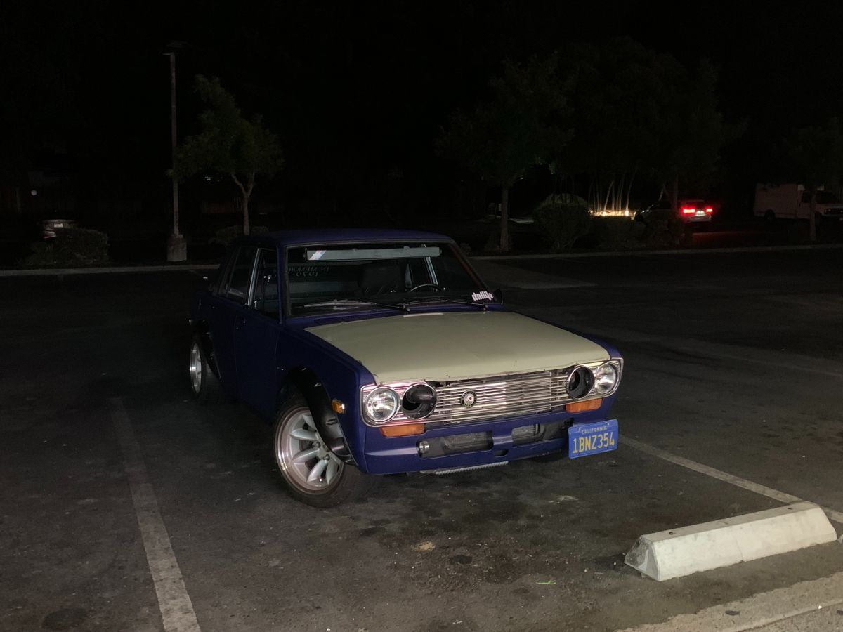

Now that I had it running, I reached out to a friend and got set up with a really cool body guy to get my hood back on.  He killed it and not only was it done quickly but the price was super reasonable as well.  It definitely took some finessing but it fits pretty well and latches just like it should.  I am stoked to have a hood on again, even with the mismatch.  I had also dropped off my original hood to get straightened out and will be picking that up soon.

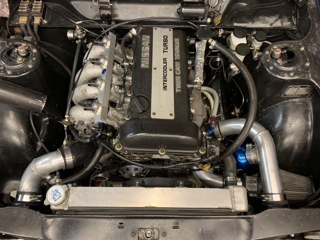

I got the Link installed!  FLI in Santa Rosa took great care of my car.  They installed a top feed fuel rail with ID1050x injectors, removed the MAF and installed an IAT in the charge pipe before tuning the car to about 290ish WHP, 265 WTQ at ~12psi. It is a lot of fun and running great!

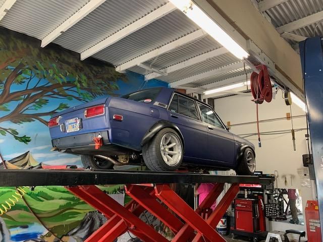

Next up was an alignment with the one and only @Bustanut !  He was able to dial it in, the alignment was super whack so really glad to get that sorted.  He also found a few too many loose fasteners... 😕

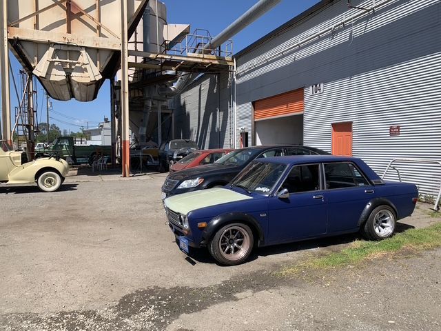

I went to a couple cars and coffee events and a BBQ with the crew, very good times!

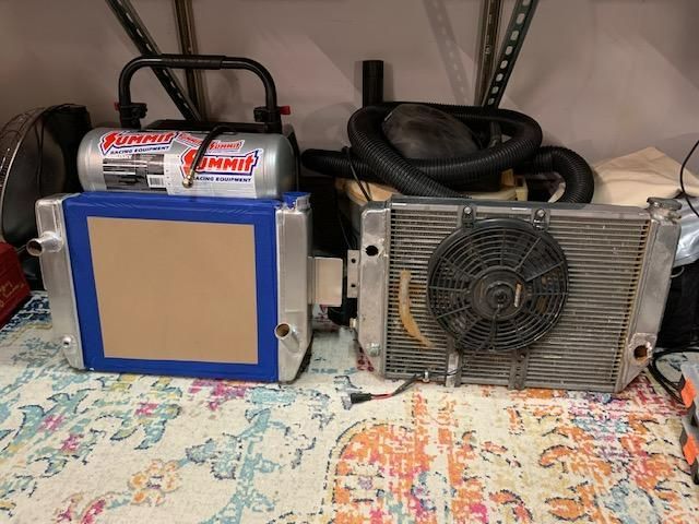

I was able to get a new rad fabricated from a Summit Racing supplied Griffin, Special Technique Fab in Santa Rosa did an excellent job on it.
Things have been a little bumpy lately.  Before I had the car tuned I installed a surge tank and 400lph inline pump.  That was a whole ordeal lol.  After ECU install the pumps wouldn't shut off correctly. I dealt with it for a while but after the track day I was over it.  I rewired my fuel pumps to turn on and off correctly with the key and killed something in the car in the process.  No start! I was fearful I damaged the Link so I had the car towed back to FLI.  It turns out I burned the starter wire, so it was a relatively cheap mistake lol.  I also had a small problem with the rad and had to take it back to Luke at Special Technique to weld around the filler neck. It was nothing he did, apparently they tend to leak there.
Last night I got the rad back in and filled, I'll be driving it again next week!
