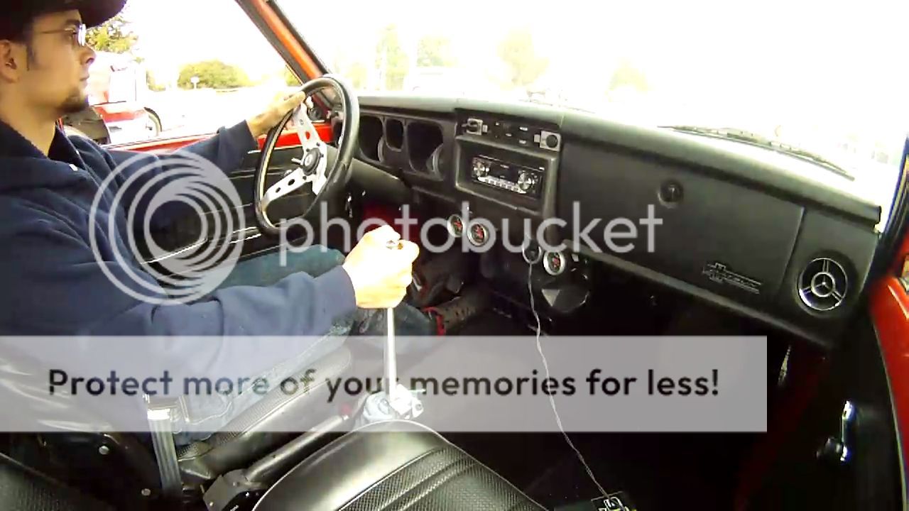

A short video showing the shift action.
http://www.youtube.com/watch?v=BGaB65a3jnE&feature=youtu.be
Moving the fulcrum point upwards keeps the length but shortens the throw. Shortening effectively does the same thing but you loose the length. In both cases mechanical advantage is lost and the shift requires slightly more effort. A small price to pay I say.

http://s404.beta.photobucket.com/user/doitinadatsun/media/GOPR0890_zps0ae2e24c.mp4.html
