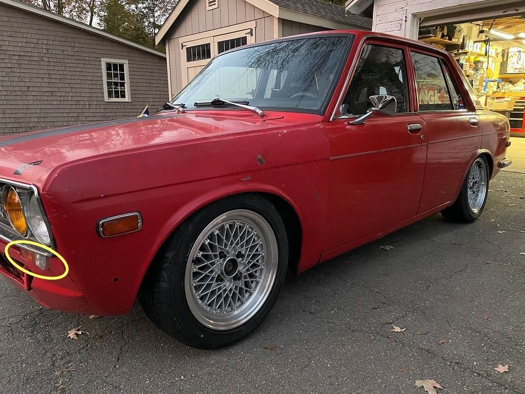

demo243 Posted October 30, 2025 Author Report Share Posted October 30, 2025 Im still here! 510 has actually seen a bit of love and use this fall! Its been really fun driving it again. The biggest news being I finally bit the bullet and got some Mass Plates for it - it was frustratingly annoying getting it ready for Mass Safety Inspection, but ultimately we passed! One little hiccup with the reverse lights since the current transmission is not a big fan of reverse... especially when the car is off. A few other updates- Replaced the old cracked front turn signals with some Thailand specials- added amber bulbs for the clear portions. Also put an amber bulb back in the blank hi-beam spot. Ive also slowly been "softening" the car up to make it a bit more enjoyable driving around the street. This means I swapped in a rubber trans mount and engine mounts. Ultimately I would like to swap in my "old" stock engine mounts, but that poses an issue of it shifts the engine forward 1/4-1/2" which may not work with the current exhaust. So I threw these rubber pucks in instead of the poly. Still vibrates a lot but is a little smoother. Seems like the rubber mounts helped with the transmission noise as well. Its still there and annoying but a little bit more livable... Just a cool shot poking out of the garage Finished up my clear filter covers as well. Unfortunately Ive had some issues with them cracking around the center mount hole. Tried using a rubber cone washer on both sides to allow for some expansion but still cracked... Will live them for now... And the biggest news---- Picked up some fresh kicks!! No they aren't real... Another set of Rotas for me - 15x7 +20 OS Mesh. Hard to argue with the cost and weight of them. I did consider a set of Hayashi Racing wheels or real SSR MK 2/3s but lead times and potential import tariffs didn't make sense. These are going to be my shoulder season (Fall/Spring) and Winter storage wheels. I mounted up some 195/50R15 Toyo Extensa HP IIs - this way I have a "all season" tire to deal with the cold winters but should still handle the performance driving well too. Had to drop to the 195 instead of the 205 to clear the inner hump the 4 doors have in the back. Haven't had a chance to drive them yet though as I decided to replace the fuel sender and some soft lines at the same time... Hopefully get it out this weekend. Also added a proper solid mounted side mirror. Its not exactly what I wanted, but was able to mount to the existing holes in the door and seems to function well enough. Ive got a new muffler to get welded up as well to hopefully quiet it down a little bit, but haven't gotten to the exhaust shop yet... I think Im going to try and open up the exhaust hole in the crossmember before I do so they can finish the exhaust in full 2.5" tube. TBD... 5 Quote Link to comment
iceman510 Posted October 30, 2025 Report Share Posted October 30, 2025 Do those new turn signals not have the angled rear surface? They stick out so far on the outboard side. Quote Link to comment
demo243 Posted October 30, 2025 Author Report Share Posted October 30, 2025 9 minutes ago, iceman510 said: Do those new turn signals not have the angled rear surface? They stick out so far on the outboard side. Ill have to double check - but no I don't think they are angled on the back. Its been a while since I actually installed them so don't really remember. Looking it up quickly though, it looks like the NOS ones actually have a short angled section on the outside edge of the light that tucks it back into the body. Good question... Doesn't bother me much but they do stick out a bit. Quote Link to comment
datzenmike Posted October 30, 2025 Report Share Posted October 30, 2025 Bit of a stretch but any chance each are on the wrong side? Quote Link to comment
ggzilla Posted October 30, 2025 Report Share Posted October 30, 2025 4 hours ago, iceman510 said: Do those new turn signals not have the angled rear surface? They stick out so far on the outboard side. You mean the turn signals below the headlights? If they were on the wrong side, they would be upside-down i think Quote Link to comment
demo243 Posted November 1, 2025 Author Report Share Posted November 1, 2025 I don't think they would fit in backwards. Looked back at some old photos and looks like it does stick out just as much with my old lenses- haven't had a chance to check the garage yet. Quote Link to comment

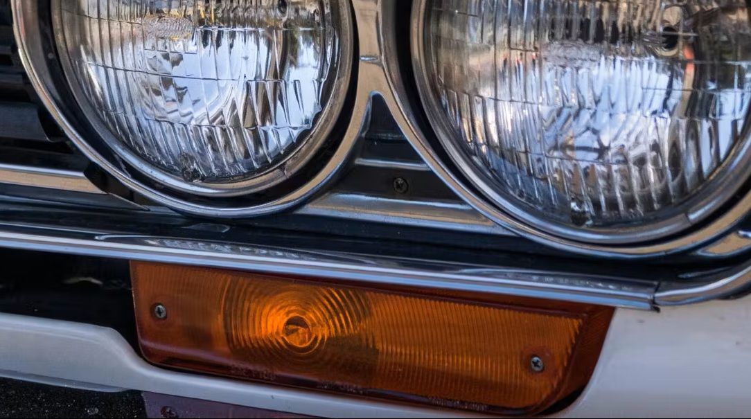

iceman510 Posted November 2, 2025 Report Share Posted November 2, 2025 The housing of the OE is angled. I have mine out of my race car, so I can't look at them at the moment. Maybe they do stick out some normally. These below on eBay look like the housing is tapered (better word than angled). Quote Link to comment
datsunfreak Posted November 5, 2025 Report Share Posted November 5, 2025 They are sticking out the correct amount for that year range. 👍 68/69s do sit more flush, but this is where these belong. Quote Link to comment
datsunfreak Posted November 5, 2025 Report Share Posted November 5, 2025 Probably just more noticeable on a bumperless car? Here's the stockest one I could find. You can see it sticks out about 1/2" at least... 1 Quote Link to comment
iceman510 Posted November 6, 2025 Report Share Posted November 6, 2025 On 11/5/2025 at 4:05 PM, datsunfreak said: 68/69s do sit more flush, but this is where these belong. Maybe that is what i am remembering. I have a 69, a 70 and a 73. Only the 69 has the lights in currently. Thanks John. 1 Quote Link to comment
DARIN 510 Posted November 11, 2025 Report Share Posted November 11, 2025 Yes 70-73 marker lights do stick out. 68-69 tuck back a little. First time I encountered this I thought something was off as well. But my 510 before that one was a 69 so that was all I had at the time. Quote Link to comment
