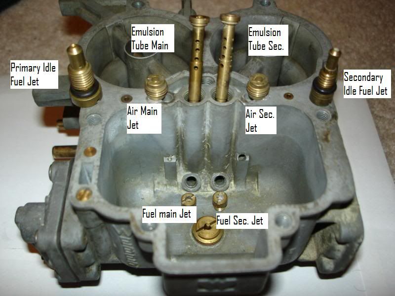

ggzilla Posted July 14, 2012 Report Share Posted July 14, 2012 nice piccy of a weber 32/36! Quote Link to comment
datzenmike Posted July 14, 2012 Report Share Posted July 14, 2012 Than-kew! No way it's mine but i see a picture, i grab a picture. You never know when someone needs an example. I started this with Datsun transmissions and now have about 700 transmission/driveshaft related pictures. Could whittle them down to 500 I would imagine. Quote Link to comment
