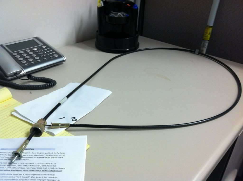

Eagle_Adam Posted July 3, 2012 Author Report Share Posted July 3, 2012 GOT MY NEW SPEEDO CABLE!!! unfortunately it did not come with the needed grease -.- can i get away with wheel bearing grease or something generic or is there a specific kind i need? Quote Link to comment
ggzilla Posted July 3, 2012 Report Share Posted July 3, 2012 Use a generic speedometer cable grease. It is a sulphite blend I think. I would not use wheel bearing grease. You local auto parts store will carry it such as O'Reillys. But maybe your new cable is pre-lubricated. Doesn't it come with a little paper saying what to do? Quote Link to comment
datzenmike Posted July 4, 2012 Report Share Posted July 4, 2012 Molybdendum-disulphide powder or grease, better than graphite. Quote Link to comment
Eagle_Adam Posted July 4, 2012 Author Report Share Posted July 4, 2012 thanx guys, there was nothing in the box but the cable. Its the right length compared to my old one and i picked up some grease from NismoDr so tomorrow i can get my dash put back together :) Quote Link to comment
