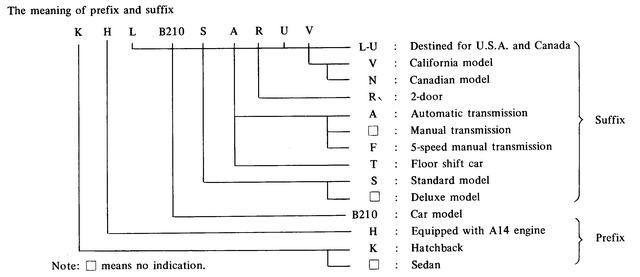

datsunaholic Posted April 23, 2008 Report Posted April 23, 2008 Not really. The codes vary, but they all take the same form starting in the early 60s. A B210 will have a code similar to: KHLB210329116 The VIN will either be 12 or 13 letters long. The 1st digit in the example, "K", means hatchback. No K means sedan (both 2 and 4 doors used the same VIN codes). HOWEVER... before 1976 the "K" did not appear in the VIN at all, only in the body code, so sedans and hatchbacks would have a common VIN on early ones. The second digit "H" stands for both the A13 and A14 engines as far as I know. A "P" would be a 1.2L engine, which wasn't sold in the US. "L" stands for Left Hand Drive. No "L" means right hand drive. B210 is the chassis code. The first digit after the chassis code is the year code, but it's not consistent. Zero means first year, 1 means second year, but some digits may be skipped or even used over 2 years. What is he looking for? In the US, B210s only had 2 engines and the 1.3L was only used in 1974. There were only 2 body styles- sedan and coupe, and only later years did the VIN differentiate. Quote

ggzilla Posted April 24, 2008 Report Posted April 24, 2008 (edited) Take a look at this: Datsun chassis codes Edited February 22, 2025 by ggzilla update images per site requirements 1 Quote

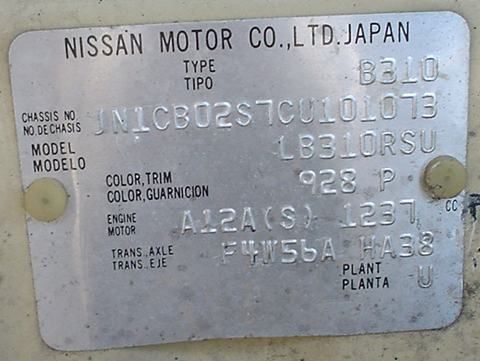

ggzilla Posted August 4, 2012 Report Posted August 4, 2012 (edited) VIN numbers were not used until 1980. Before that Datsun used Chassis Number and Engine Number. The B210 codes above are not part of a VIN. Of course the B210 codes won't apply to a 720 -- nor any other Datsun. In 1980, USA Datsuns switched to VIN, you can find it on the engine compartment ID plate as "Chassis No." Because this is a standardized VIN, the decoder on Wikipedia works for it: Your 720 should have a similar plate unless it is a 1979 or early 1980 (made before 1/1/1980) Edited February 22, 2025 by ggzilla update images per site requirements Quote

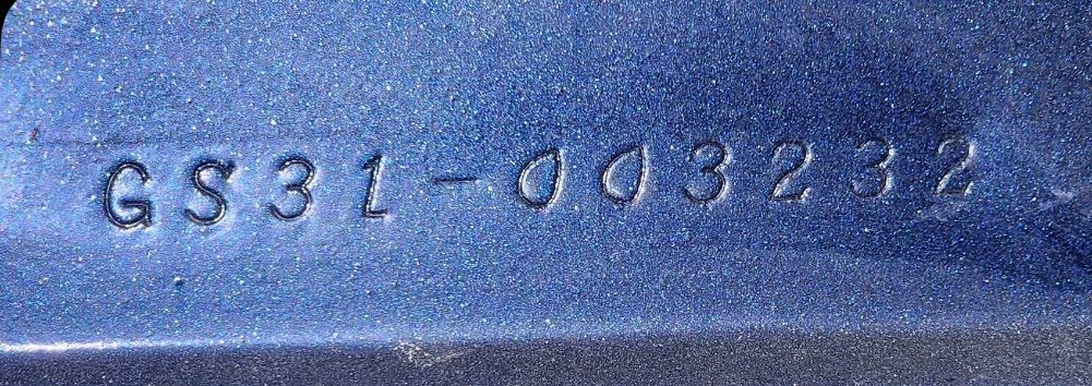

Jared smith Posted April 27, 2025 Report Posted April 27, 2025 I am looking for a right hand drive Datsun z that I want to run the vin and know about it. It’s a weird vin # Quote
ggzilla Posted April 27, 2025 Report Posted April 27, 2025 That is not a VIN number. It is the car serial number Quote
ggzilla Posted April 27, 2025 Report Posted April 27, 2025 GS31 G: long wheelbase (2+2) S31: minor update to the Nissan S30 (Fairlady Z) 1977-1978 for the Japan Domestic Market VIN based on 1979 & 1980 ISO Standards was the first international standardized vehicle identification number system. Prior to this, manufacturers used their own system. Nissan called their earlier IDs the "Car Number" and was just the model and serial number as shown in your photo. Since the 1981 calendar year, only the standardized VIN has been used in North America and Europe. Australia switched to VIN in 1992 Quote

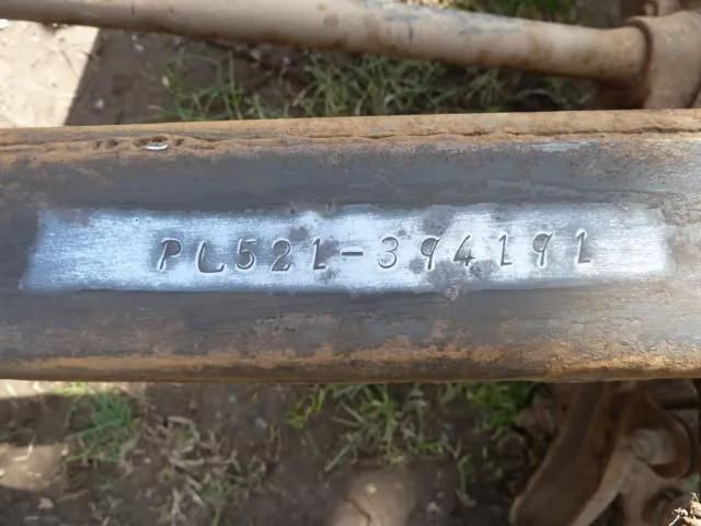

datzenmike Posted August 12, 2025 Report Posted August 12, 2025 Even with 4 headlights the front sheet metal changed between the 520 and 521 starting May '68? This is when the front amber parking lights moved from the fender corner to front facing. You say the front end is a 521 and I agree but also that it's a '67 so this is at odds with itself. 1/ L521 113,017 is the VIN for the front sheet metal front end which as stated, started no earlier than May '68. That's why I stated that if you ignore the sheet metal 113,017 would have been a 520 made in or around late May '67. 2/ If we go by 521 production numbers then (the front L521 sheet metal only, not the frame) was made between October '68 #038,555 and June #180,000. 141,445 total over 9 months or roughly a 15,716 per month. 113,067 would have been made roughly in February '68. Look on top of the frame rail, to the rear of the right side engine mount, beside the starter... Use wire brush it will be rusty. http://i258.photobucket.com/albums/hh275/Daniel_521/SN521Close.jpg Quote
ggzilla Posted August 12, 2025 Report Posted August 12, 2025 are you thinking someone put different sheet metal on the frame? In other words the car number on the frame might be different than car number on the front sheet metal number on frame Quote

datzenmike Posted August 12, 2025 Report Posted August 12, 2025 1 hour ago, ggzilla said: are you thinking someone put different sheet metal on the frame? In other words the car number on the frame might be different than car number on the front sheet metal number on frame I am. The frame # will solve this. The one above is a PL521 394,191. Feb '70 was car # PL521 350,001 to May '71 # PL521 587,101 so roughly made in May '70. 38 minutes ago, ggzilla said: Yes 1965 April: 520 introduction 1966 October: 520 4-eye (4 headlamp) introduction 1968 May: 521 minor change introduction with J13 engine 1969 October: 1970 model year introduction with J13 engine 1970 April: L16 engine introduction for PL521 (USA) 1972 Feb: Datsun 620 introduction SERVICE BULLETIN MAY 1968 VOL. 92 Introduction of New Datsun Pick-Up Model 521 Series May 31, 1968... I get the first PL521 with L16 engine as starting production July '69 of the previous year. The J13 ceased production June of '69 so there was no overlap. The L521 stopped and the PL521 began end of June '69. Quote
