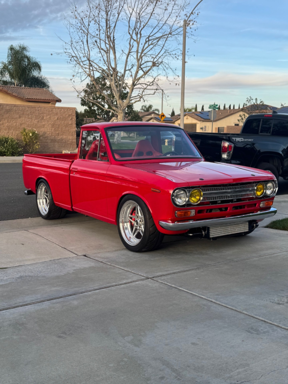

sweet! i'm thinking of going 4" in the rear to level out my stance. how much travel do you have with the 4inchers?

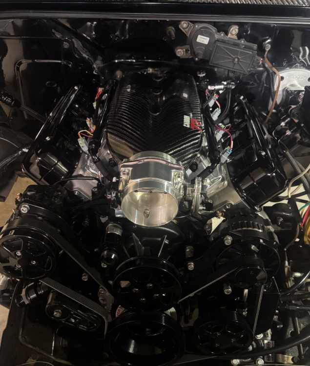

Ill let you know when i get a chance.One thing to remember is that with the 17" wheels i had on before the rim would hit the the bottom bracket for the U bolts.Now with the 18" wheels on the rear i could go down one more inch.So the front will meet the fender well hopefully with no turning problems.But i want to finish everything else first.My inner tie rods need to be flipped i need some longer wheel studs im still trying tofigure out were im mounting my fuel filter and fuel pump and i need to run a remote oil filter mount,its really close to the engine mount.

You will see me maybe JCCS.I have been thinking about mounting to the frame rails but on one hand i want them exposed and on the other hand i dont.I have Aeromotive fuel filter and fuel pump and there nice to see but i dont know what direction to go.If anyone has some ideas with pictures that would i guess help both of us out.
Let see today i mounted the fuel pressure regulator and got the starter going trying to run different bolts small thing no big deal and need to get the alternator figured out so i dont go to close to block for the radiator hose and not to far down so i do not hit the idler arm.Wil upload new pictures once more is done.
