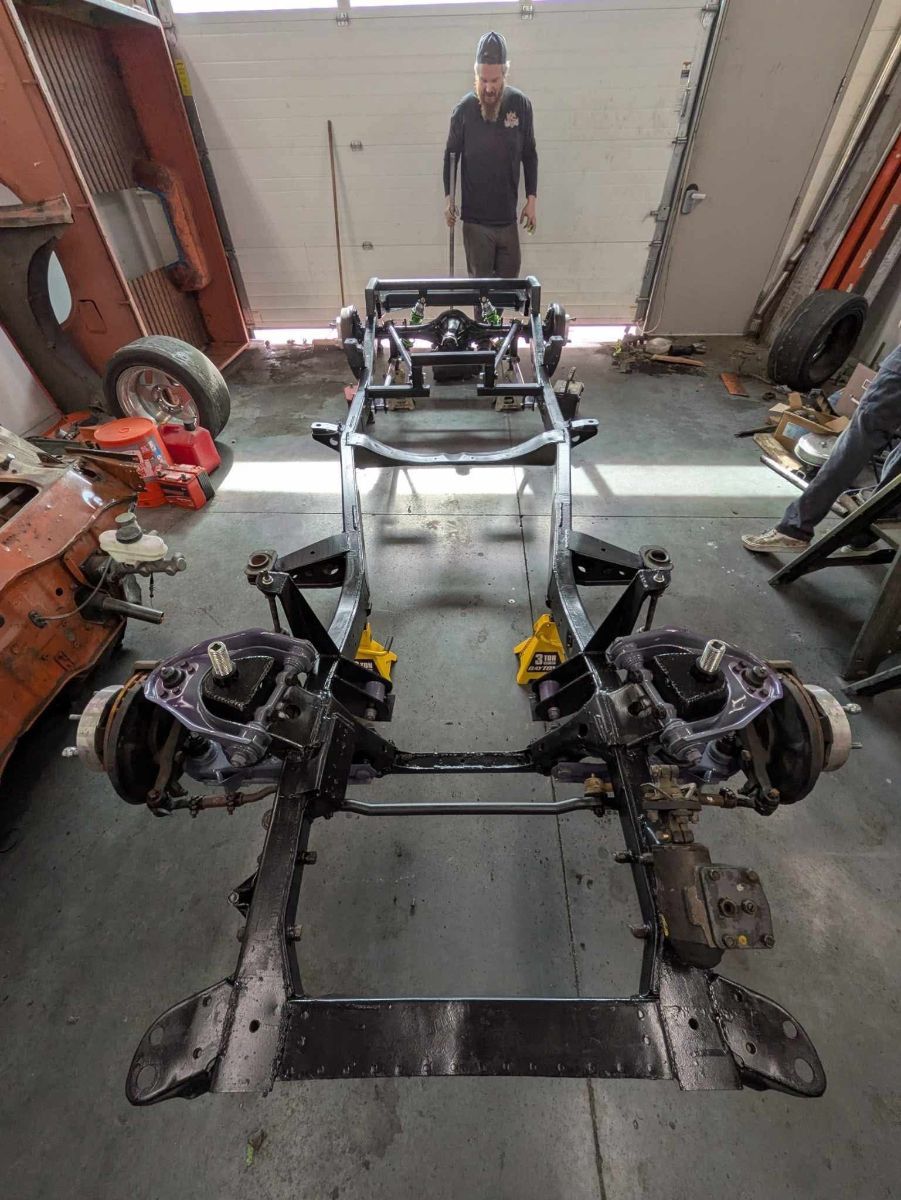

Farmer Joe Posted February 26, 2025 Author Report Share Posted February 26, 2025 3 Quote Link to comment
datzenmike Posted February 26, 2025 Report Share Posted February 26, 2025 720? steering box? Is this to make room for something larger in the engine bay? Quote Link to comment
Farmer Joe Posted March 2, 2025 Author Report Share Posted March 2, 2025 its a whole 720 frame.. i had planned on it getting a 5.3 and a z32 trans when i first started rebuilding it. sold that stuff off for the turbo volvo engine. Quote Link to comment
