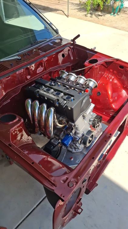

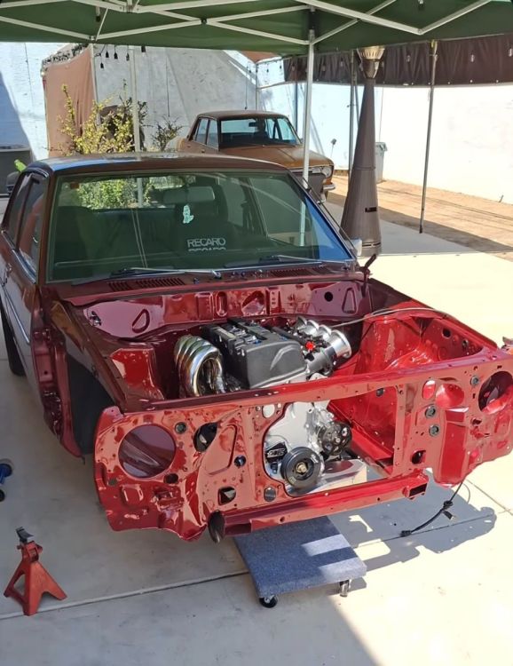

im in the process of drawing up a mini blueprint. ill post a pic as soon as i think it may be done
Datsun A-series crossmember with (non-stock) round insulators fitted
Engine mount bracket located high on the block (block is upside down)
that xmembr looks very similar to the 210s. thanks for the pics! their giving me good ideas
Now thats a good way to do it, I like that!
hopefully it works out well. now i just gota figure out where exactly i will need to drill the center hole for the mount on the bracket..
i was thinking maby i should measure from the crank pulley to the middile of the hole for the engine mount bolt on the A series. and use that lengh on the ka..
