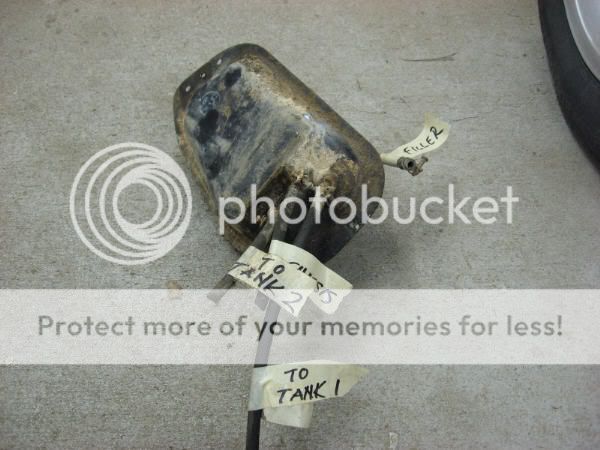

Siqx20 Posted May 6, 2011 Report Share Posted May 6, 2011 Here's the outlet line. At the very bottom of the picture on the side of the tank. dont mean to thread jack but where are those rubber lines running up to?? They were never hooked up to anything on my truck. Is it important? lol Quote Link to comment

pharouh Posted May 7, 2011 Report Share Posted May 7, 2011 dont mean to thread jack but where are those rubber lines running up to?? They were never hooked up to anything on my truck. Is it important? lol They go to the expansion tank mounted on the wheelwell by the fuel filler.Part of an early emission control. I have 3 620s,and this is the only one that still had the tank. The others have a rust hole,with the remains of the little tank. Quote Link to comment
