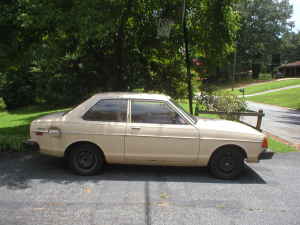

*Original post*So I'm picking up this B310 on Sunday... I don't think i have ever seen a coupe(not hatch) 2 door B310 anywhere...
looks straight.
It has 148k miles on it and was under restoration, newer interior etc...
plans for now are to get it reliable(needs a clutch) and drive it to get to know the car.
A funny thought crossed my mind, to make it look like the Tomica R30 race car, as the rooflines are somewhat similar. lol
Anyway, any ideas as to upgrades?

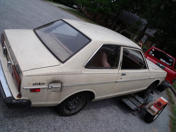

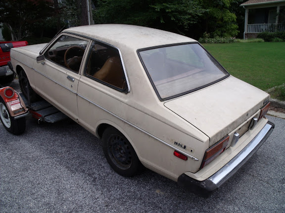

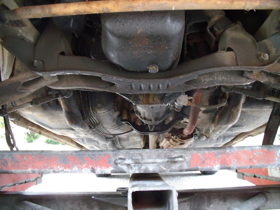

Dragged the car home today:
4 link!!!!
First datsun I have seen with NO RUST THROUGH on the underside of the car or bashed up underframe bits!!!!

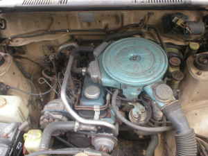

1: Get it running. Carb needs cleaning out or fuel pump might be bad. Runs awesome off of fuel poured down carburetor....
2. New clutch is needed. Half a day with a new clutch kit unless flywheel is worn.

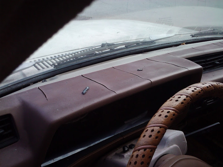

dash has issues....

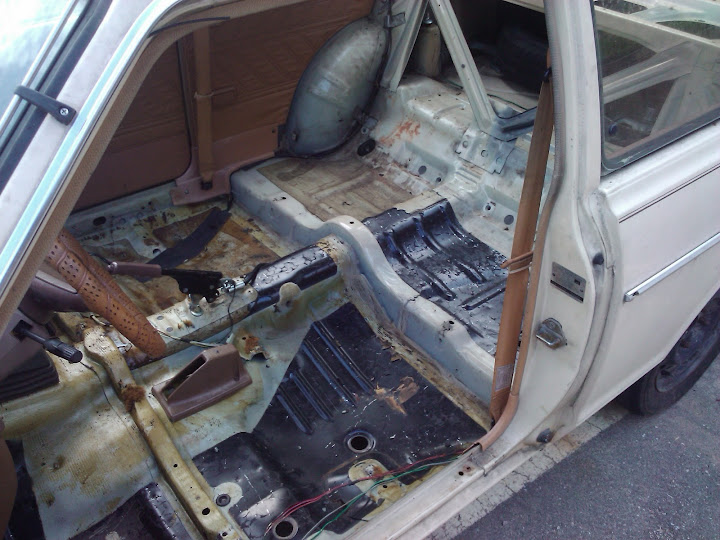

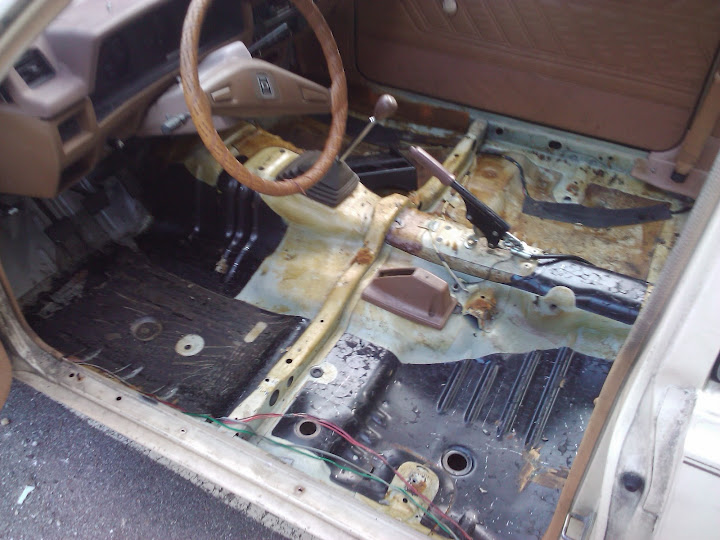

Started stripping the tar off of the floor with a chisel and hammer... got the driver's side.

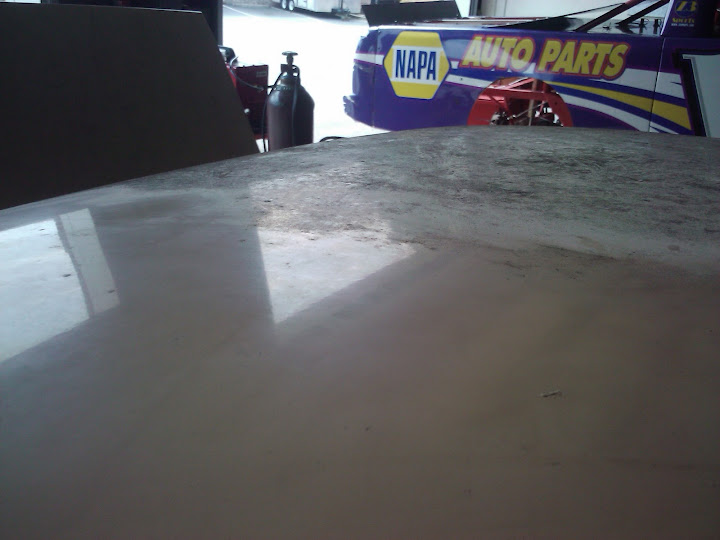

test spot on the roof cleaned up nicely with a flat can of coca cola and a rag:

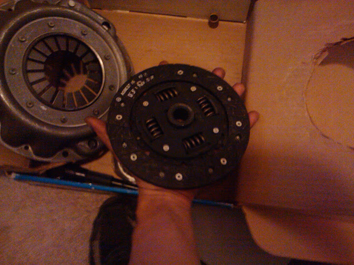

the clutch came in:
Holy crap thats small. LOL

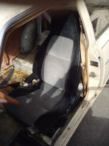

going to need to make some brackets to mount the seats to the floor but its a nice fit:
They are Talon seats I got for $20 each at the junkyard. I like the lumbar support in the drivers seat.

Changed the clutch in about 2.5 hours tonight. That transmission weighs about 45 pounds. LOL
Sprayed carb cleaner in the carb and it fired up and ran. Woohoo!
Clutch slave needs adjusting but its good so far. Also the radiator fan isn't working. LOL
