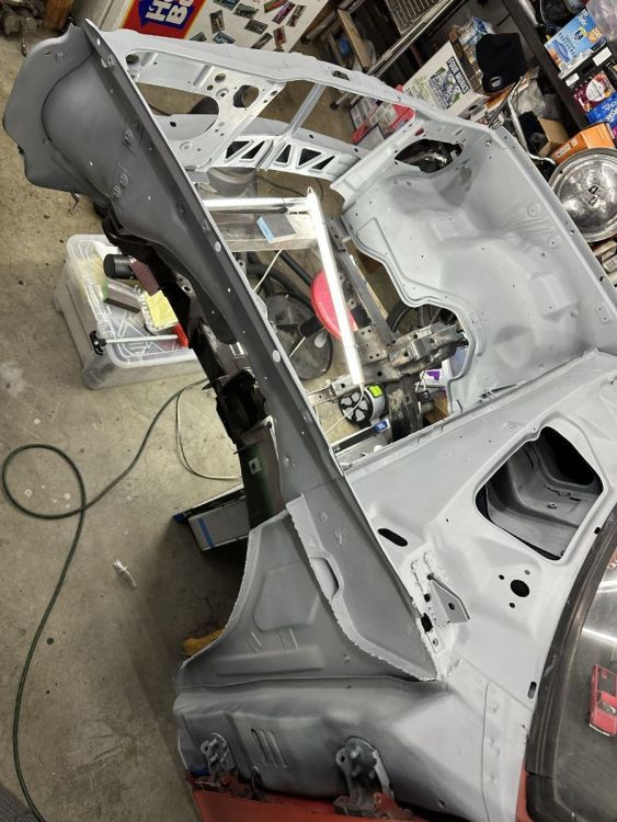

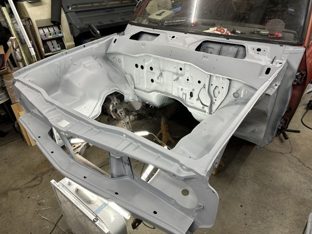

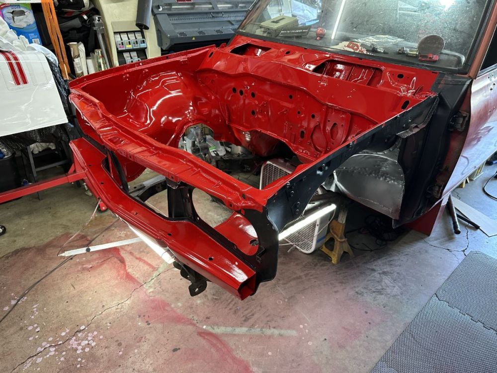

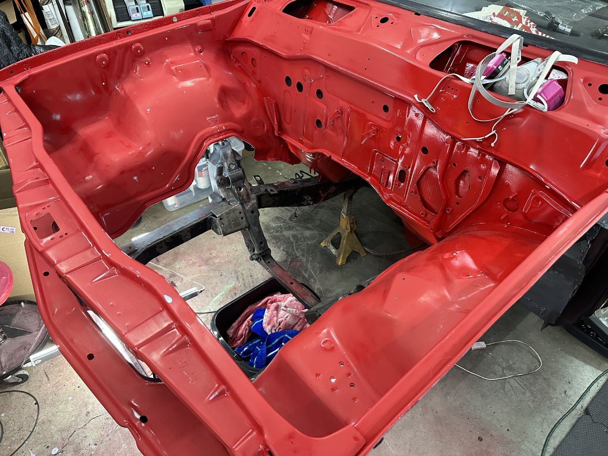

and wet sanding because I didn't scuff the high build.
Will have another coat or two once it's all leveled back out.
Almost looks like where I started minus the rust lol.

A little late now, but I recommend using epoxy primer instead of self-etching, as that is the newest, most accepted way restoration shops do it now.
