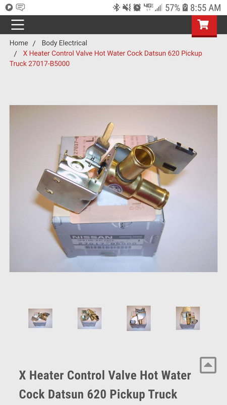

Goemon Posted April 30, 2020 Report Posted April 30, 2020 My 620 is steel, corroded and No Longer Available. I found one that is almost the same from anothe car. I will know if it is correct when they get here in a few weeks. L shaped, cable control, pull to close. Quote
datzenmike Posted April 30, 2020 Report Posted April 30, 2020 One of the 720s ises a plastic 'in line' control valve. The hoses are stiff enough to hold it still for the pull cable... Quote
Goemon Posted May 2, 2020 Report Posted May 2, 2020 This one should work, but it is pricyhttps://www.ebay.com/itm/New-Heating-Valve-Vauxhall-Kadett-B-Olympia-a-Gt-Manta-Ascona-Heater-Control/264143326269?_trkparms=aid%3D111001%26algo%3DREC.SEED%26ao%3D1%26asc%3D225086%26meid%3Ddd70ee4d4bb84b15ad456fadcd048cf8%26pid%3D100290%26rk%3D2%26rkt%3D4%26sd%3D312731128523%26itm%3D264143326269%26pmt%3D0%26noa%3D1%26pg%3D2060778&_trksid=p2060778.c100290.m3507 Quote
Crashtd420 Posted May 7, 2020 Report Posted May 7, 2020 Nissan part.... Available here... https://nissangenuine.com/nissan/nissan-cock-heater-27017b5000/ Quote
