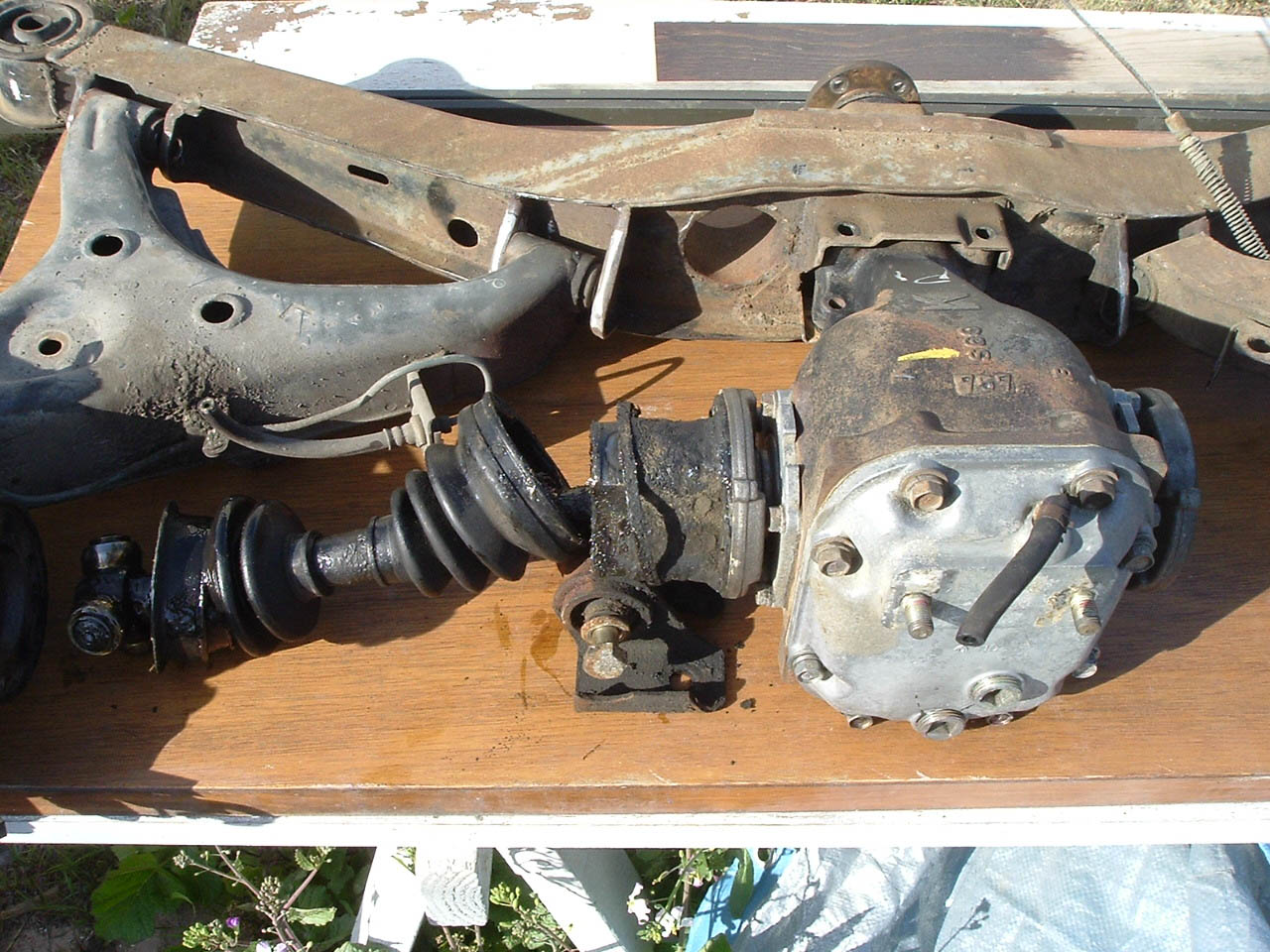

thisismatt Posted August 28, 2009 Report Share Posted August 28, 2009 ...but in all seriousness... The space between the mustache bar bolts/studs and the diff cover bolts directly to the right and left of either bolt/stud is noticeably wider on the R180 than the R160. The R160 has two bosses where the bolts/studs attach, whereas the R180 has a solid singular boss that they both attach. R200 is noticeably more "round" or square than the R160 or R180. R160 LSD's usually have the sticker on the cover. R200 LSD's usually have a finned valve cover, but not always. No USDM datsun/nissan came with a long nose R180 LSD standard. R160 R180 R200 R200 LSD on the right (R160 on left): Quote Link to comment
