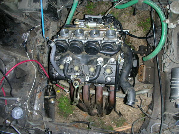

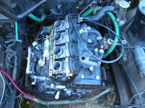

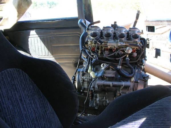

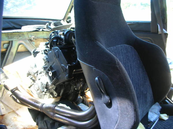

INDY510 Posted September 29, 2007 Report Share Posted September 29, 2007 This 510 needs some changes Out with the old, and in with the new 4 ideas for where to mount it, any suggestions? The motor and 6 speed weighs 145 lbs, 125 hp, 16k rpm, and 165 mph Quote Link to comment

datzenmike Posted September 30, 2007 Report Share Posted September 30, 2007 The motor and 6 speed weighs 145 lbs, 125 hp, 16k rpm, and 165 mph I would mount the motor as close in front of the diff as you can. A friend put a Ski Doo motor on a mount above a B 210 axle with a sprocket welded onto it. Had a sprocket on the motor (you could vary the sizes to get the gearing to match the motor torque) Anyway he welded a motorcycle front on it and made a trike. I drove it once (no brake system) so had to be careful. He drove it at over 70 Mph back in the day. The snowmobile had a variable Vee belt drive instead of a tranny and worked well. Too well and TOO scary. Your numbers seem right but keep in mind that this doesn't tell the whole story. 125 HP but at 16KRPMs, just how much torque is available at 1,000 RPMs when you let out the clutch? This isn't a 550 lb motorcycle it's now a 1,900 lb motor cycle (3 1/2 times heavier)and with LOTS of wind resistance too. Proper low initial gearing is essential to quickly allow the motor to rev into it's working range. The more I see this the more interested I get. Quote Link to comment
521Lvr Posted September 30, 2007 Report Share Posted September 30, 2007 I'm with you Mike. If I were going to do something like this I would mount it as close to the diff as posible. I wonder why you chose this perticular motor tho. Is it because it's what you got on hand or what? reason why is that something like this has alot of fab work and engineering involved. So it would seem {to me as a hot rodder} that using the most powerfull engine available while still being able to get all the parts I wanted. Like a zx-14 or Hyabusa Great Idea. keep us updated. Quote Link to comment

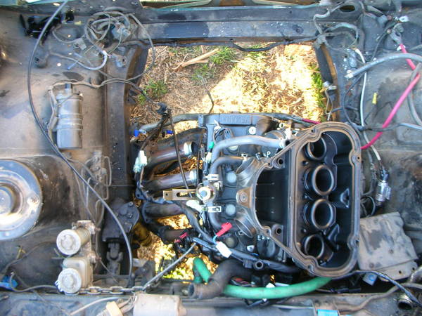

INDY510 Posted September 30, 2007 Author Report Share Posted September 30, 2007 It actually fits here: It even clears all the steering, and the exaust will fit too. Quote Link to comment
datzenmike Posted September 30, 2007 Report Share Posted September 30, 2007 If you can get a one piece drive shaft that will reach to the differential you're good to go. If you have to cobble together sprockets, chains and half shafts, forget it. Keep it simple. Having the motor at the back with a single U joint connecting to the diff. would be better, but this has merit maybe as a second choice. Enough room... what about dual motors? Eight cylinders @ 16KRPMs.!!!!!!!!!! Quote Link to comment

INDY510 Posted September 30, 2007 Author Report Share Posted September 30, 2007 hey Indy, how you plannen to get the power to the diff from up there? A long drive-shaft, it is a strait line to the diff. That last pic is the only way to not cut up my 510. I think the 620 has a split drive-shaft with a carrier bearing. Does the 620 have two drive-shafts? Quote Link to comment

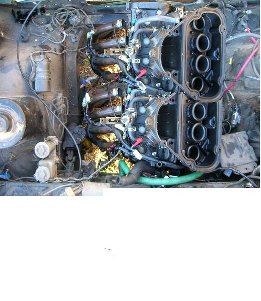

INDY510 Posted October 1, 2007 Author Report Share Posted October 1, 2007 2 motors would fit: Look at that.... 1200cc strait 8. Quote Link to comment
