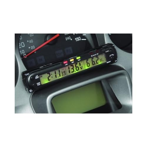

banzai510(hainz) Posted August 6, 2009 Report Posted August 6, 2009 you sure its the voltreg??????? not a choke relay nearby? but this will help buy this every body should run a volt meter of some kind so you can catch these thing. Dont rely only on the dash light. By then its already too LATE!!!!!!!!!! http://www.amazon.com/Equus-3721-Bat...ag=online0a-20 also upgrade to a solid state volt reg if you have a external volt reg. Quote
g-mam Posted August 7, 2009 Report Posted August 7, 2009 you sure its the voltreg??????? not a choke relay nearby? but this will help buy this every body should run a volt meter of some kind so you can catch these thing. Dont rely only on the dash light. By then its already too LATE!!!!!!!!!! http://www.amazon.com/Equus-3721-Bat...ag=online0a-20 also upgrade to a solid state volt reg if you have a external volt reg. I just ordered one of these, cheap, also gives me a clock, thermometer, etc. $27 at Amazon. Quote

banzai510(hainz) Posted August 8, 2009 Report Posted August 8, 2009 G man that a cool gizmo. Farmer Joe Have you cked the voltage? That would be a start. als clean the battery cables What di you unplug from the alternator. The red/wht wire or just the T connector. If you remove the T connector I usually dont notice a change either in my 521. I run a volt meter and I had good voltage. Bucket on here recently had a buzzing regulator and he swapped it and all is fine now. I assume it s mechanical type. But I have seen when you rev a motor up then the lights go out to be the brushes in the alternator. as there are barely touching, so ifyourev the shit out of it the slip rings will make contack. all can suggest is clean the cables or get new ones. Make sure the hood is not hitting the battery. put + side of battery toward the firewall. ck the volatge get a solid state volt reg(if external type) get ready to get a new or another alternator. Quote
